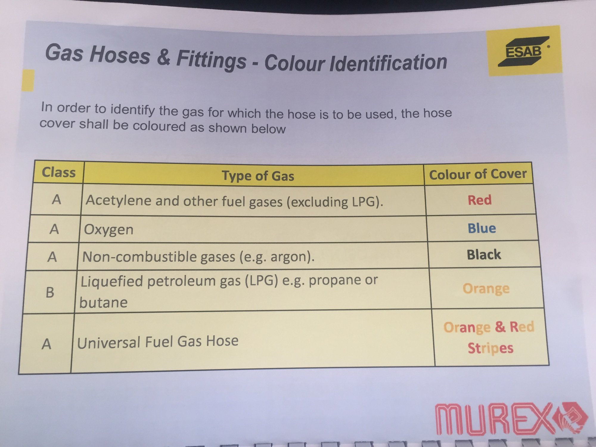

Couple of threads recently have alerted me to some of or rather the lack of information regarding oxy-fuel safety.
Gas hoses for Acetylene cannot be used for Propane and vice-versa!
The additional agents in bottles of acetylene and propane will degrade the incorrect type of hose.
There are Universal multi-fuel gas hoses available. One such brand is ESAB. Funily enough this image is from their literature that is handed out on the gas inspection course.
