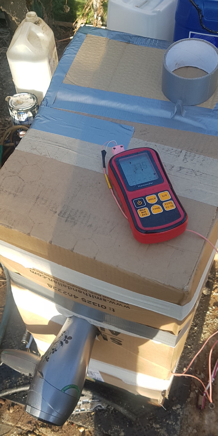

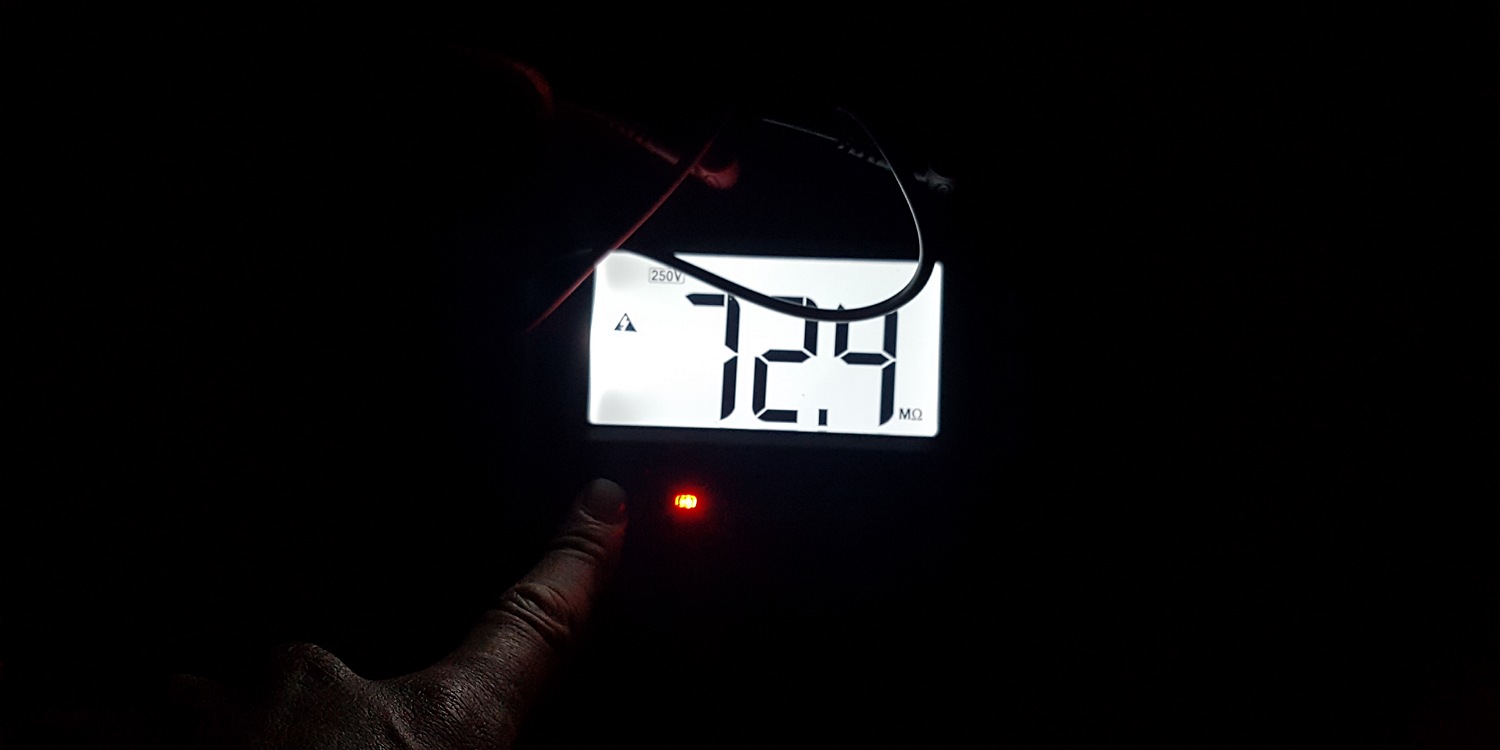

Using the cheapest insulation tester, I tested my good welder at 250v DC (I know should test at 500v and tester will do 500 and 1000v). I got 72M ohm:
Testing the sludge puppy machine gave a resistance of 0.0M ohm...
Going to use hot air method on the windings to dry them but Its looking like the acidity of the oil may have degraded the insulation.
