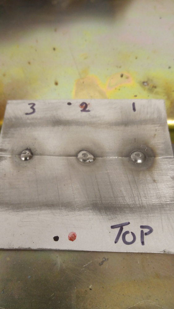

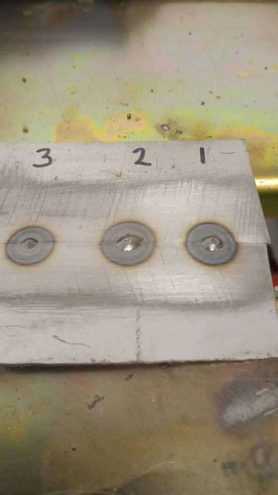

Been away a while and playing when life doesn't get in the way. The photos are on pieces of 0.9-1mm mild steel from the repair panels I'm using. Butt weld with 0.8mm wire. Spotwelds viewed from on top and behind. I believe I'm at about 60amps here depending on my stick out. How do you good folks feel about these? For me I have good even penetration and equal heat dispersion. About 6-7mm stick out. Matt
