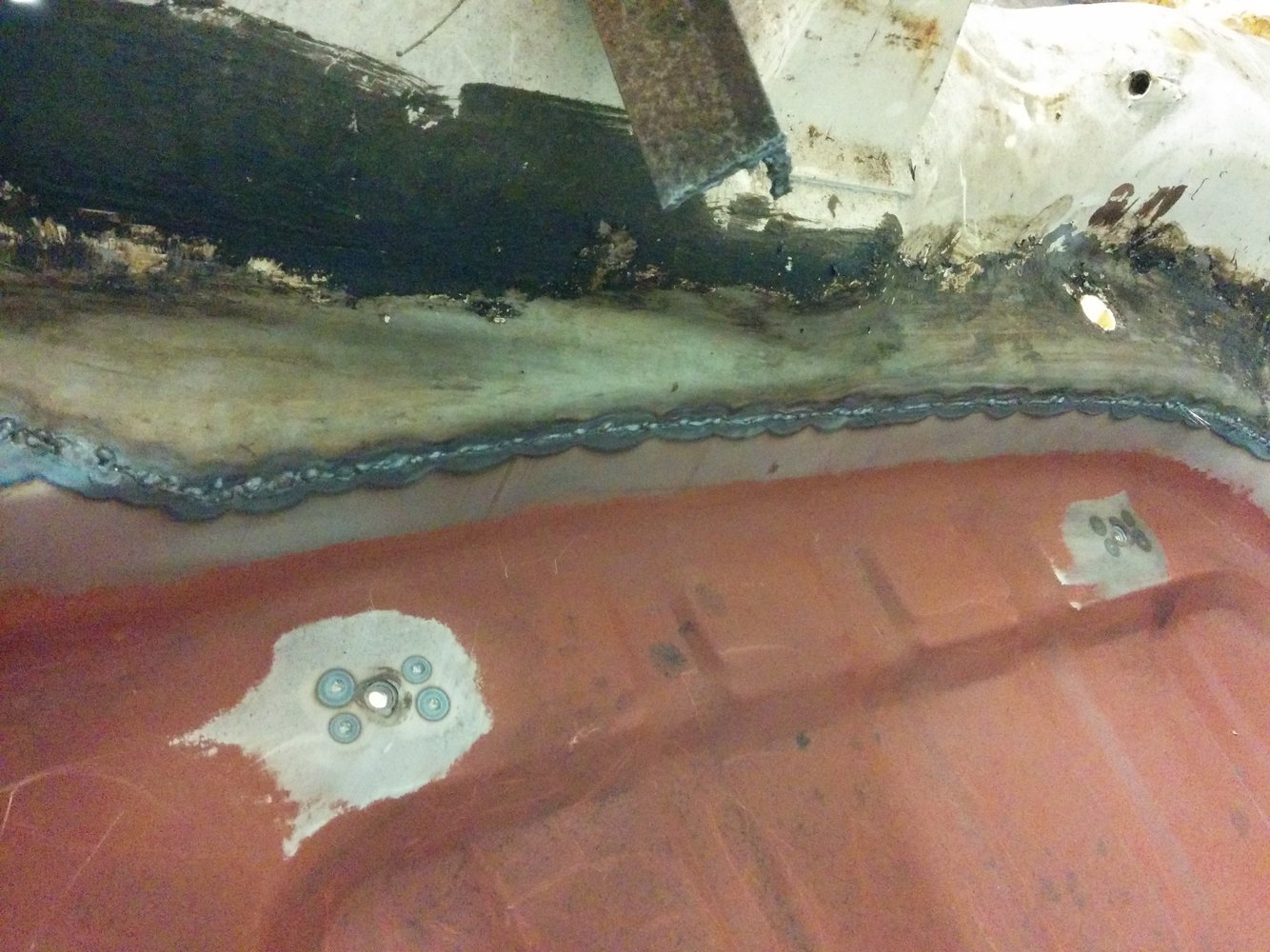

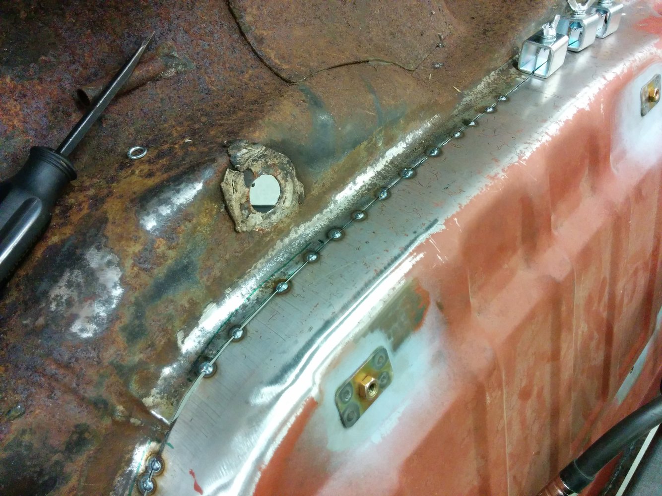

Afternoon all.
I'm presently starting body work on 80s car. .9mm mild steel. I'm using .6mm wire with my Oxford migmaker 200.
The sweet spot seems to be on a coarse setting 1, fine setting 5, wire setting 4-6, 6l/min, 95%/5% hobby weld gas.
I thought theses settings a bit high but going lower is definitely not the answer
Does anyone have any relevant experience in this regards Matt....
