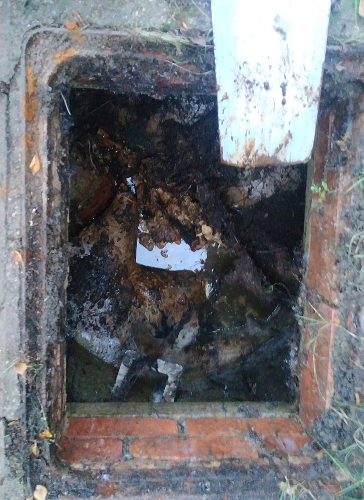

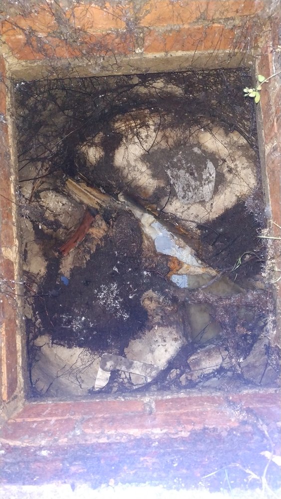

video would be betterAccess cover open, initially it looks quite discusting - lots of long black hair all the way up. Has someone tried to flush Rapunzel? But the two pipes frlm next door, the outlet and our kitchen pipe look clear. Ran the tap and flushed the downstairs loo. Took a good 30 seconds for it to bubble out of a mass of black sht and hair? I assume its hair.. cant be mine as my longest hairs are up my nose! The black mass was hiding our houses main outlet pipe from being visible. Im reasonably sure the pipes will be flowing free enough its just where it meets the access and turns 90 degrees.
Now thanks to @gaz1 's videos I think its an easy fix. A long stick to poke it free and a big bucket of water aimed at that mass should send it away, followed by a tons more water.
Also from the videos, more times than not, even the professionals manage to get a face full of poo when using the jet wash. No, could not pay me enough to use one on a drain!

The main sewer end is clear and flowing dry.video would be better

When I read this last night, its the thing of nightmares! Did not sleep I was watching tree root unblocking videos!you need to get someone in with a camera to stuck up/down the drain and have a look
then when you find where the drain is broken it needs digging out and fixing :-(
it'll be a broken drain leaking water which has attracted the roots

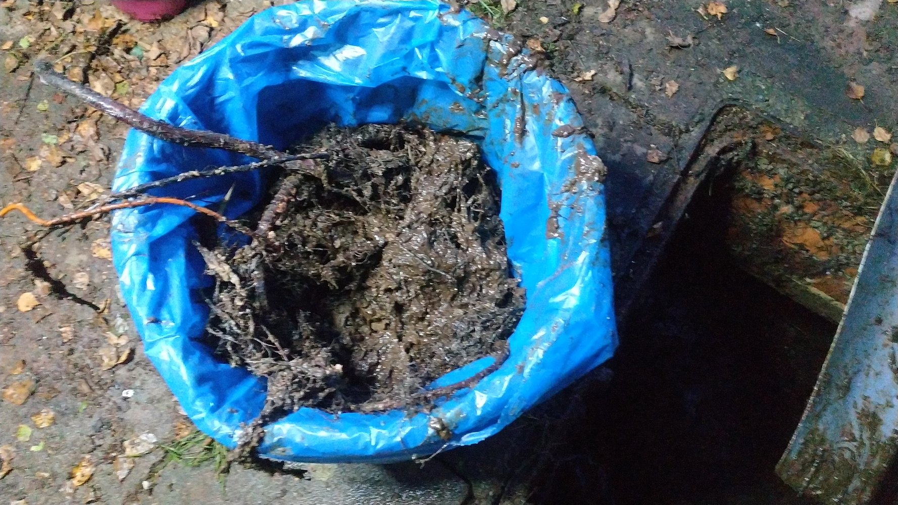

If that's from next doors bush, she needs a doctorIt was very difficult to scoop up the roots, used the branch lopper to pull it out and there was a big risk of it cutting and splashing back down! About 5 kg of turd roots, likely from next doors bush.
It was fully clear in June, so 6 months ago, quite sure its not roots as theres no significant trees between my house and the end house of the row.This has probably built up from last time you cleared it kram.

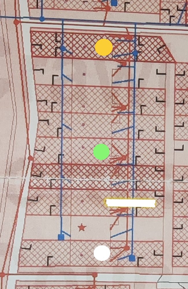

well this is wrong. absolutely wrong (unless the water undertakers rules are different in England to the rules in Wales)...beaware thats not always true
ive known the ones in a row to all foot the bill until it leaves the last propertys land and connects to the main drain
your responsible up to the join at the manhole, there responsible up to the manhole, your both responsible until it leaves your poperty
