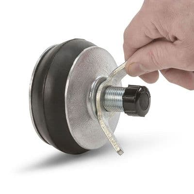

Most builders merchants stock them, basiclly 2 dished plates either side of a very large O ring, bolt with wing nut to tighten it expanding the O ring to seal the pipe. Work really well, but a pain if you're trying to fit one 3 foot down in an round access chamber - man hole to you.
Idea is to stop anything entering the 4" pipe you are working on, removing is more fun, cord around the end and gently tap the shaft so it tips and pull cord, trying to undo it usually gets you covered in crap.
