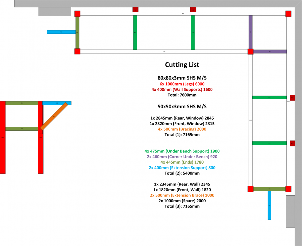

If you look int he lower corner, there appears to be wheels at one end. I'm guessing it slides out so you can lift the end and wheel it.?What does/did the handle on the left side of the vice bench do, if anything?
