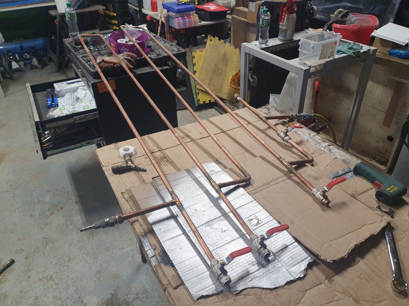

Hi guys
So i'm slowly getting ready to start paint my car...
My current compressor is an SIP TN3/50 i.e. 3 HP - 50 Litre - Direct Drive - 9.5 CFM Free Air Delivery.. I don't think it's a bad spec tbh given the extra bit of power (V motor) compared to similar ones.
I made one mistake.. I focused on the CFM value, but the 50 Litre capacity is a little low for spray painting I think.. My Devilbliss FLG-05 (LVLP) calls for about 9.5 CFM (Which I assume is FAD, as the displacement of the piston is immaterial to a gun, right?). My current compressor is 9.5.. would this be adequate or not because I thought I read something about losing some CFM in the hose?
Anyway.. I have some choices: (What would you do?)
1. Buy a new compressor - Unsure as to what to get, This SIP one looks good < https://www.iedepot.ie/sip-px3-200-air-compressor-clone/ >
2. Buy a pre-owned compressor - I've just come across this one. It's hard to know what CFM it is.. < https://www.donedeal.ie/tools-for-sale/fini-air-compressor/30660541 >
3. Buy a receiver tank only and plum it into my existing compressor - considering my unit is 3HP, this might not be a bad shout - I know I could drop another few quid on plumbing fittings - I can get a 200 Litre tank here for €357 EURO.. < https://compressedaircentre.com/product/210lt-horizontal-air-receiver-200-ls-2/ >
Two things I struggle with:
1. I see two guys near me paint with what I think are HVLP on 200 litre tanks with probably around only 10 CFM FAD... I can't see it being more than 10 CFM as they are single phase motors and not a tandem setup, which are required for more than 10 CFM FAD. Am I over thinking the CFM requirement and is tank capacity more important?
2. What figures effect the FAD CFM of a compressor, Is it not largely down to the size of the outlet from the receiver tank to the hose/tool. I mean, if I add another tank to my TN3/50, while, sure I get 250 litre capacity, will the CFM still be 9.5 FAD or what? Can you increase the FAD by using higher flow fittings..?
As an aside, I finished my air dryer/cooler the other day - one of the connections was leaking but I think that was my fault.. I need to mount it now and start running some air through it to see how much moisture it draws.
