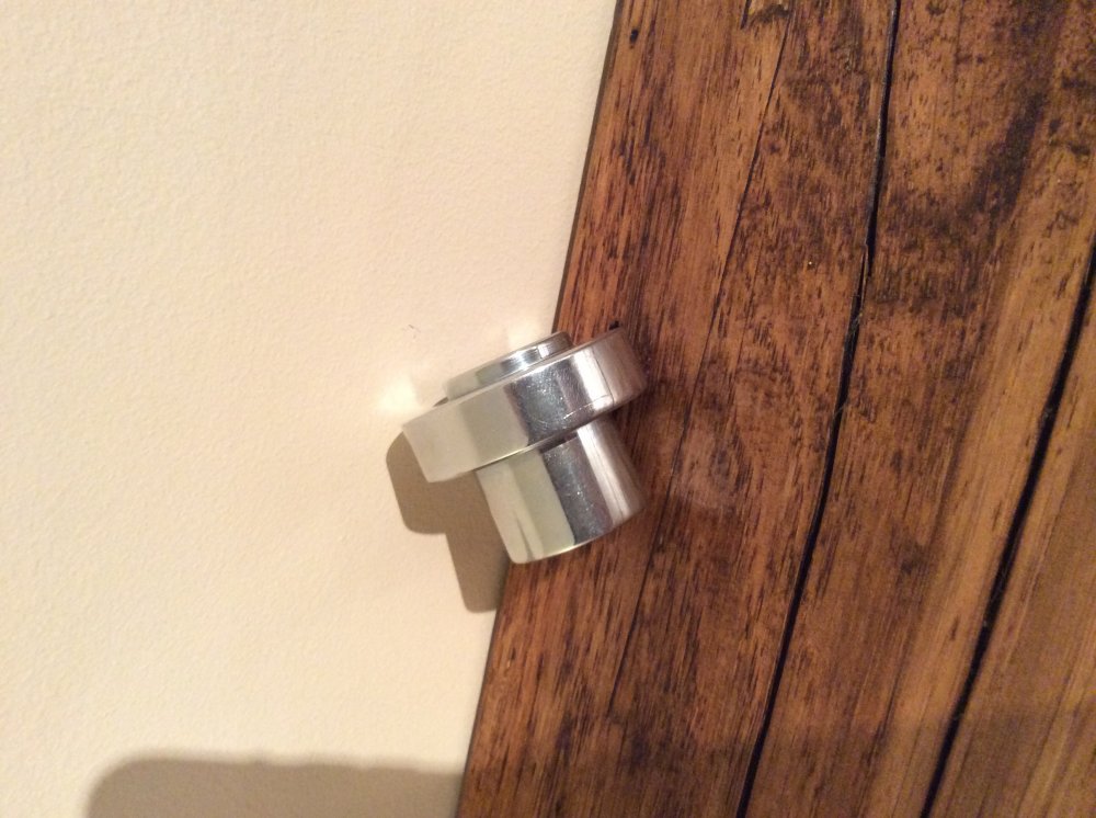

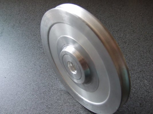

Final piece from the action shot earlier. Its a slider slider clutch for my z1 based dragbike. Material is 7075-t4.

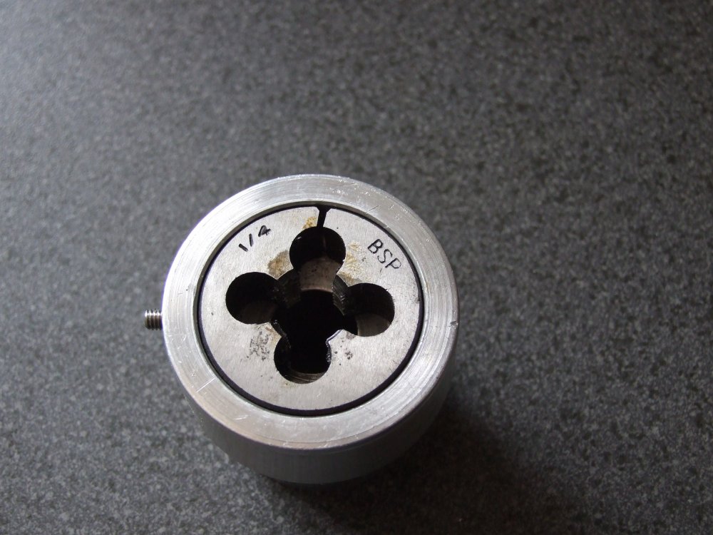

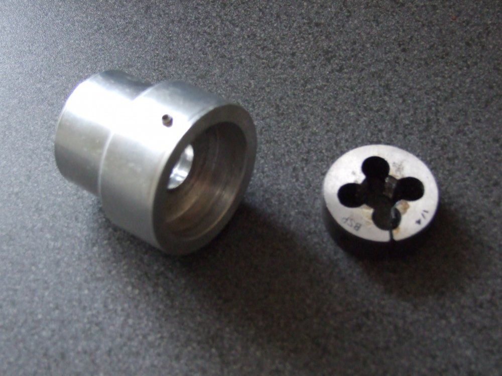

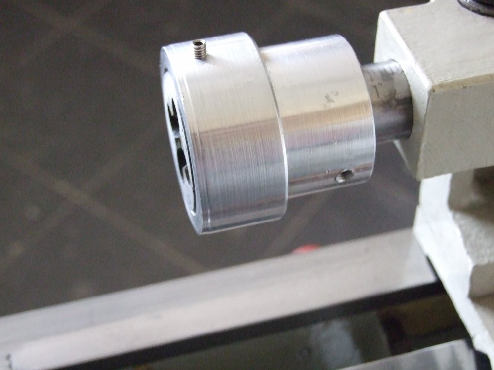

Posted some bits n bobs on here :-
http://www.mig-welding.co.uk/forum/threads/wobble-broach.38925/
http://www.mig-welding.co.uk/forum/threads/hydraulic-press-chuck.38888/
http://www.mig-welding.co.uk/forum/threads/jukebox-dinker.40319/
Will stop now before people glaze over![]()
