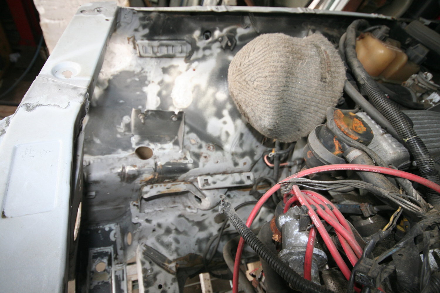

The below was done on the inner guard of a very rusty Alfa and didn't take that long.
The trick is get it close by whatever method you can (grinding, wire brush, sanding etc) and then give it a final going over with the spot blaster which gives you an ideal surface for primer.

Yeah, I've been working over the under arch areas again today, decided to just use my 81% phosphoric neat this time, soaked a sponge in some and dabbed it on over the area, gave it 5 mins, dabbed more on, then worked over the pitting with scotchbrite pad and a small fine hand wire brush. After a couple of sessions of this, all the pitting rust is out and it's all bright silver and utterly rust free. Wiped everything off whilst still wet, followed by a final light wipe on/off with very dilute phosphoric acid and let it dry for 1/2 an hour.Rust converters would be pointless for the issues on this camper, using a proper acid the rust can be totally removed without too much bother and the repair will then be as good as new rather than sticking plaster.

Thanks for this. Interesting recommendation.I find that using phosphoric acid at high strength is counter productive, it is quite oily at high strength and is not as effective as you would expect. I used 30% for rust removal and 12% for the wash. Wipe very dry using clean paper wipes, allow to flash off the last of the moisture and scuff up ready for paint.
I find that after a 12% wash bare steel can sit for weeks without flash rust. I really should do a test piece to see how long it will last.Thanks for this. Interesting recommendation.
I have been looking at options for an upcoming resto that has a lot of surface rust and im always trying to improve my methods. Would a 12% phos wash still be enough to compromise the adhesion of the lechlar epoxy do you think? I want to find a way to stop the flash rust after surface prep and a weak phos wash may be perfect for that.
