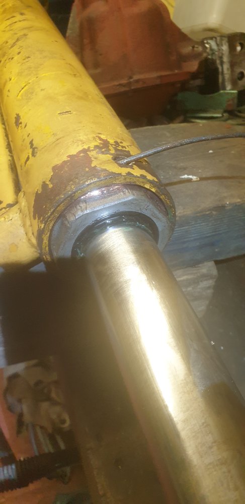

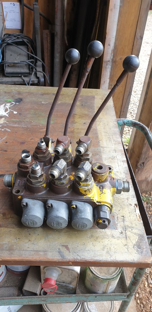

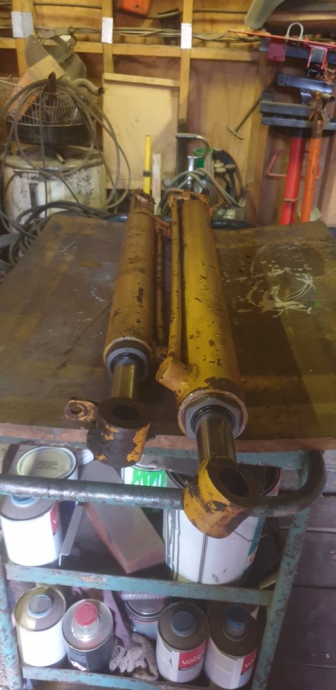

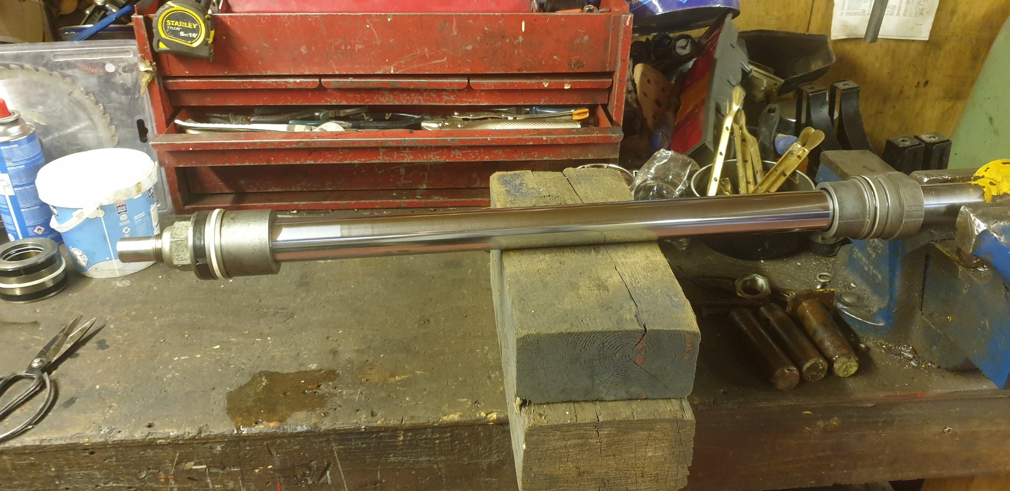

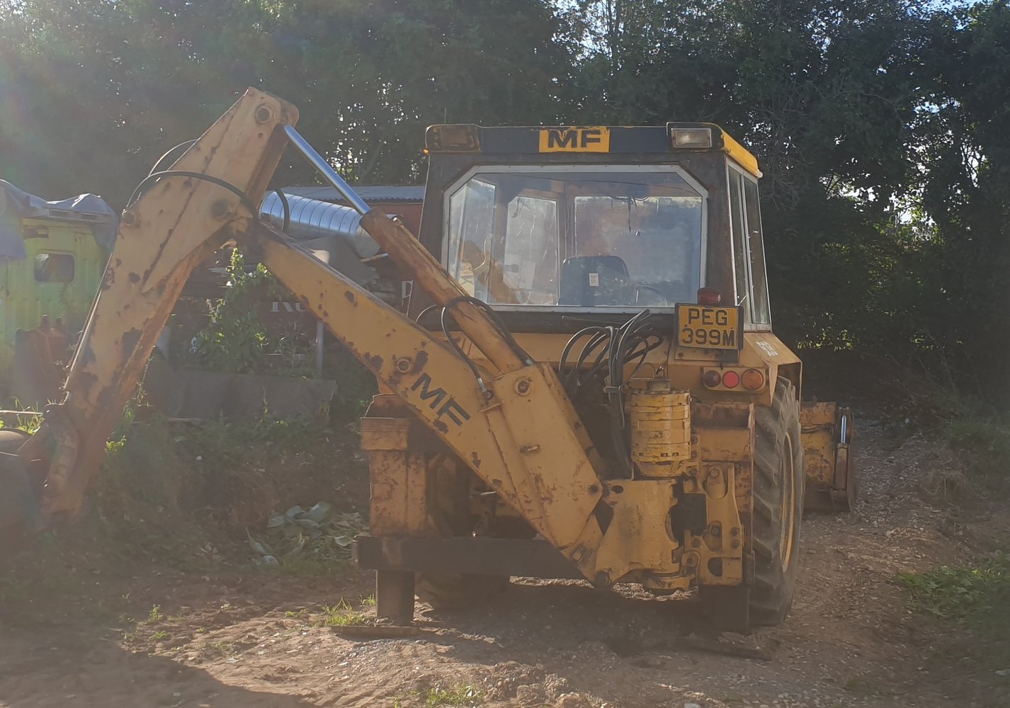

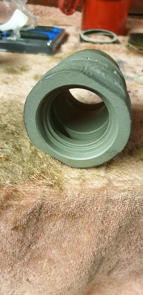

Popped of to pick up the selas as soon as I walked up to the counter and the guy said did you want ywo sets I knem there was gona be a problem, the guy had only odered the lift ram seal and not the tilt ram seals, no biggy just frustrating lucky they are close. I didnt start putting them in yet been to busy with other thing.

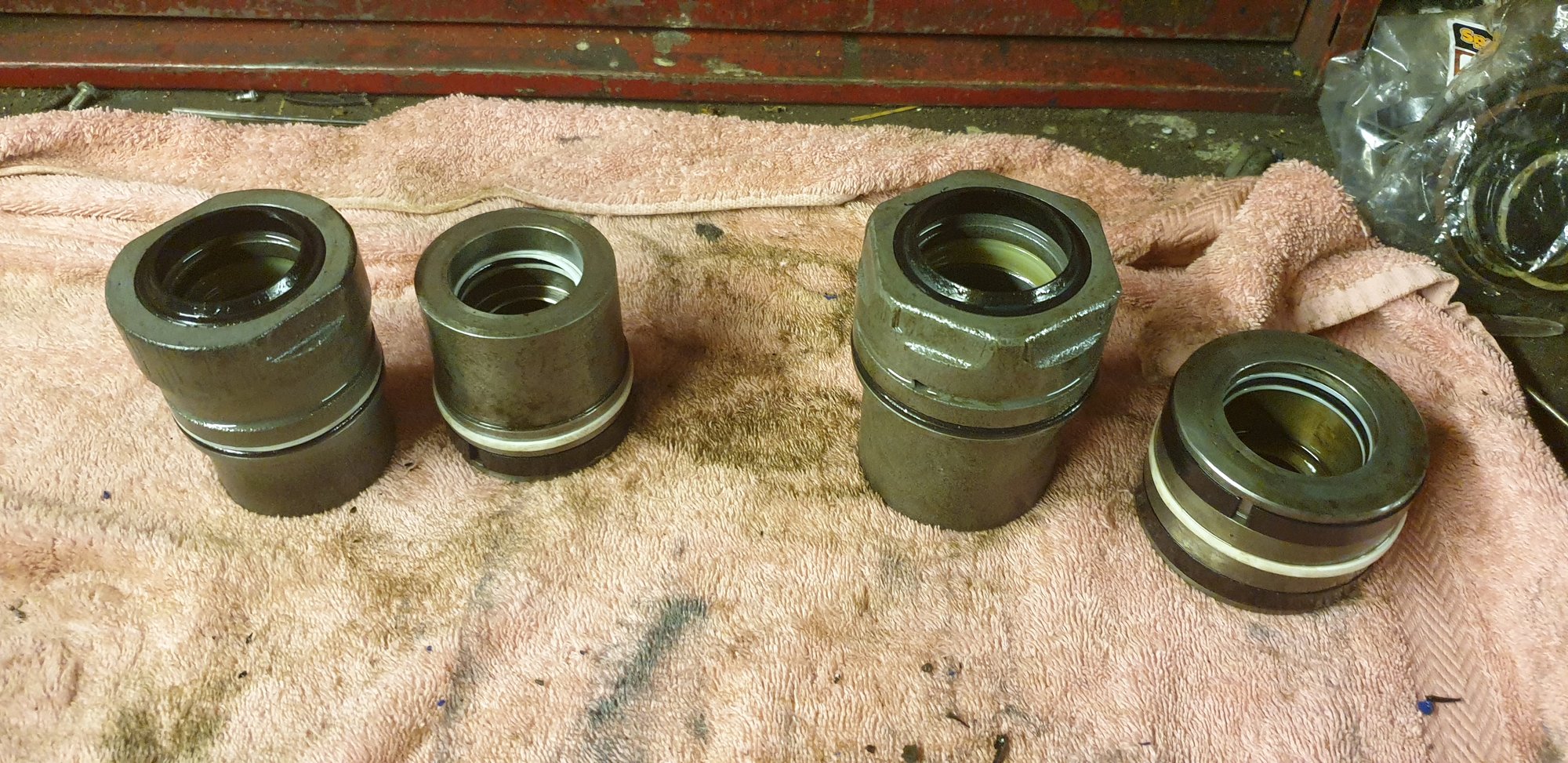

Someone did say to heat the new seals in hot oil before trying to fit them, is this right or are they jerking my chain,
as for those that didnt know,
Soaking the seal in any hot lubricant will really help. Doing so will soften the seal compound and improve their elasticity.

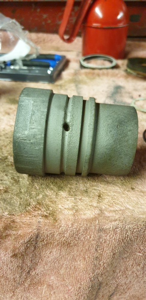

Overall it has not been a bad day all in all. Had a phone call to say the bucket tilt seal was in so popped over and pick it up. And set about getting them fitted, I gave the glands a bit of a clean first with a little ally blast, and the o-ring pic set is brilliant.

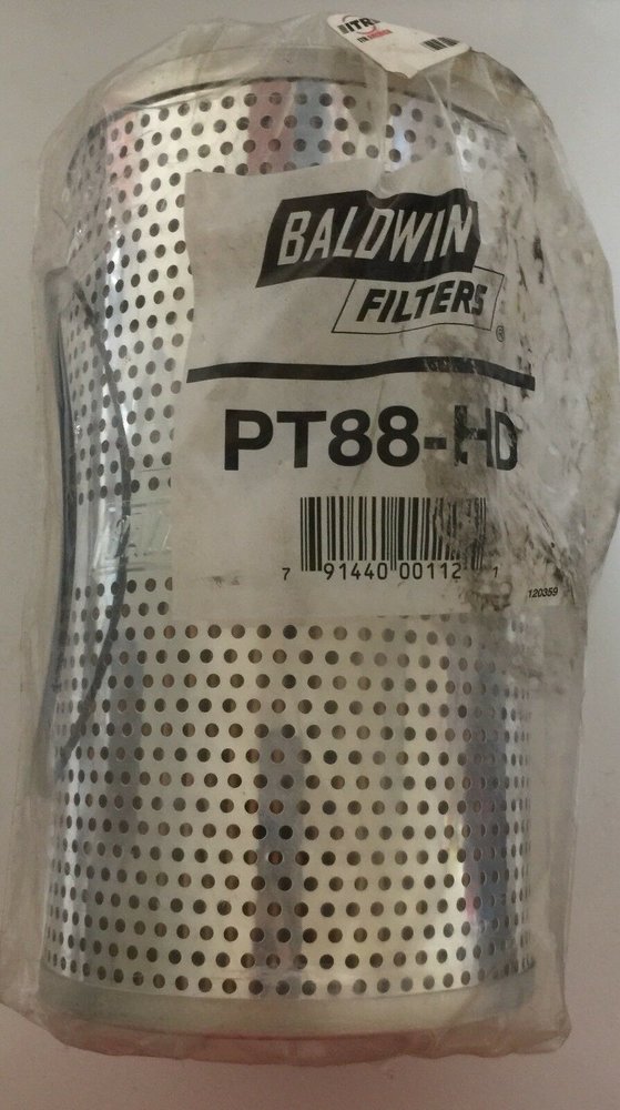

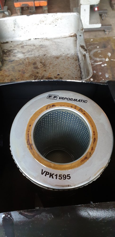

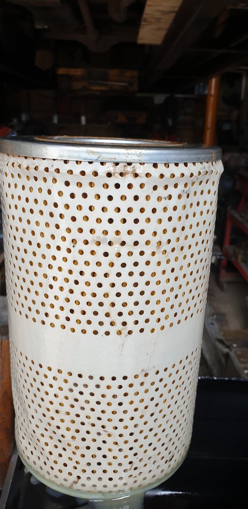

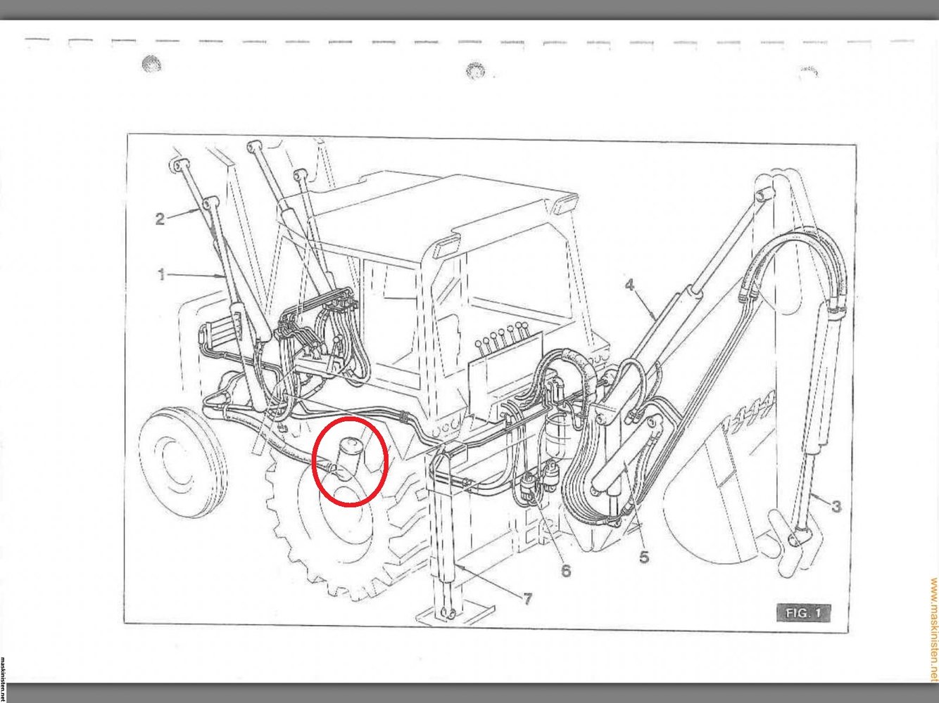

so today I decided to strip out the filter housing and see if there was another filter where the oil come into the housing before the oil gets sucked through the filter. I drained the oil again and went to remove the large paper filter from the housing or resevoir only to find the filter had started to implode on closer inspection the inner veins of the filter were all out of shape as if they've been in a vacuum.
