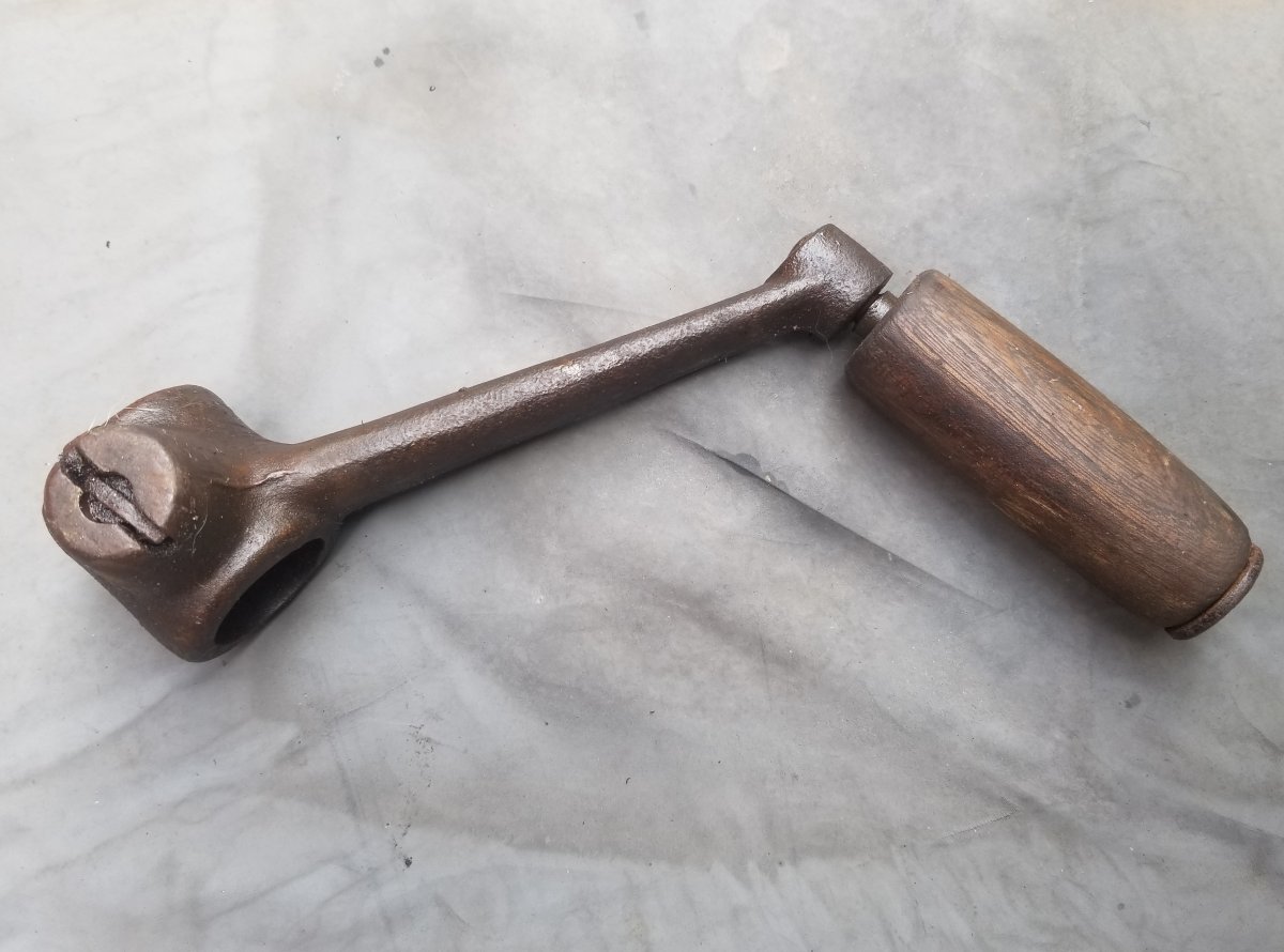

They've got a single-tooth ratchet that prevents that, but not uncommon for that tooth to be grimed in place and any ratchet action is non-functional.I don't think it happens with the twin cylinder one's but the single cylinder will sometimes kick back when starting and run backwards. That means the crank handle is being driven at 1500rpm until it flies off the shaft. Time to run when it happens.
If the engine starts backwards that ratchet is being drivenThey've got a single-tooth ratchet that prevents that, but not uncommon for that tooth to be grimed in place and any ratchet action is non-functional.
You're right!Lister introduced an "anti-kickback starting mechanism" for the hand start - an option to meet CE Certification for sale/use in the EU...... but that was on the T Series motors and I think sometime after Yr 2000.They've got a single-tooth ratchet that prevents that, but not uncommon for that tooth to be grimed in place and any ratchet action is non-functional.
