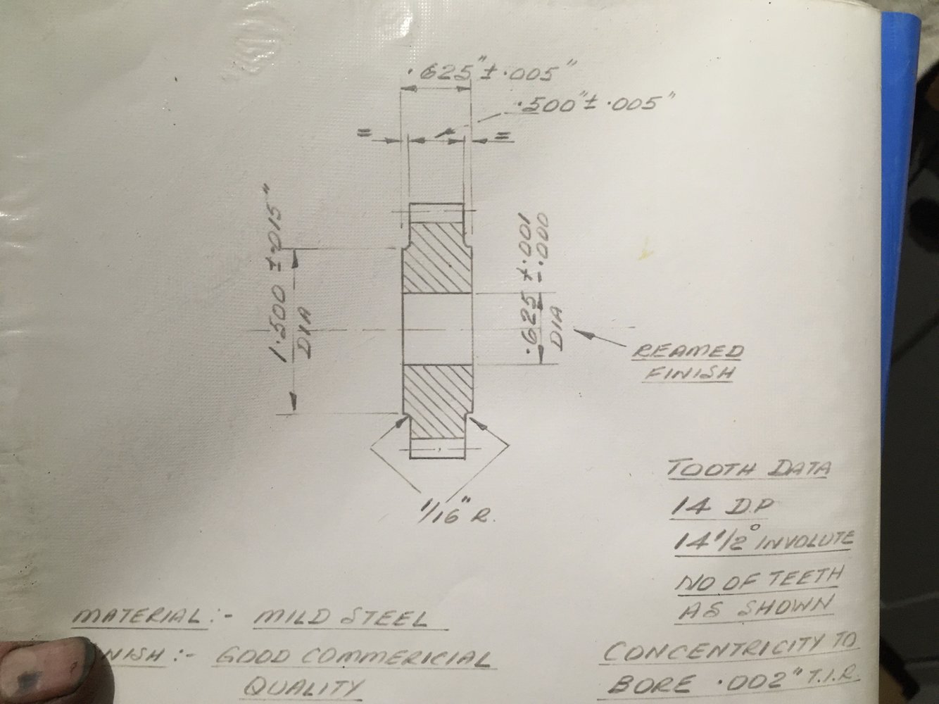

Mate of mine has just bought a very old Myford lathe.
Needs some change gears. In particular a 73T one. All we can find online have an internal keyway. His are the older pinned type.
Any ideas where he can find one?
I could 3d print if I knew all the details.
