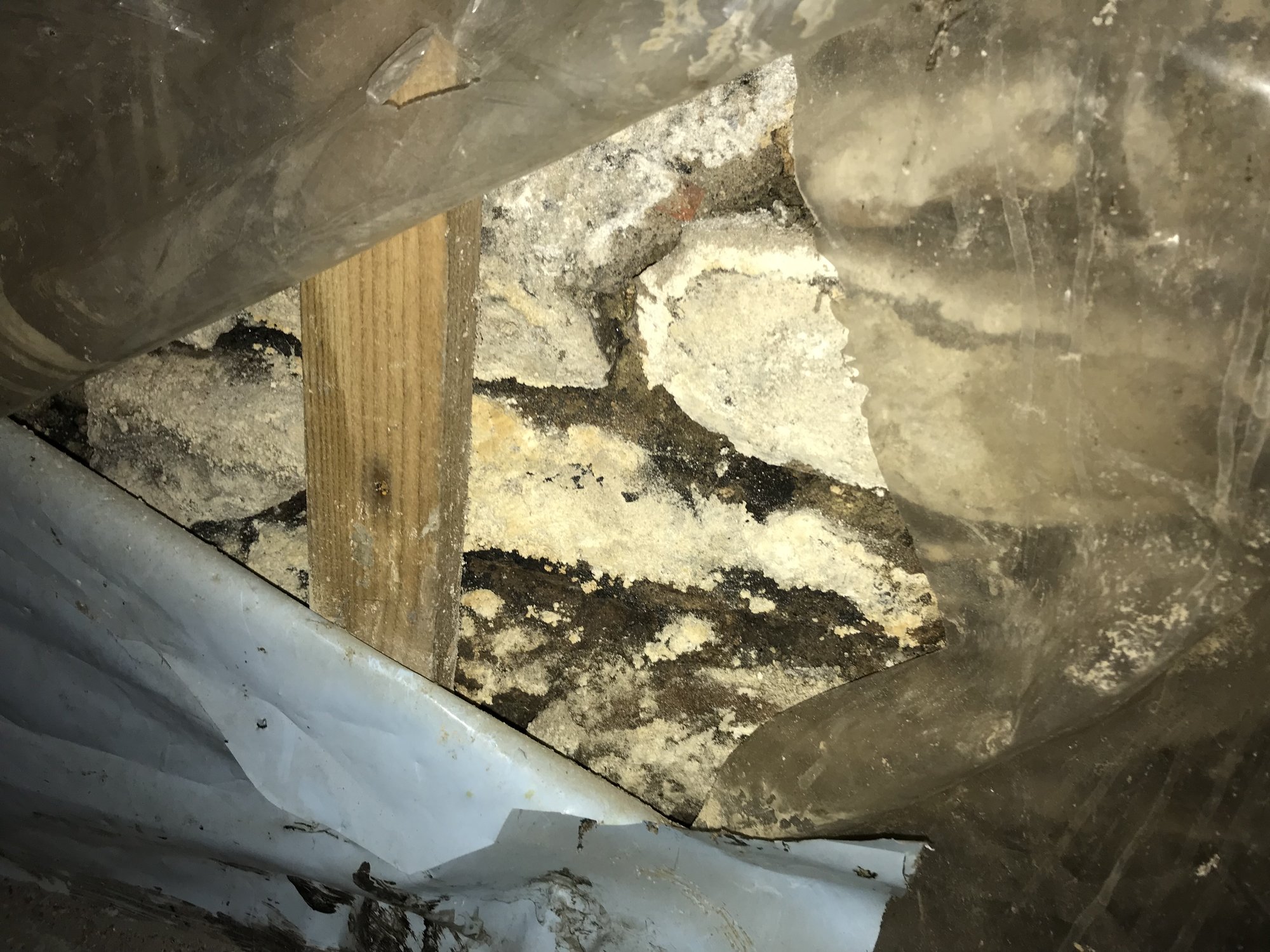

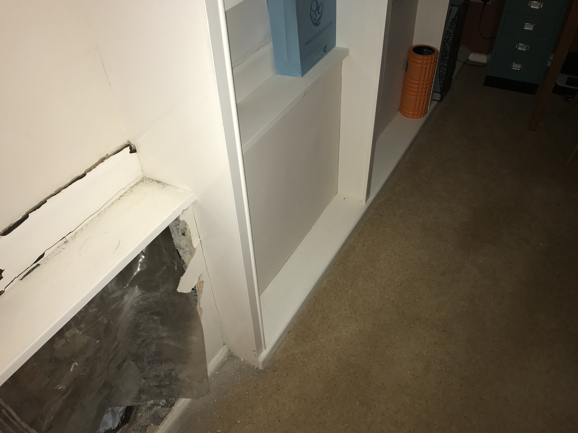

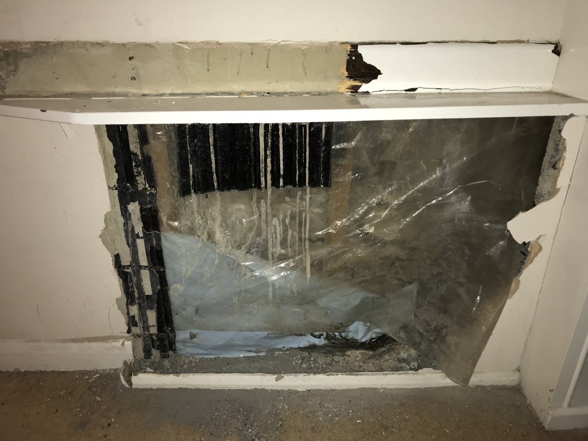

In the process of renovating an old flint cottage dating back to circa 1700s. There’s evidence of damp in a few places (mostly where the outside ground level is higher than the inside floor level). Got a ‘damp specialist’ to survey the place and he’s basically recommending to inject all the walls with damp proofing silicone stuff and then tank the walls that are below ground level. To the tune of £4.6k

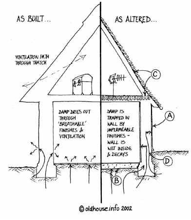

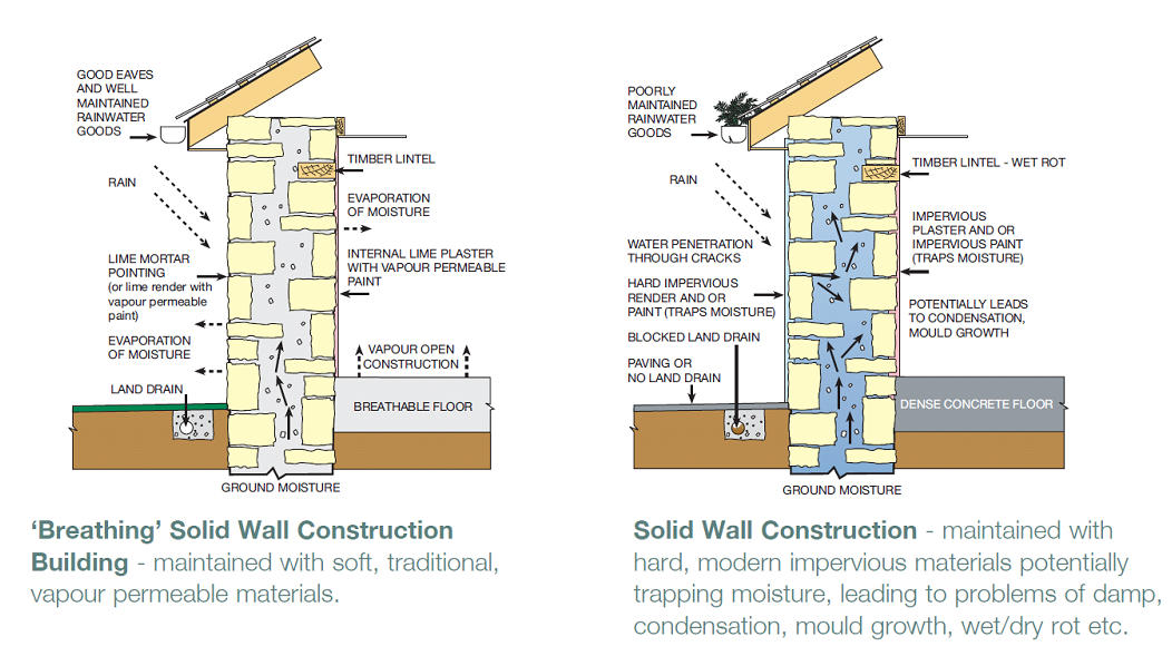

I was under the impression that any injection stuff was useless for flint walls and for older places you should focus on breathability rather than making things water tight?
Anyone got any experience with this?
