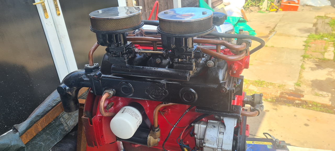

I have a set of +20 pistons already.
It kames me wonder then if these machine shops actually look at specs of the engines before reboring. some can only be bored so much. need to look at specs of the engine by name and codes to check them. tis is it to em, folk who just bore out wat ever with out even looking at specs.
I've had a few things done at Quasar Engineering in Stockport, just near Portwood roundabout (M60 J27) on Mersey St. Quite a old school place, no website so you'll need to ring them, but I've always found them decent.
Where are you getting pistons from if you're doing a rebore?
To them its just another Volvo engine block, they wouldn't know or care what was bolted onto it to marinise it.
Bob
Also getting half a thou of taper per bore like this, they then hone it and all looks pretty, the cutter should be reset or at least checked on every bore. I have witnessed this on more than one occasion which is why I ended up buying my own boring bar and delapena hone. Sounds like small numbers but its enough to cause a seizure or picking up/scuffing of a piston, the half a thou bore taper can be honed out but again they dont bother.There were only three engineering shops locally that did this sort of work and I wouldn't let any of them loose with a lawnmower engine, same with the crank grinding.If they are not working with competition engines give them a miss.
