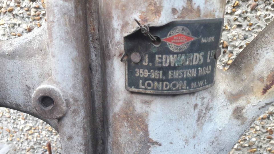

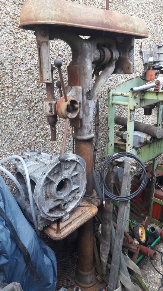

Doesn't look very American to me.F J Edwards is better known for its sheet metal machines. They would have been the importer or agent. Likely to be US-manufactured.
I was wondering who actually made it i was expecting it to ba cast somewhere but cant see in picturesLooks like a Denbigh drill. "The Denbigh" will be in the casting on the wall side, if it is.
it must be pre ww2 i guessDoesn't look very American to me.
Plenty of old British drills like that.
Yup. I think so.Is the. “F” obscured by the drive screw?
Definitely!it must be pre ww2 i guess
Ok will look at that then, if theres too much play in everything then i might be put off but most can be sorted I guessI am surprised they are not more common, at one point it was about the only make of pillar drill I had seen.
All three[2 pillars & 1 bench] that I had, had the same problem, the spindle is driven by a sliding key, look at the top
of the pulley to see it. The keyways in the spindles were badly worn, I ended up with a grinder precision[9" grinder] widening the
key way. I made a new key for the new wide keyway and didn't have any more problems.
I would have put it post war, if you told me they made them like that right up to the 60's I wouldn't be surprised.
