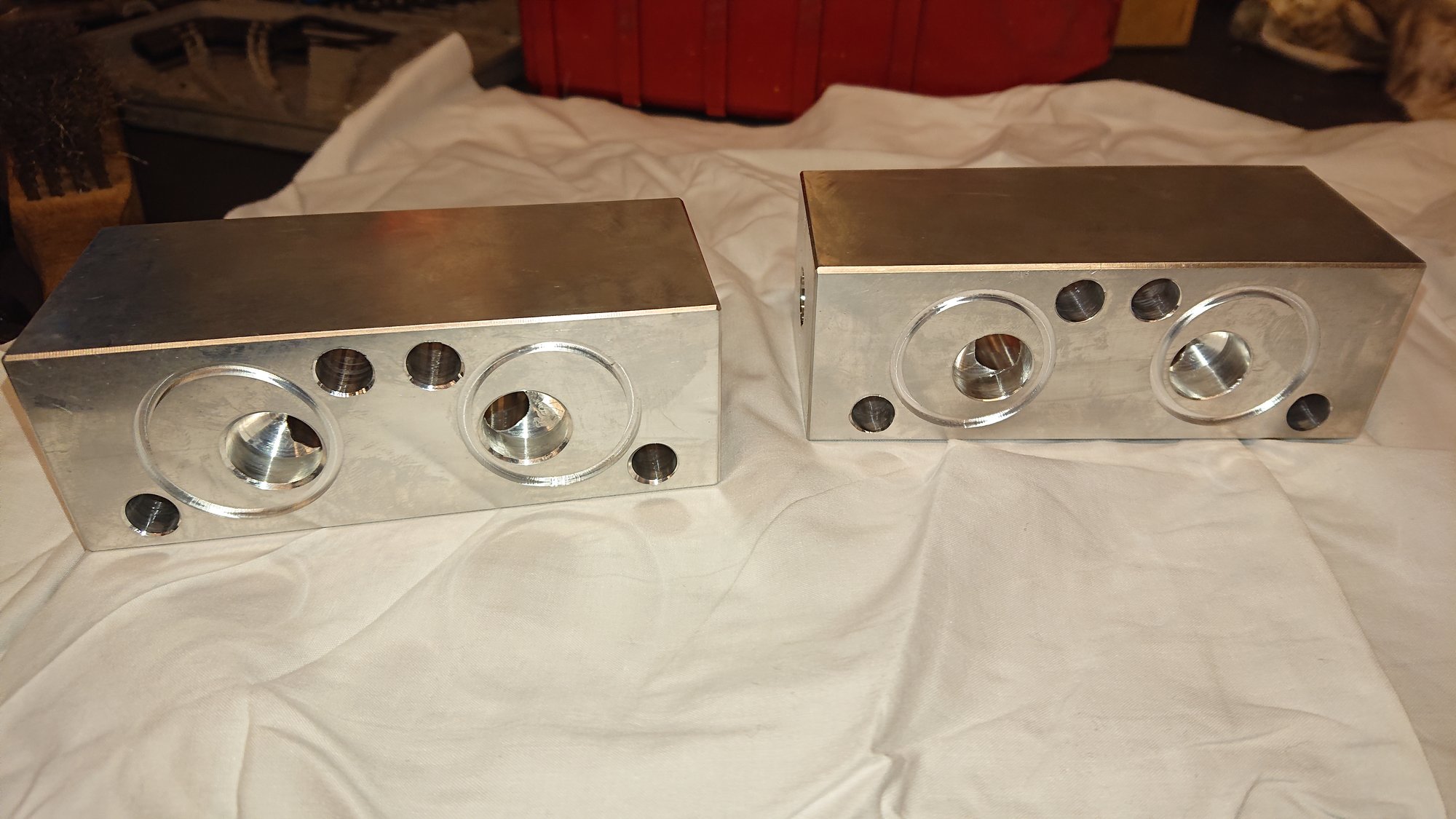

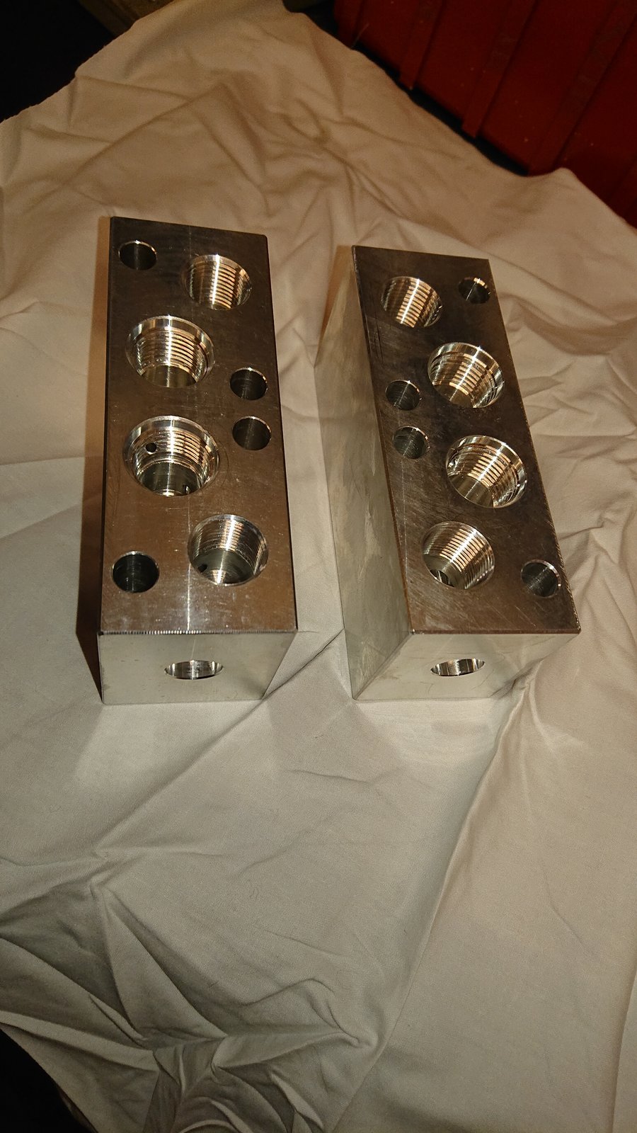

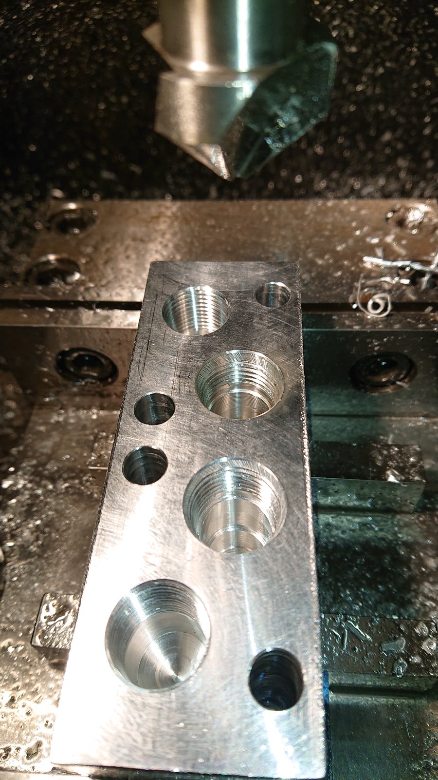

Yes they are aluminium, they always were. The original one's are aluminium too.Looks like the sealing surfaces came out with a good finnish. Is it aluminium now?
If you assemble the manifolds soak the cartridges in oil before putting them in. Remove them once and check seals before final assembly.
Yeh they were pretty rough, I thought they had been dragged out of the sea. It turns out they are off a Powerfab mini digger.Thought the original ones were cast iron from the looks![]()
Often see the likes of that on the boats, water(especially salt), aluminium and steel do not mix well, especially for the aluminiumYeh they were pretty rough, I thought they had been dragged out of the sea. It turns out they are off a Powerfab mini digger.
