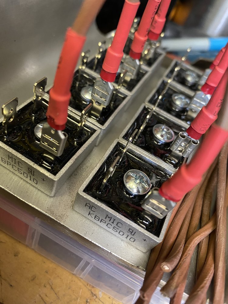

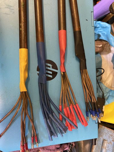

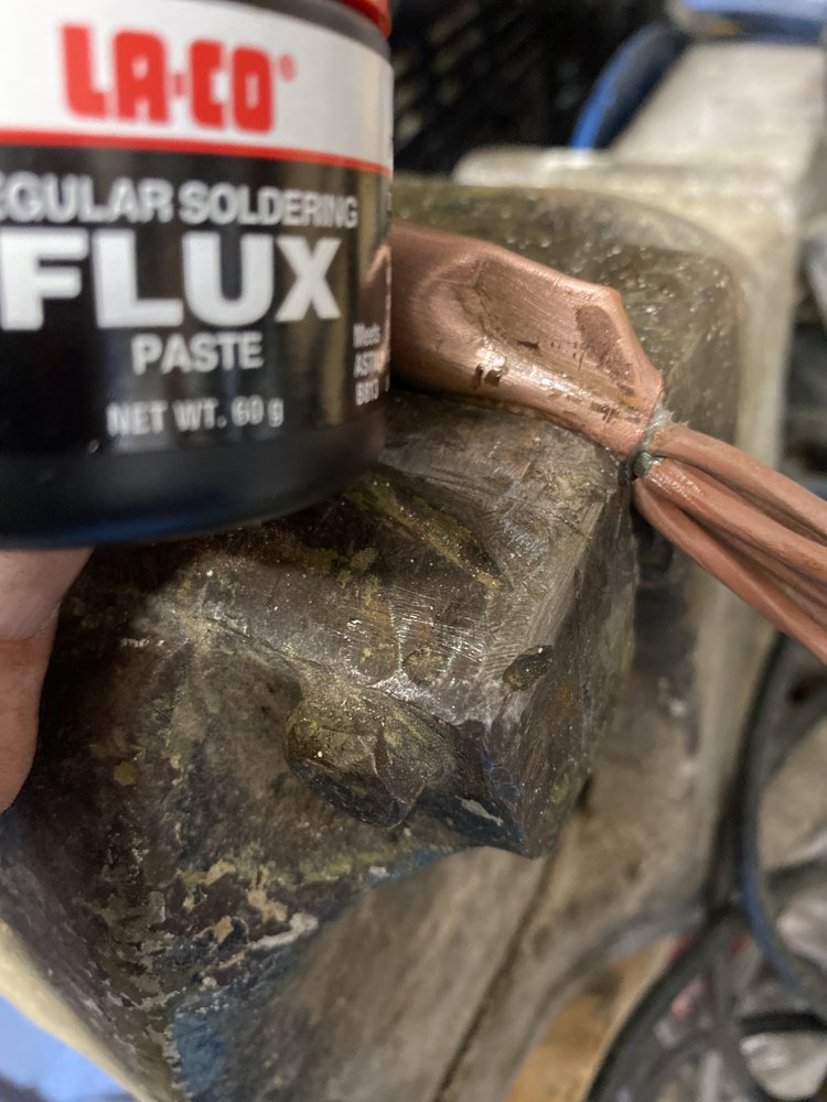

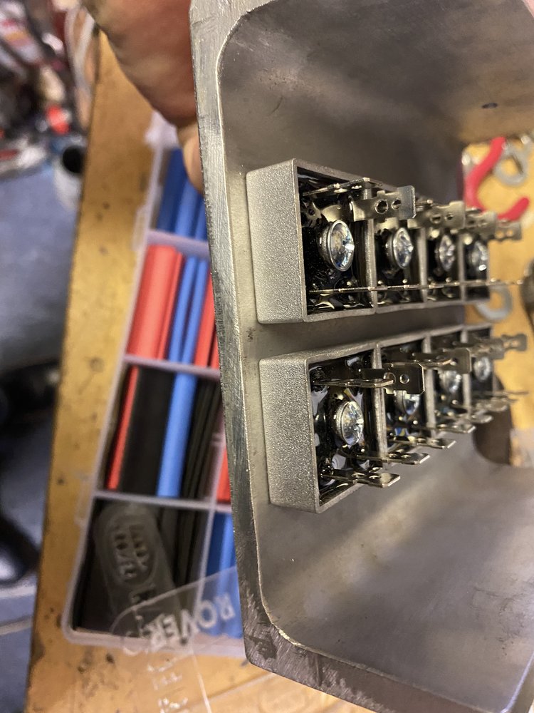

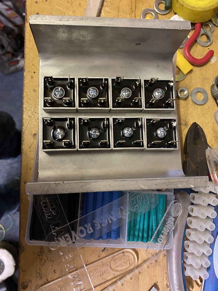

I have made the heatsink from 5" aluminium channel section, 8mm thick. I then marked, drilled and tapped the channel and bolted each diode to the channel. And that's as far as I got!All the bridge rectifier blocks should be mounted as close together as possible, on a heatsink thick enough to ensure that they are all at the same temperature.

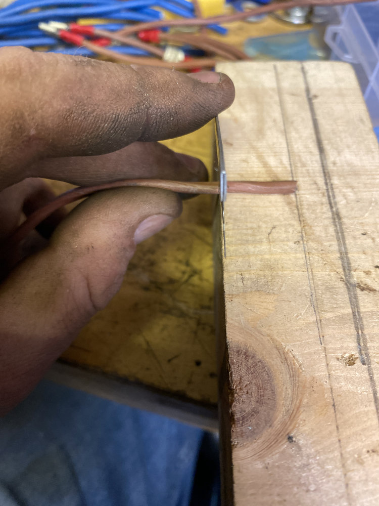

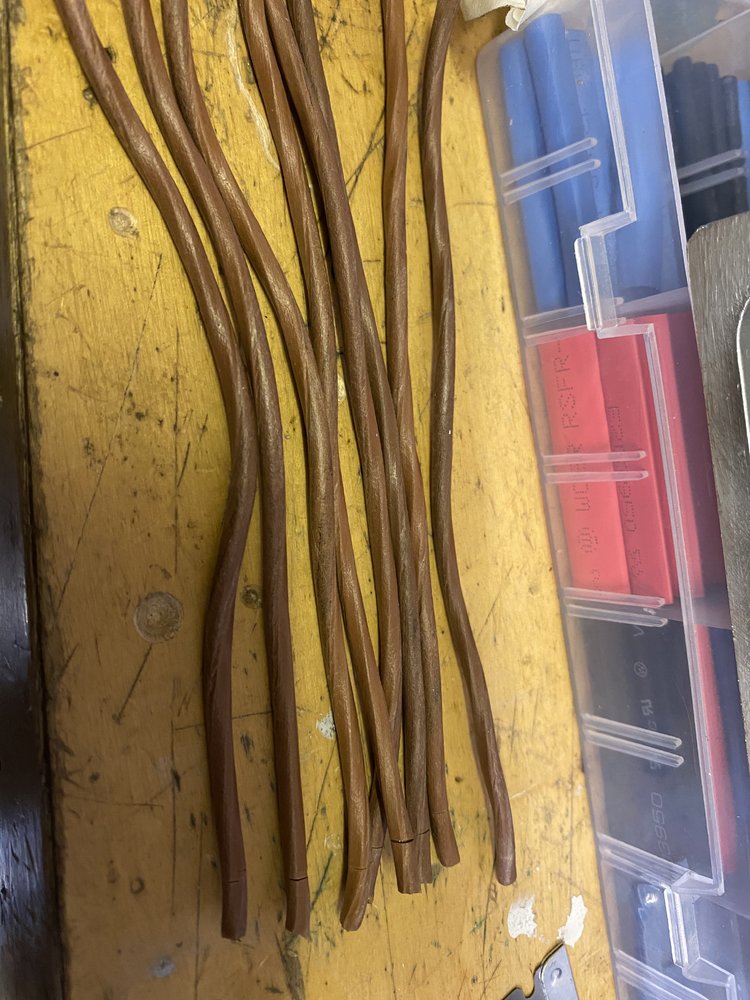

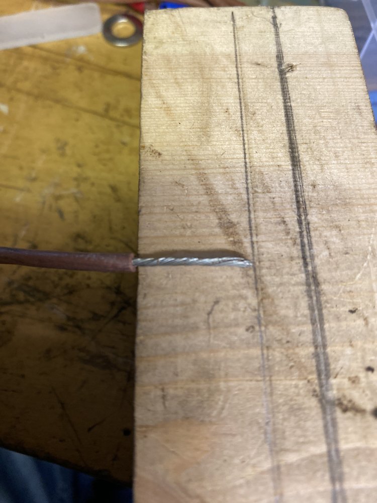

As long as they are adequately-sized for the expected current ( 5mm2 would be fine ), the leads do not have to be especially short, some resistance helps with current balancing. However, all the wires must be exactly the same length, so for 8 blocks you need to cut 32 identical pieces of wire.

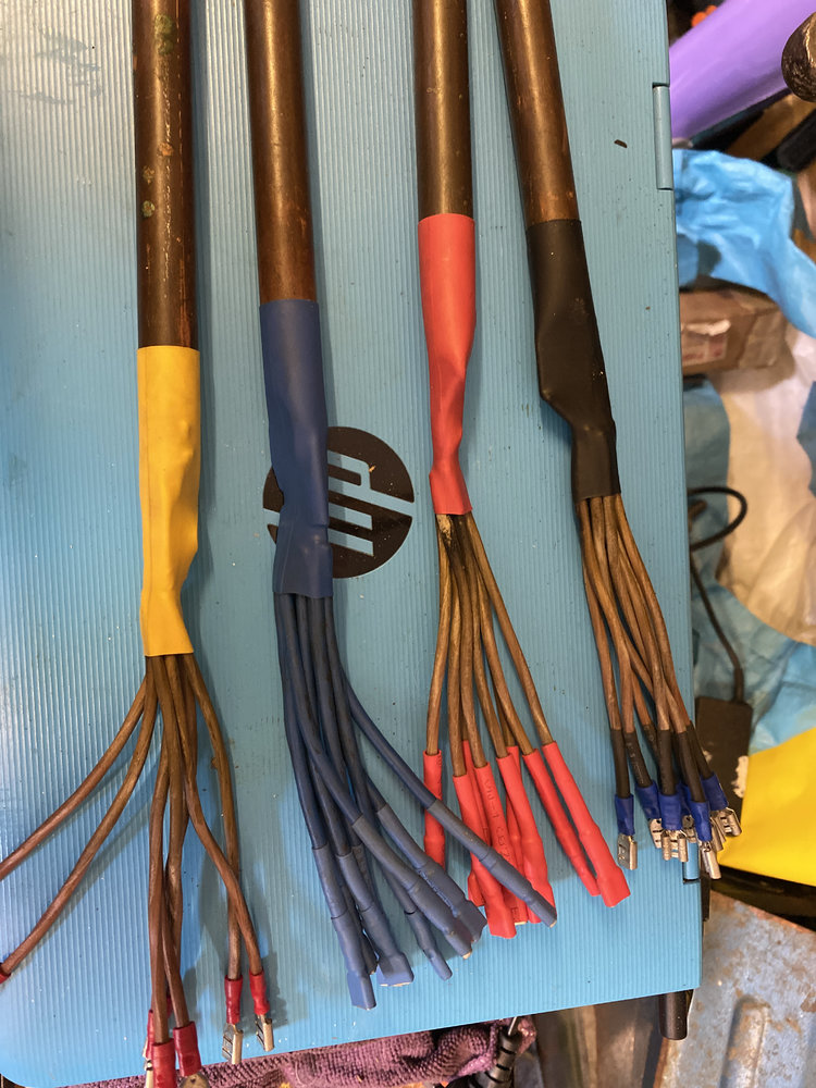

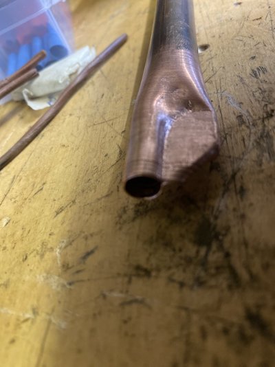

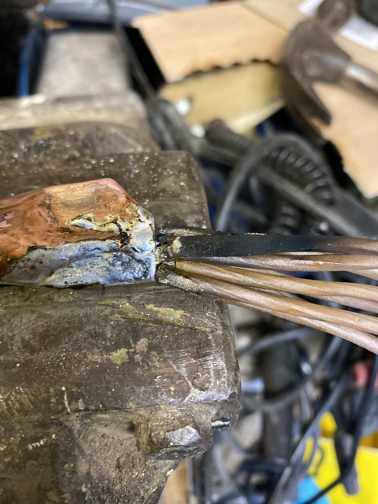

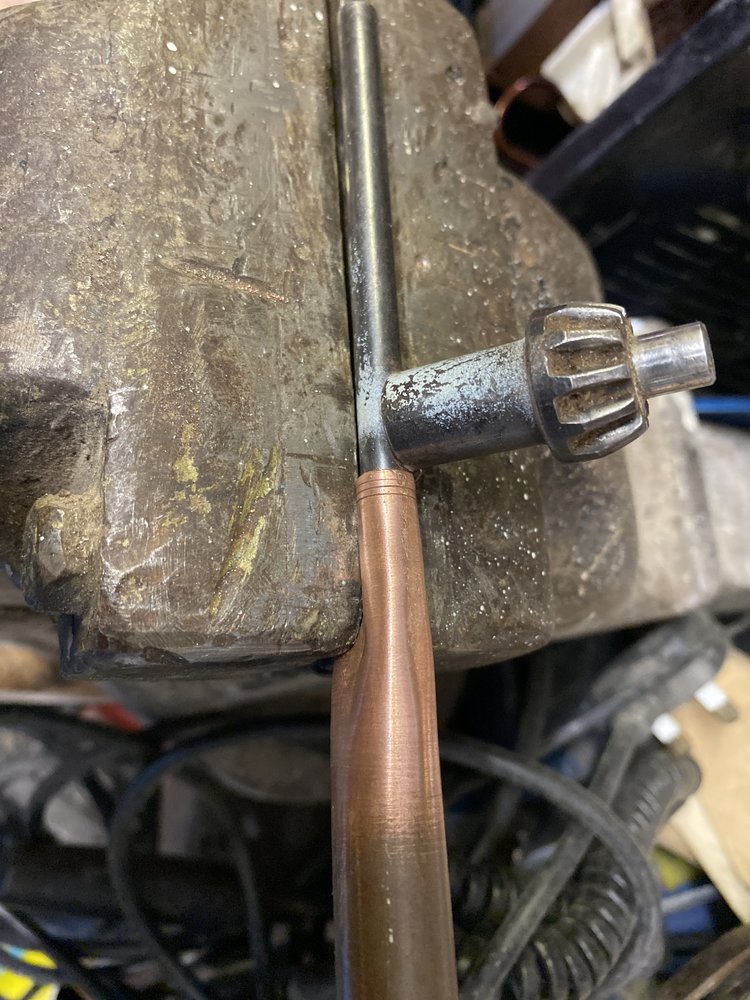

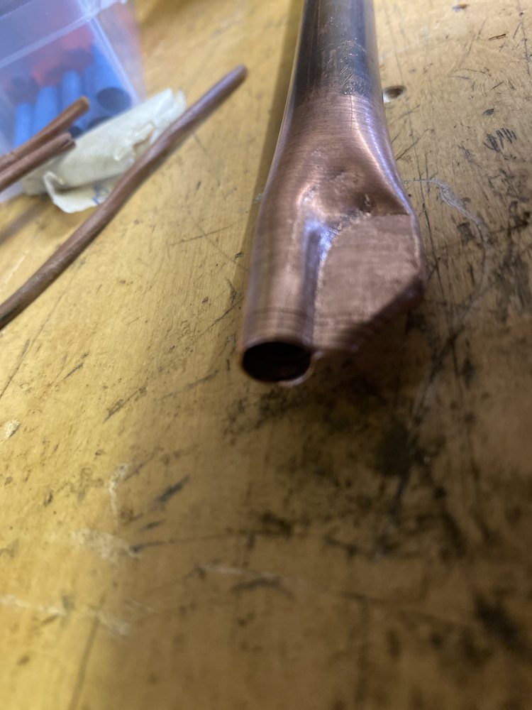

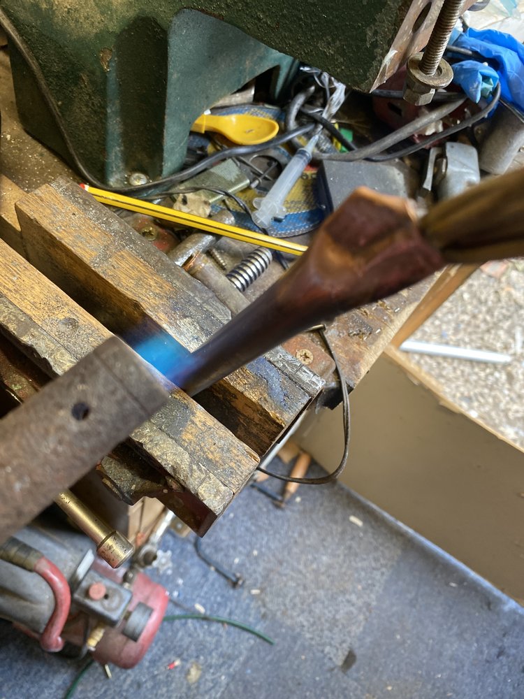

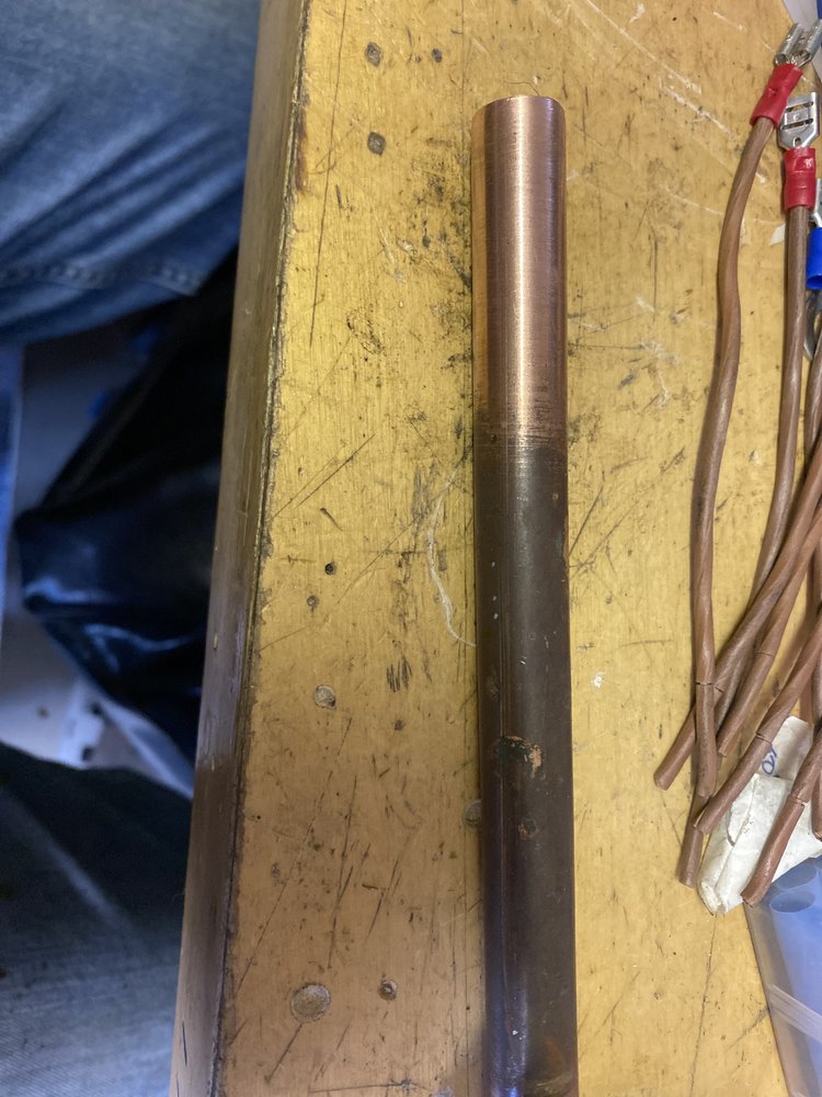

One end of each group of 8 wires needs to be crimped and soldered to a common point - which can be flattened copper pipe. There will be four of these common points. If you have tight and well-crimped spade tags, they can be used to join to the rectifier tags. Otherwise, a fast soldered joint with a large temperature-controlled iron is preferable.

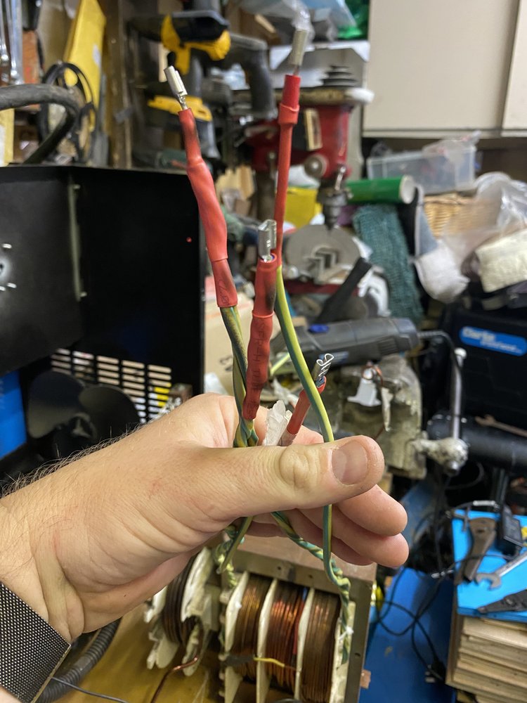

This looks brilliant - going to have ago myself -Few pics for ya'll. Please excuse the mess
View attachment 297654 View attachment 297656 View attachment 297657
More pics tomorrow as things progress

You're right.......... I'll put some more in!All those rectifiers for that diddly transformer![]()

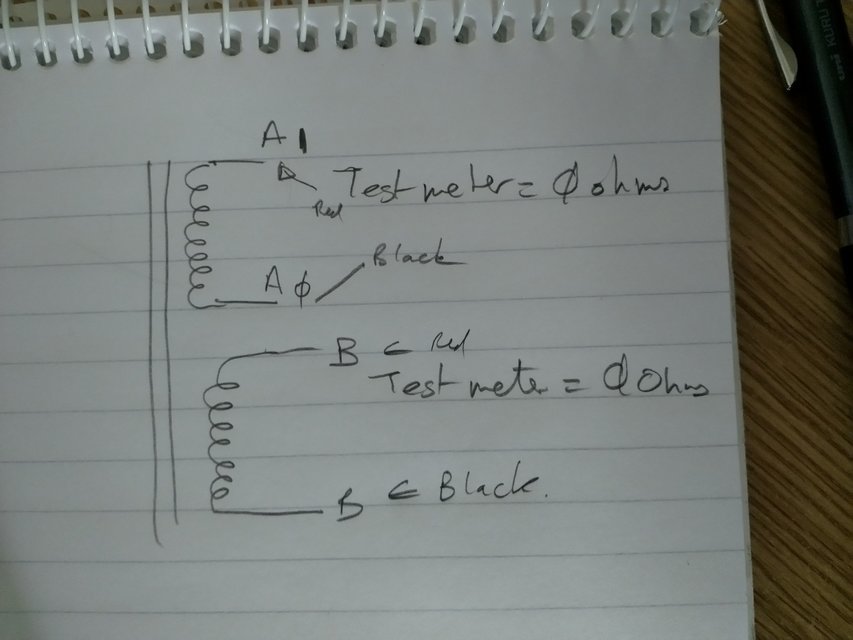

Disconnect all the transformer's secondary wires from the rectifier. You should have four of them.
Connect the mains and turn the power on, then press the trigger. See if the fuse still blows. It shouldn't. If it does blow there is a wiring fault in the primary circuit. I don't think it will blow but let's wait and see.
If it doesn't blow the fuse (expected), turn the welder off, disconnect the mains plug then using your test meter se tto low Ohms range, identify the secondary windings, label them A0, A1 and B, B - as shown below.
Let me know how you get on and we can go to the next stage

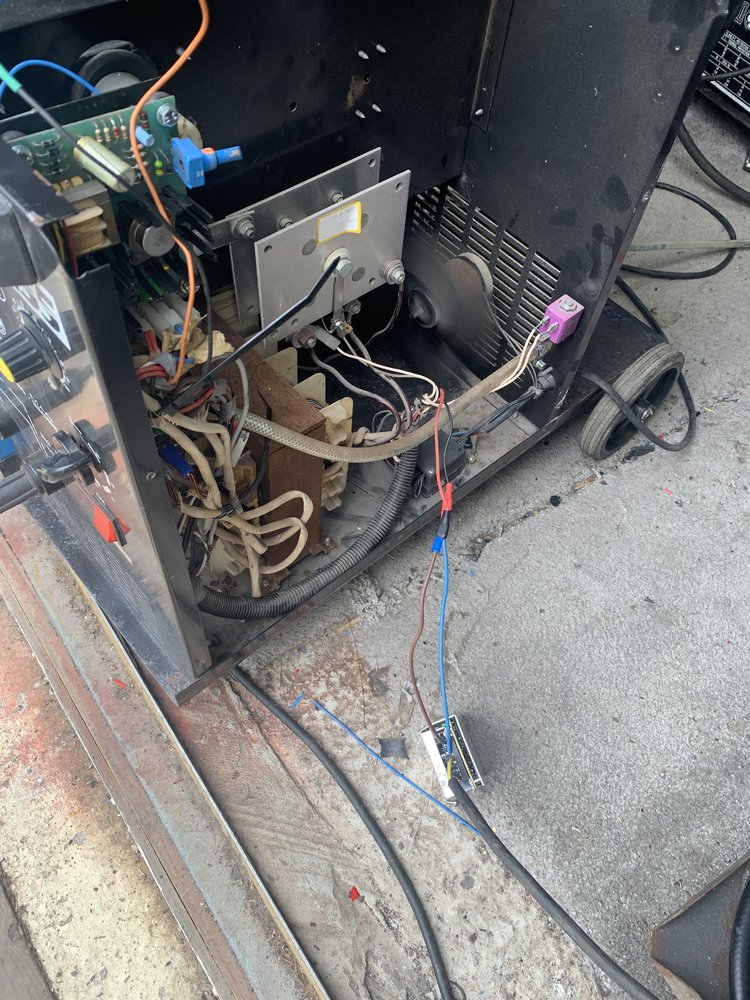

It has been fiddled with. Before it tripped, there was a spark from behind the circuit board. upon removing the board, it was clear that the soldered spikes on the reverse side had arc'd out on the chassis of the welder.
I have now placed a piece of acrylic between the board and the chassis to prevent this from happening again.
Just to be sure, I connected A0 and A1 to the positive side of the AC rectifier and B0 - B1 to the negative.
Is that right?
Nope. It blew
