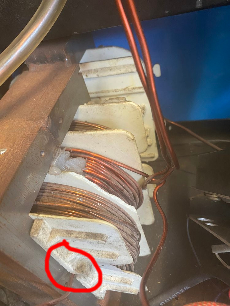

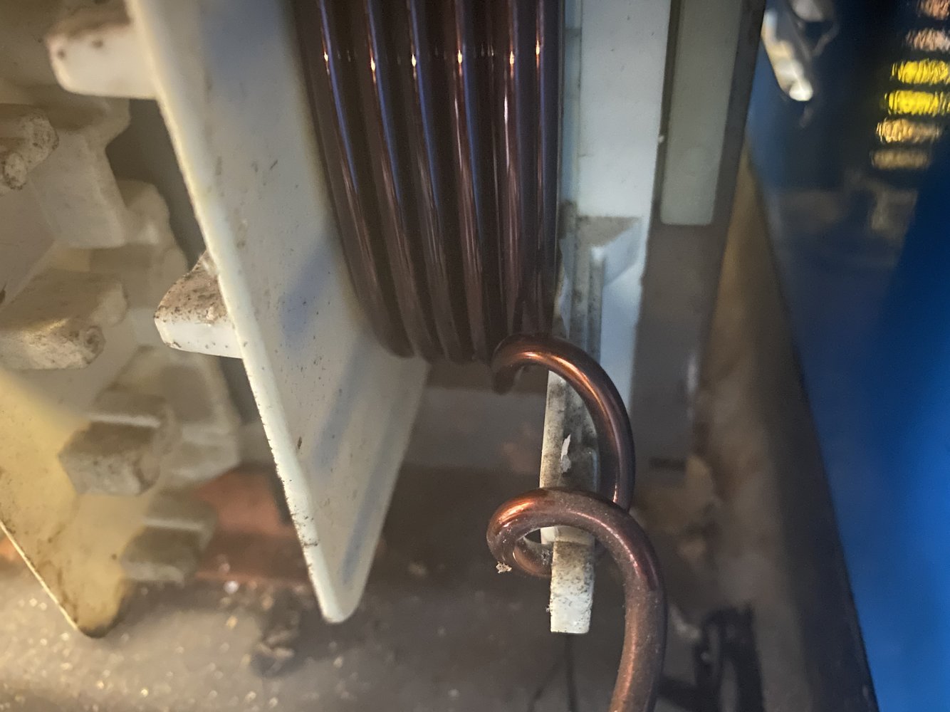

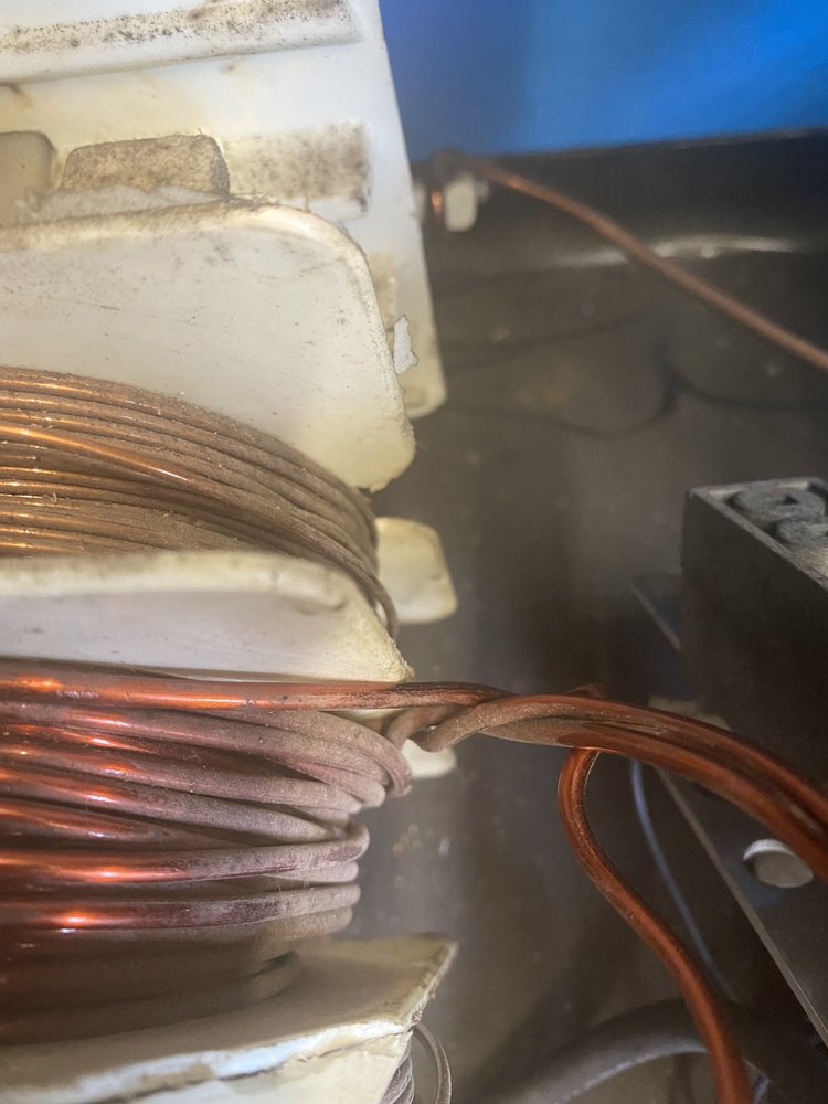

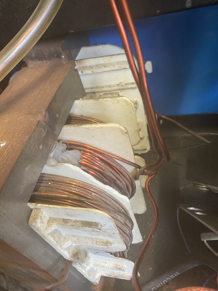

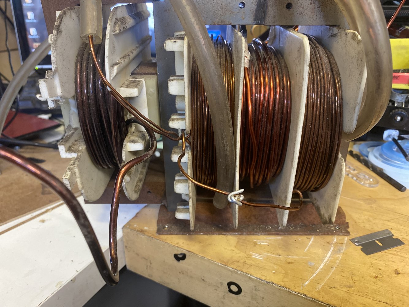

Yes top and bottom with nothing else connectedReadings 1 and 2 show a dead short circuit between the terminals. When you measured it, were you measuring across the two connectors as circled below and the transformer wires were disconnected from them ?
