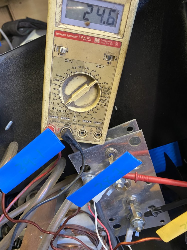

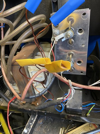

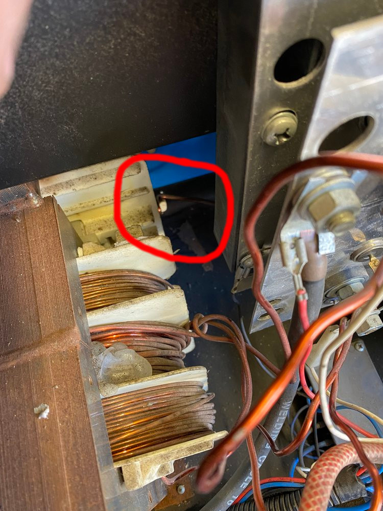

unbolt one of the wires from the rectifier that goes to the transformer, make sure the wire is not touching anything. Then plug the welder in, turn it on and press the trigger
Have you tested if the "power-up/buzz/fuse blowing" behaviour happens at all selections of the power ( voltage step ) switches?

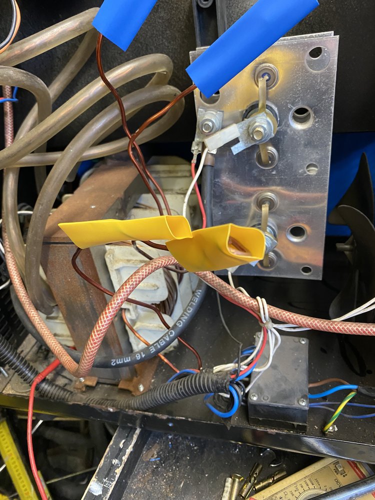

Tried this. No change in the reading. However the 2 white wires give a reading of 131ohms.Firstly, the ohms reading, can you do it again but with the top white wire disconnected from the rectifier. I think what you have read is the resistance of whatever those two white wires are connected to so disconnect one of the white wires and try again.
1- 0.042Also, on your meter, turn it to the diode test (very bottom D and diode symbol). This should be better for testing the diodes in the rectifier. Do the following tests with the white wire disconnected and note the following readings :-
1) Red lead on top terminal like in your first photo, black lead on bottom terminal
2) Swap the leads over (Red to bottom, black to top)
3) Red lead on top terminal, black lead on rectifier plate or +ve terminal - the thick wire bolted to the rectifier plate
4) Swap the leads above (black on terminal and red on plate/+ve terminal)
5) Red lead on bottom terminal and black lead on rectifier plate (+ve terminal)
6) Swap them over (black lead on bottom terminal, red lead on rectifier plate +ve terminal)

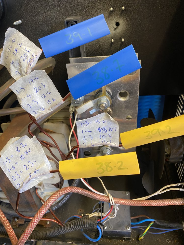

Those numbers still don't look right. A readings are good, B readings are way too low.A voltage results
1-3 = 27.7v
1-4 = 31.6v
2-3 = 34.0v
2-4 = 39.4v
B voltage results - all start @ 10.1v until triggeris pressed and then:-
1-3 = 4.8v
1-4 = 5.6v
2-3 = 3.7v
2-4 = 4.2v

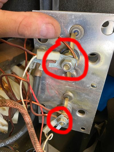

These also don't make total sense. Readings 3 & 5 are about what I would expect as the forward volt drop across the diodes, readings 4 & 6 show the diodes reverse voltage, together they say that the diode(s) being measured are good.1- 0.042
2- 0.042
3- 0.534
4-------- no reading
5- 0.534
6---------no reading
