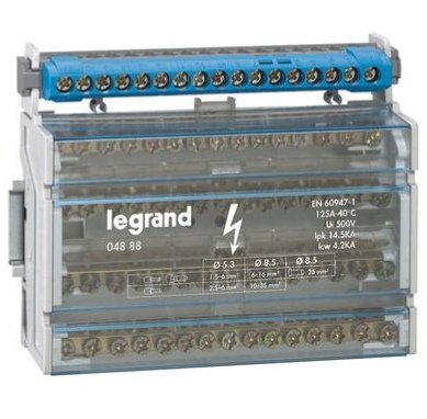

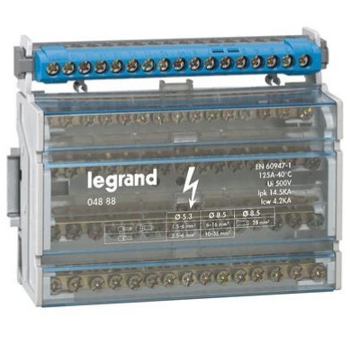

I didn't understand if you solve the problem but I can leave an advice to simplify problem solving in the future
Use one of this things in the breakers panel and connect the sockets directly to it
If you have a problem and you cannot figure out where is the problem you can disconnect the the cables without to open every single plug and socket , light or whatever you connect to it
Few screws , and much cleaner work
Here in Italy isn't unusual to find old installations that use the ring scheme .That's great if you are using radials like most of Europe. However it doen't help with ring mains.
