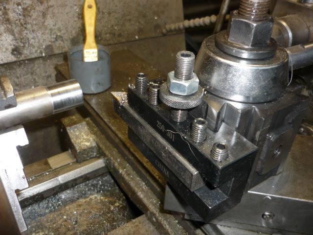

Yes, a threading tool holder will hold the insert at the correct angle, it will also likely have a shim to give the correct helix angle.
A TCMT holder probably won't hold a threading insert securely and definitely wont be at the correct angle.
