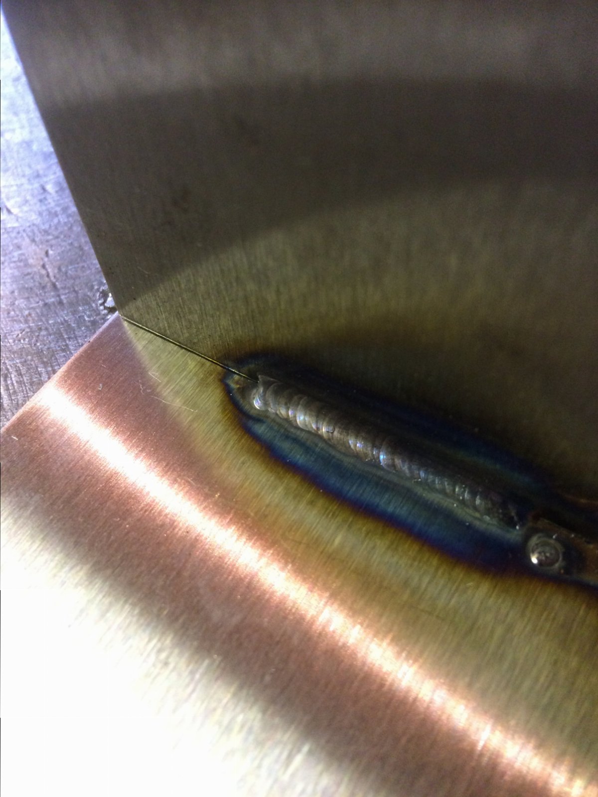

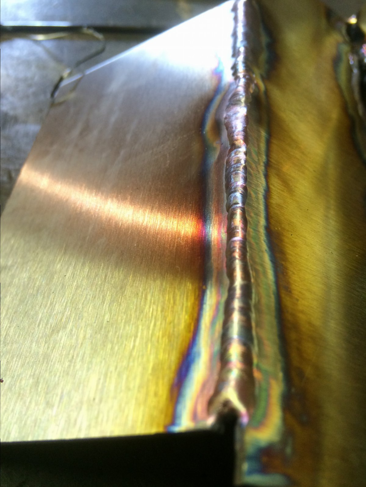

No mild steel as per post... XSo this is SS with MS filler? Looks just as I would expect tbh.
No mild steel stock not SS .. XSame as Hugh, for ms filler on ss it looks as it should.

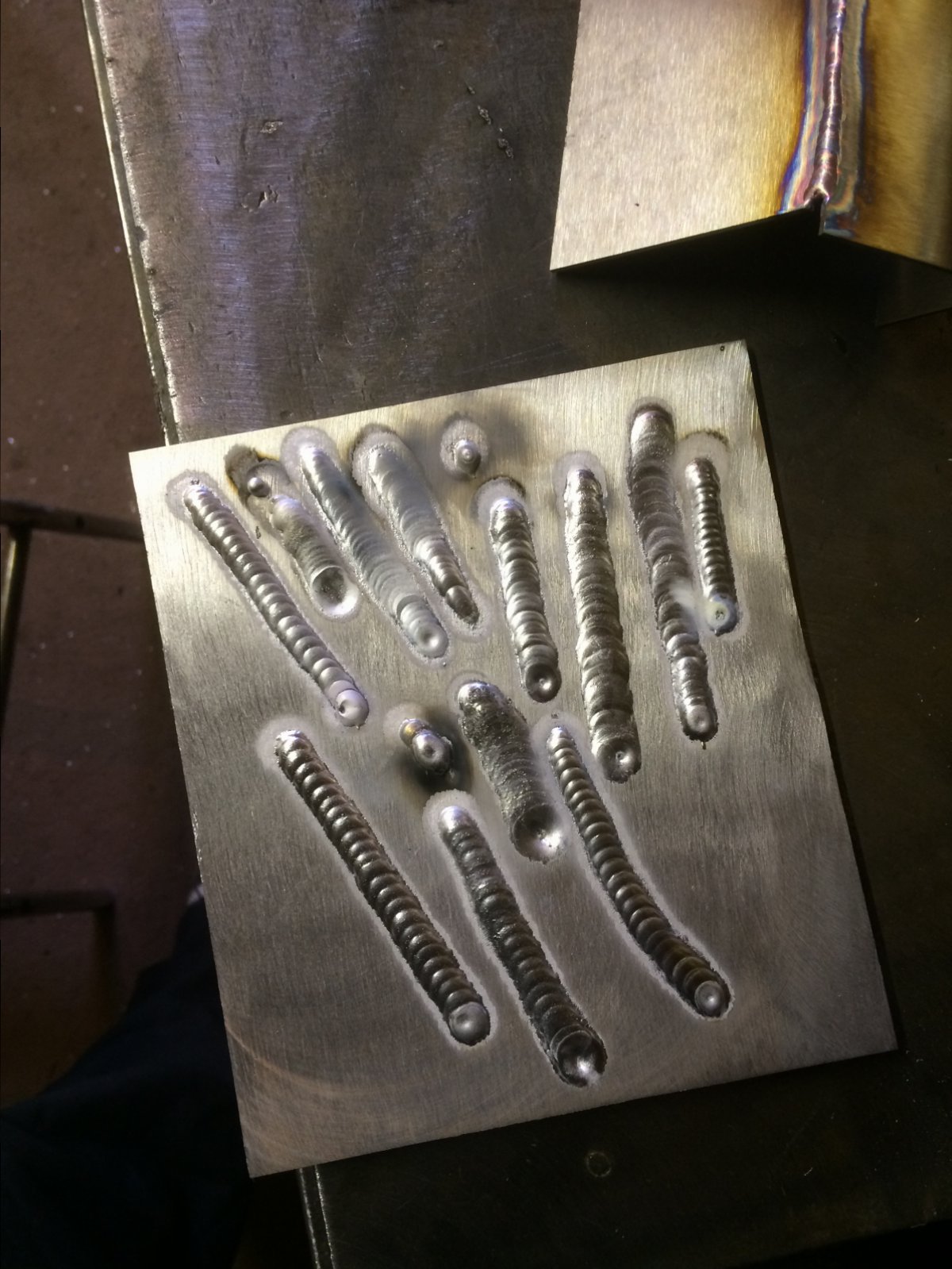

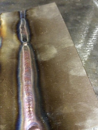

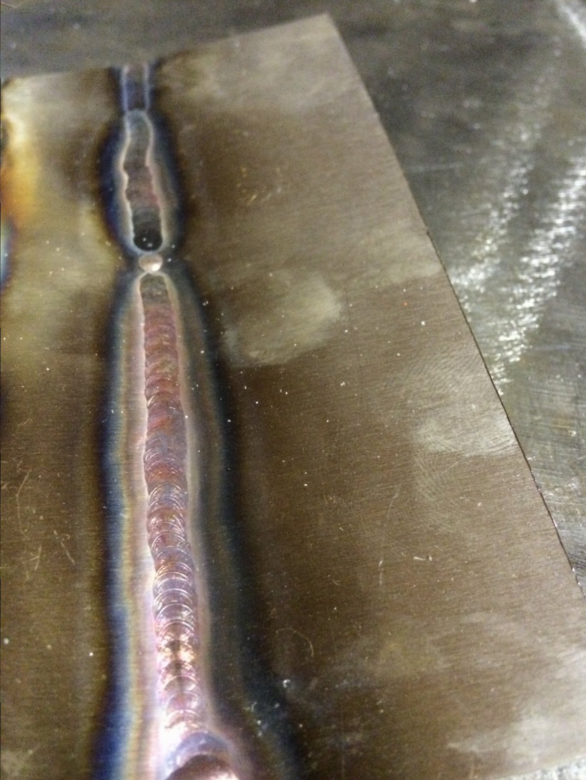

Neither. Changing that split pipe sorted out the contamination issues and a little watch over his shoulder helped with refining things further and popped a much needed confidence boost back in there.yay !!
so was it the machine or his technique....
