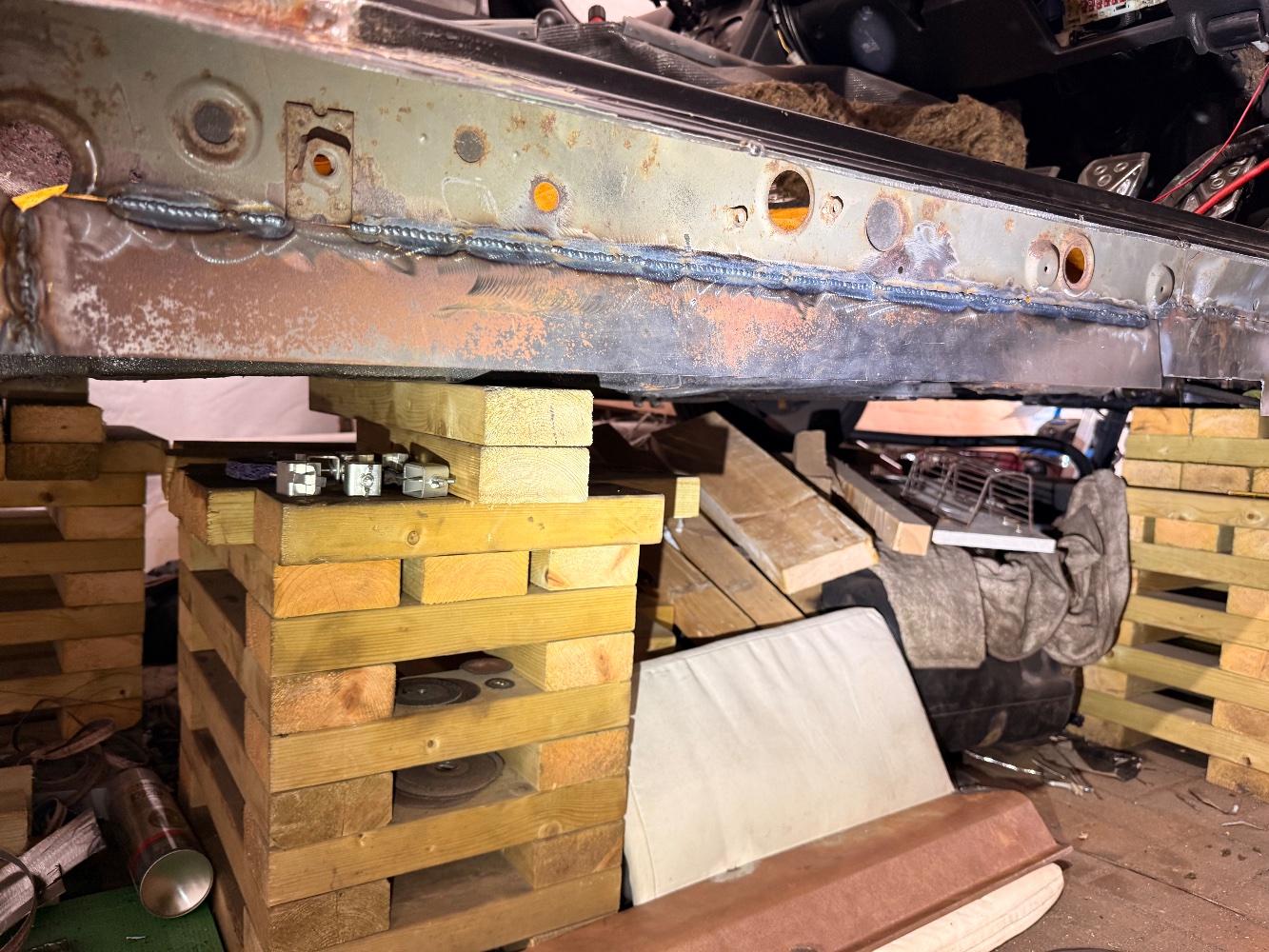

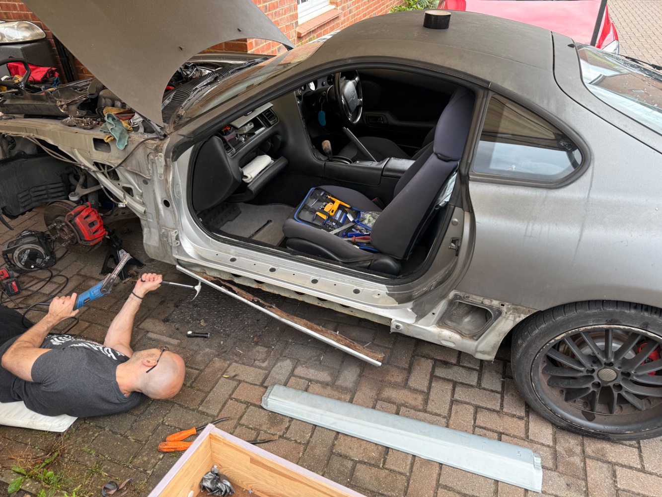

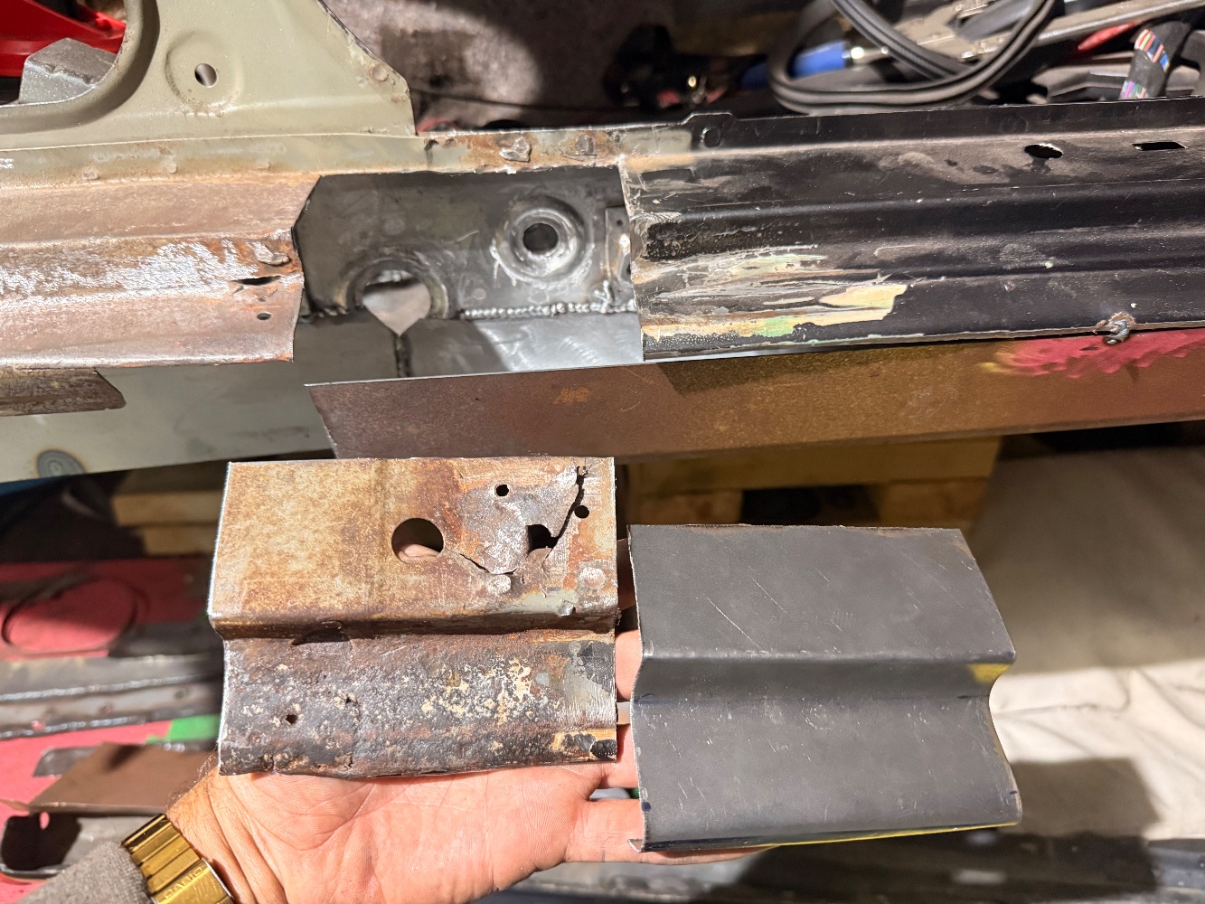

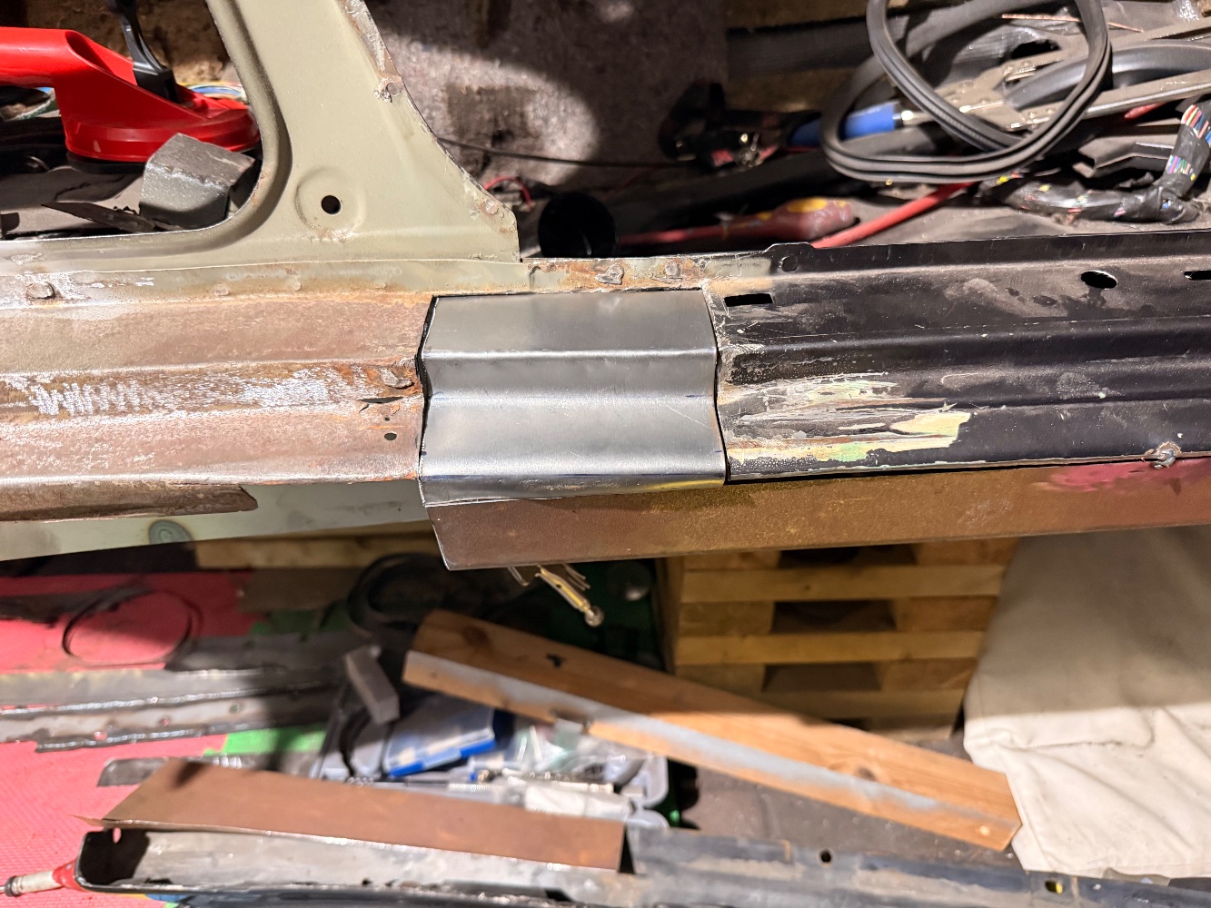

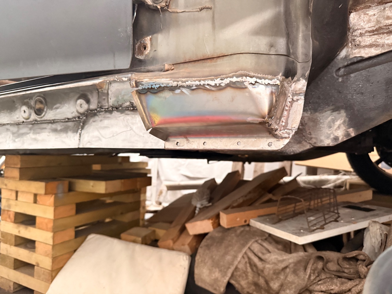

We all get 1 step forwards and 2 steps backwards some daysHad a chance to put in some more hours this week but wasted a lot of it by doing one particular job twice! Got the inner sill all cut and then a replacement piece of metal made and welded in. This went well but when I went to fit the outter sill, it wouldn’t fit.
I then broke the cardinal rule and reversed it. I measured once and cut twice! Disaster, as I somehow managed to cut 10mm more than I should have. I then wasted half a day trying to fix my cock up before realising how ridiculous it looked having a 10mm strip welded on to the bottom of a panel so I had to force myself to cut off all the work I had done as well as all the spot welds to make it right.
Next job is to fabricate the end bits which are going to be a real pain. View attachment 511860
