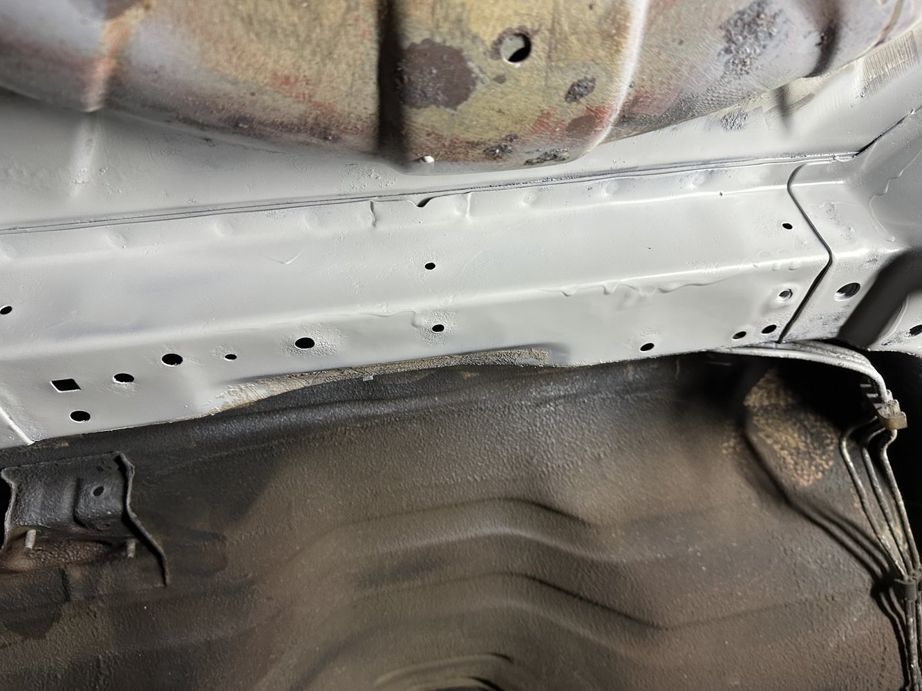

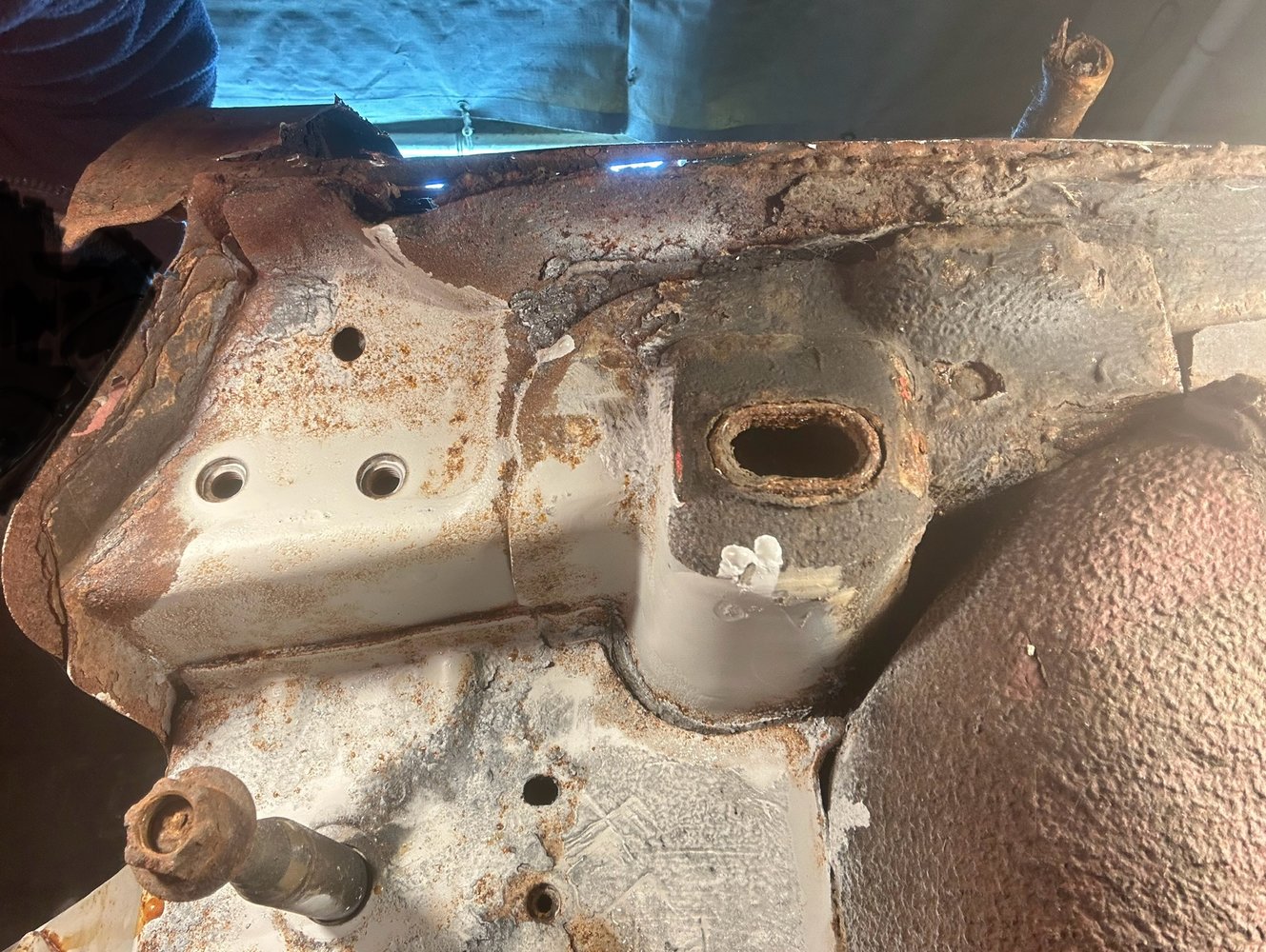

Yes Rust-Oleum Hard Hat Anti-Rust Corrosion Primer Grey Spray Paint 2182Is that an epoxy primer you’re using after rust removal?

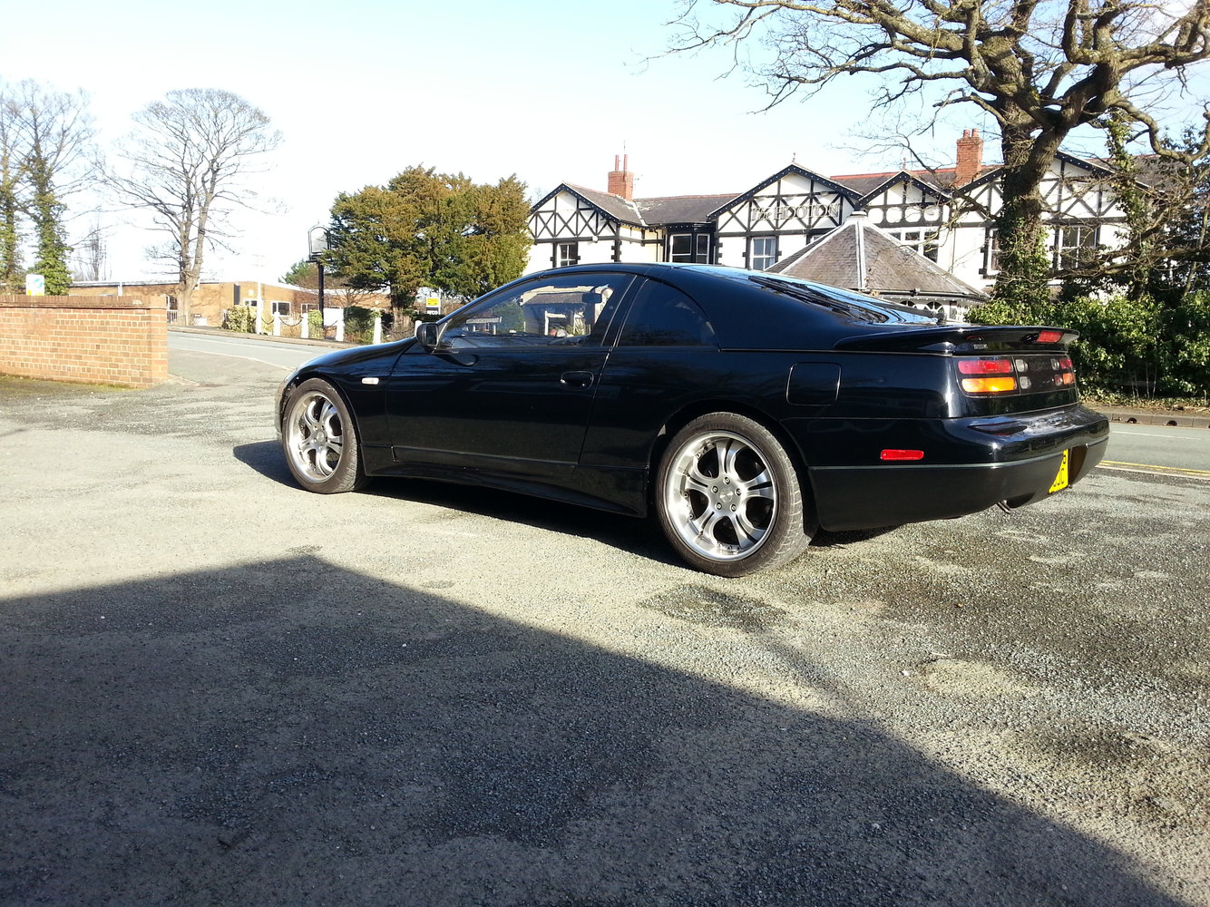

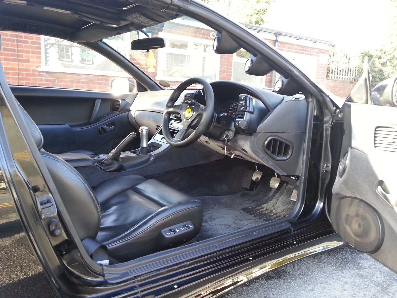

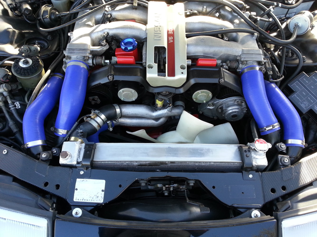

Still a nice looking car.I have had at least 6 of them in my past life, here's the last one i owned and possibly my fav

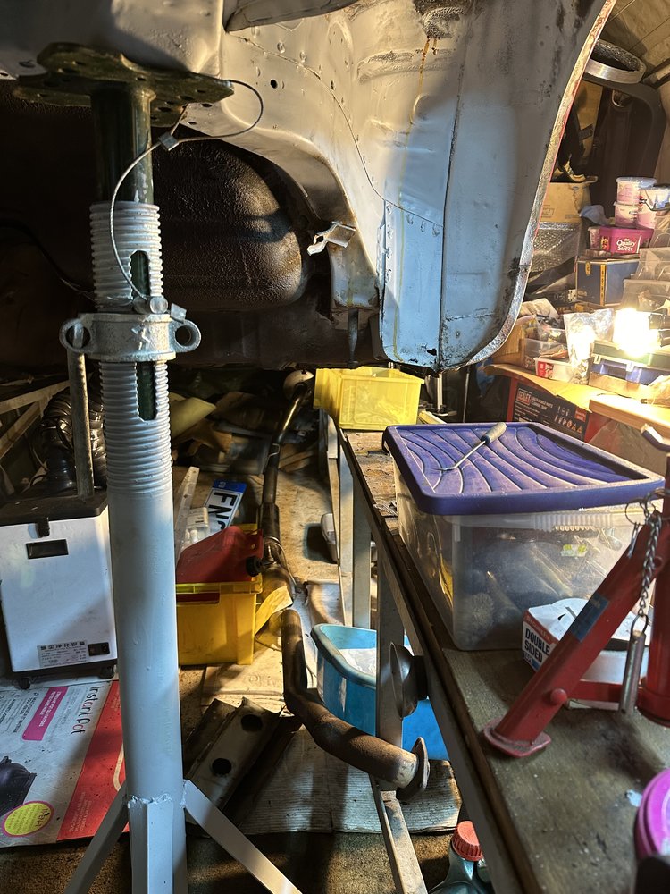

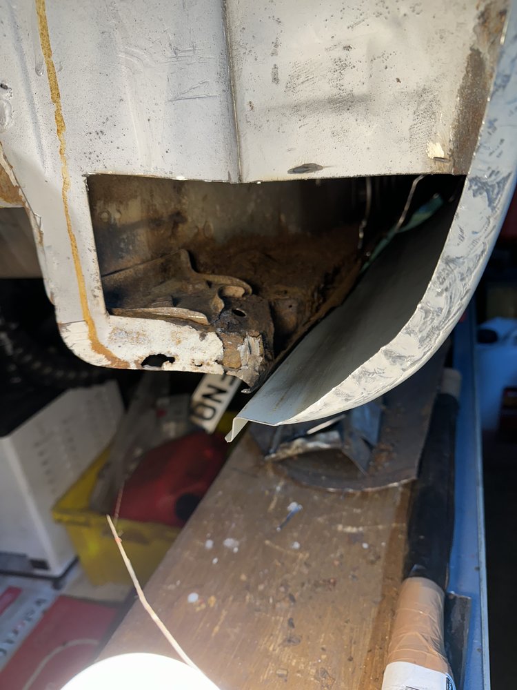

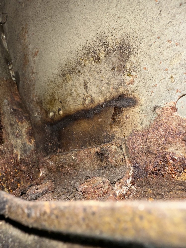

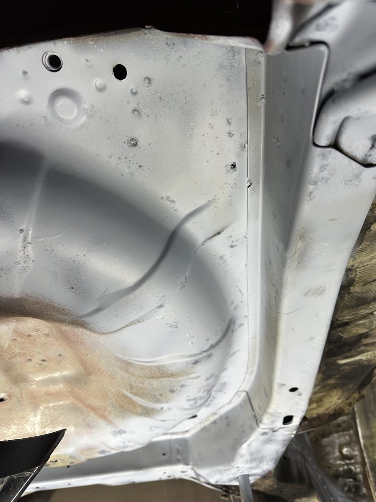

View attachment 434965 View attachment 434966 View attachment 434967 View attachment 434968 View attachment 434969 View attachment 434972
Without doubt mate...becoming hard to find good ones now under 10kStill a nice looking car.
I know, not that I've been looking cough cough.Without doubt mate...becoming hard to find good ones now under 10k
It’s is a unit made up of different components the company I brought it from is no longer trading it has a 10ft lead and takes 3-4 people to move it. Has its own small box trailer.Very impressive. What is the laser gear you are using? I've seen it done with large lasers but obviously you are using something on a smaller scale.
Have to soak with primer, seam seal then underseal.Nice project!
Also the laser sounds cool....it removes rust between the seams, but how to you then paint/protect the bare metal between the seams?

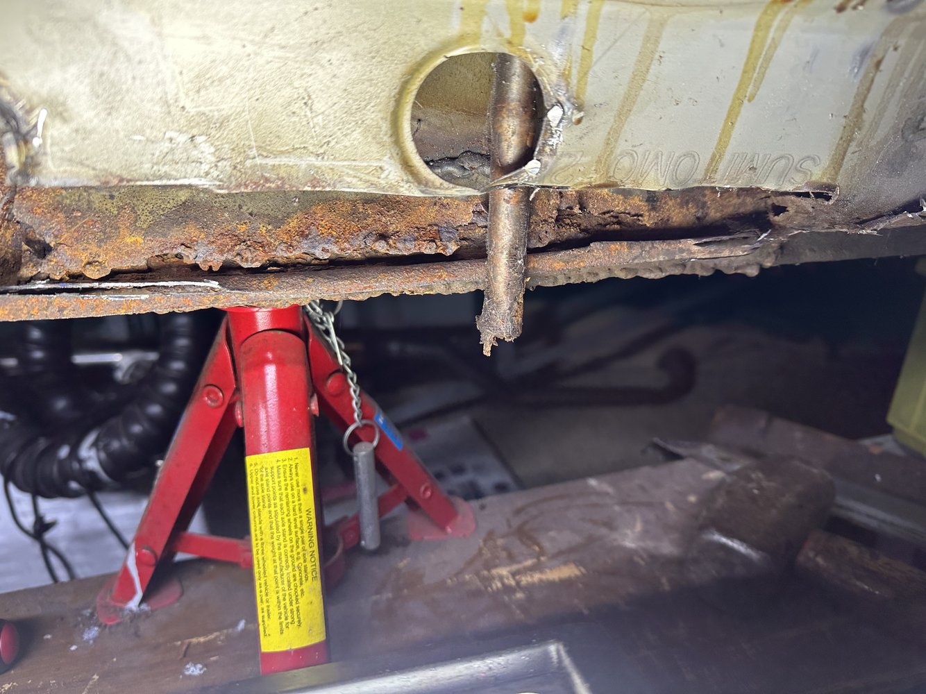

Mild steel, cold rolled or zintec; 0.8, 1.0, 1.2mm get a calliper on a clean bit see what was originally used.What type of steel do I buy and what gauge.
Jezzus is that thing even legal?I tested the Laser on the sill to see how it cleaned it.
