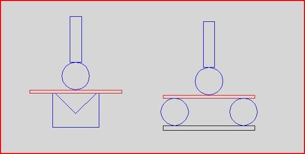

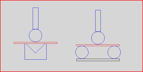

All you need is 2 pieces of bar and a vee block, press spigot is usually 1", choose a diameter for the tool a touch smaller than the required radius to allow for a spring back, for a small one of job the vee could be made out of a piece of angle or two pieces of round bar, the idea can be easily adapted to be used in an arbor / bearing press, or even make a small frame and utilise a bottle jack.

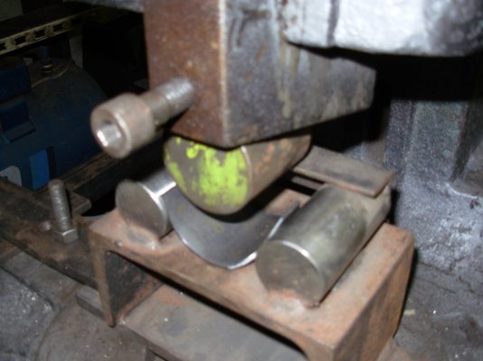

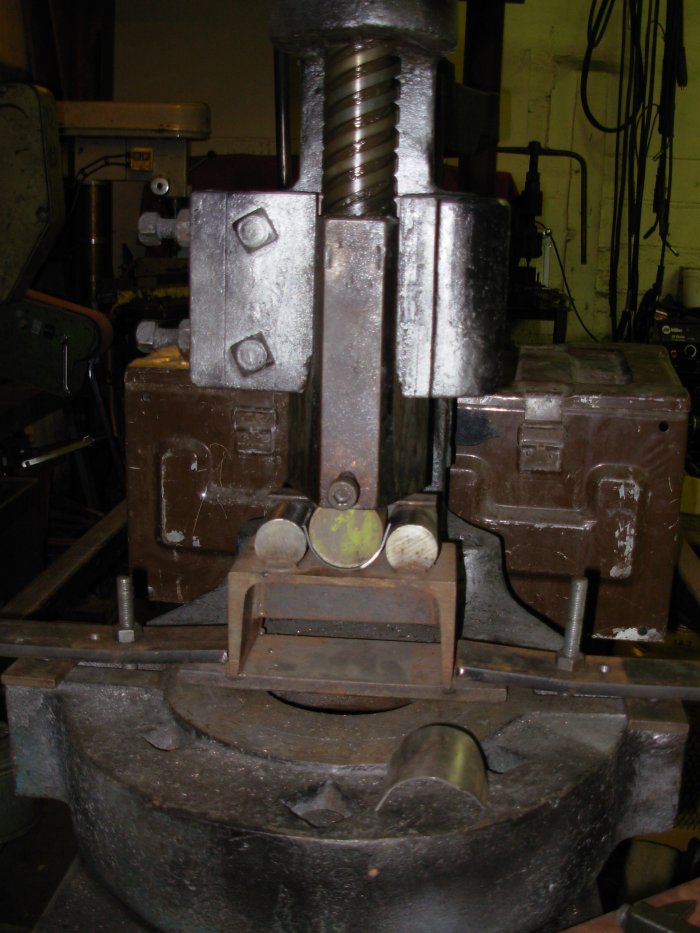

Heres a link to a simple press tool I made for rolling some 50 x 10 ladder hoops
