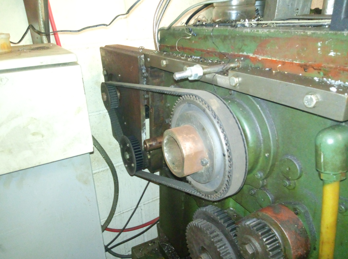

Yes I love my old roundhead. Obviously I would rather a DSG or a Holbrook. The only real problem I have is too slow a top speed. 1000rpm not enough.Yes it has, many times over. It has knackered headstock gears which is quite common with the later 2000's and I had to bypass them by fitting a direct drive servo motor, you are much better off with the roundheads. It is a better lathe than some of its class but there are a lot better out there as well, if I had room I would have had a longer bed manual version of my CNC lathe that came up for sale a few years back.
I very rarely go above 1000rpm, the drawback to a lot of other lathes for me is spindle bore, that is where Colchesters are decent.Yes I love my old roundhead. Obviously I would rather a DSG or a Holbrook. The only real problem I have is too slow a top speed. 1000rpm not enough.
I'd love to see how you did this - is there a thread on it somewhere?Yes it has, many times over. It has knackered headstock gears which is quite common with the later 2000's and I had to bypass them by fitting a direct drive servo motor, you are much better off with the roundheads. It is a better lathe than some of its class but there are a lot better out there as well, if I had room I would have had a longer bed manual version of my CNC lathe that came up for sale a few years back.

It's a cleaner and easier installation than I'd thought... does the servo give you some motor braking? And what's your high and low speeds? Clearly works well enough to justify spending some cash on it!

It'll just be spinning the gears back to the clutch and input drive shaft, and making a racket since it's worn out. Looks like he took the belt pulley off and left the shaft.How do you switch to geared drive? In the video you just moved a lever on the machine? But looking at that setup the gear train is bypassed?

Aye as said I am just bypassing the gears between the spindle and original motor/clutch. I have the gears disengaged via the levers as if they are engaged they get back driven from the spindle.How do you switch to geared drive? In the video you just moved a lever on the machine? But looking at that setup the gear train is bypassed?

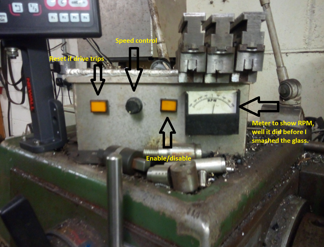

Yes servo brakes the motor, I have a braking resistor in there to help. High speed I think I kept at 2000, low speed is as low as you want... does the servo give you some motor braking? And what's your high and low speeds? Clearly works well enough to justify spending some cash on it!
That’s dc is it or AC?Yes servo brakes the motor, I have a braking resistor in there to help. High speed I think I kept at 2000, low speed is as low as you wantI didn't spend anything on it really, already had bought the servo drive and motor from eBay for projects, prob cost under £100 for them, belts and pulleys were probably more expensive.
ACThat’s dc is it or AC?
