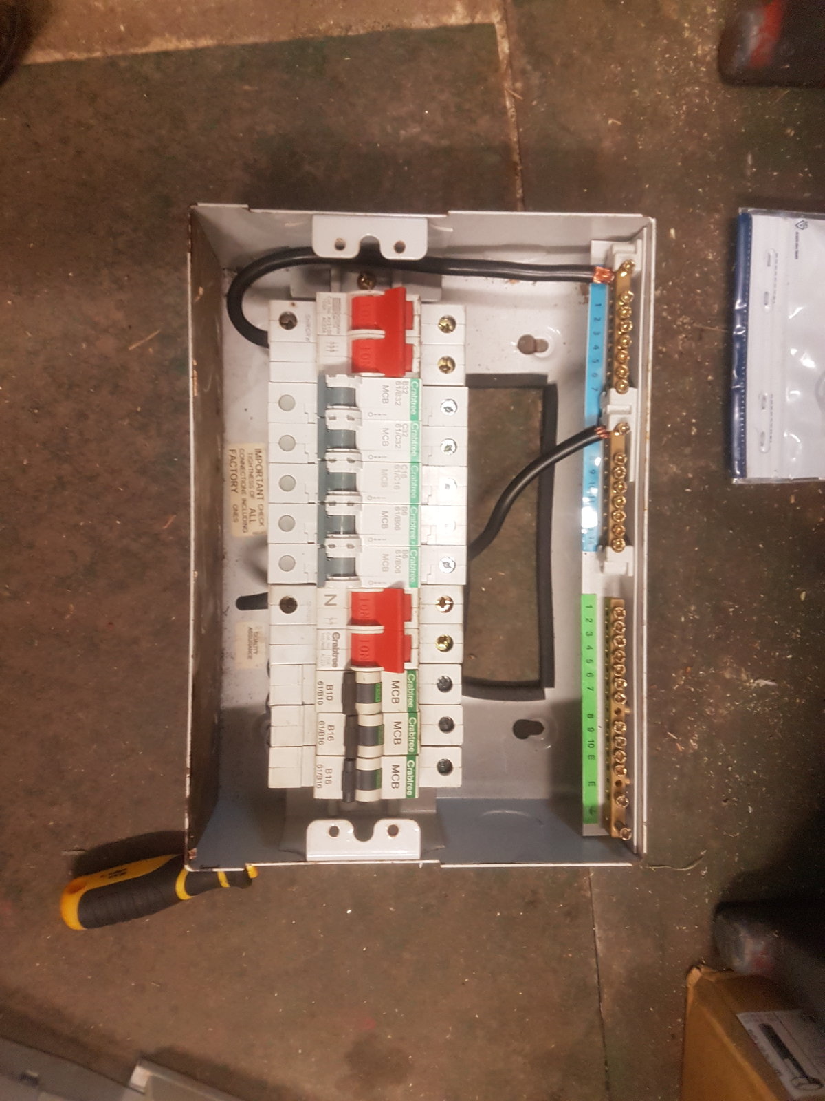

even if u have an internal earth it needs bonding with a gland and earth tab at its sourceok so the electrics are in i didnt have a correct sized gland for the armored cable, so the Armour is not earthed ATM, Q does it need to be?
i have ordered the correct size glands so i will fit them in a few days and bond the tab to the board. thanks mate I thought the armour had to be earthedeven if u have an internal earth it needs bonding with a gland and earth tab at its source
