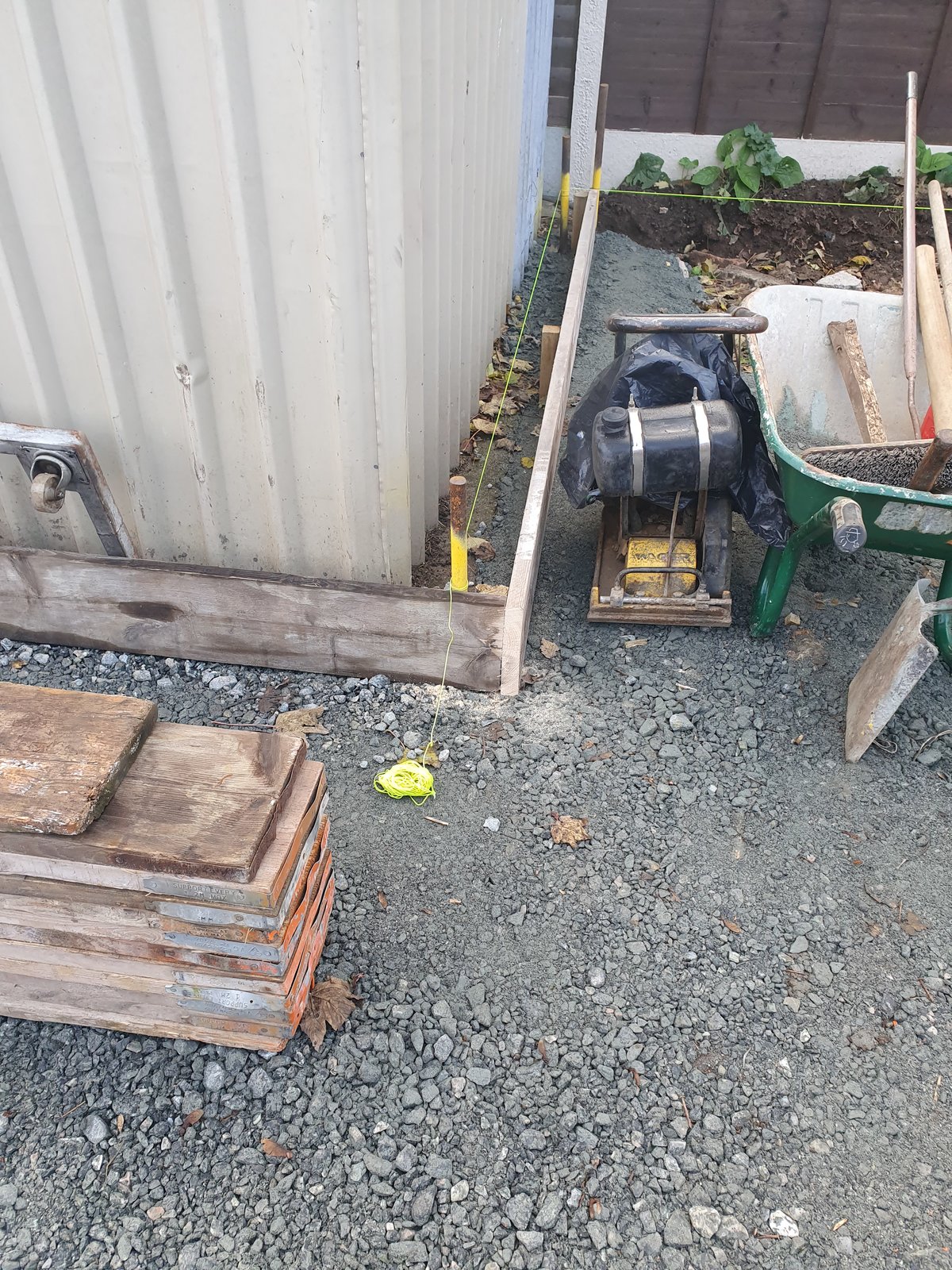

It's very good ground. Even with using the whacker it doesn't draw any water up.With the amount of rain, we have had I was expecting this to look like a swamp. Looking Good.

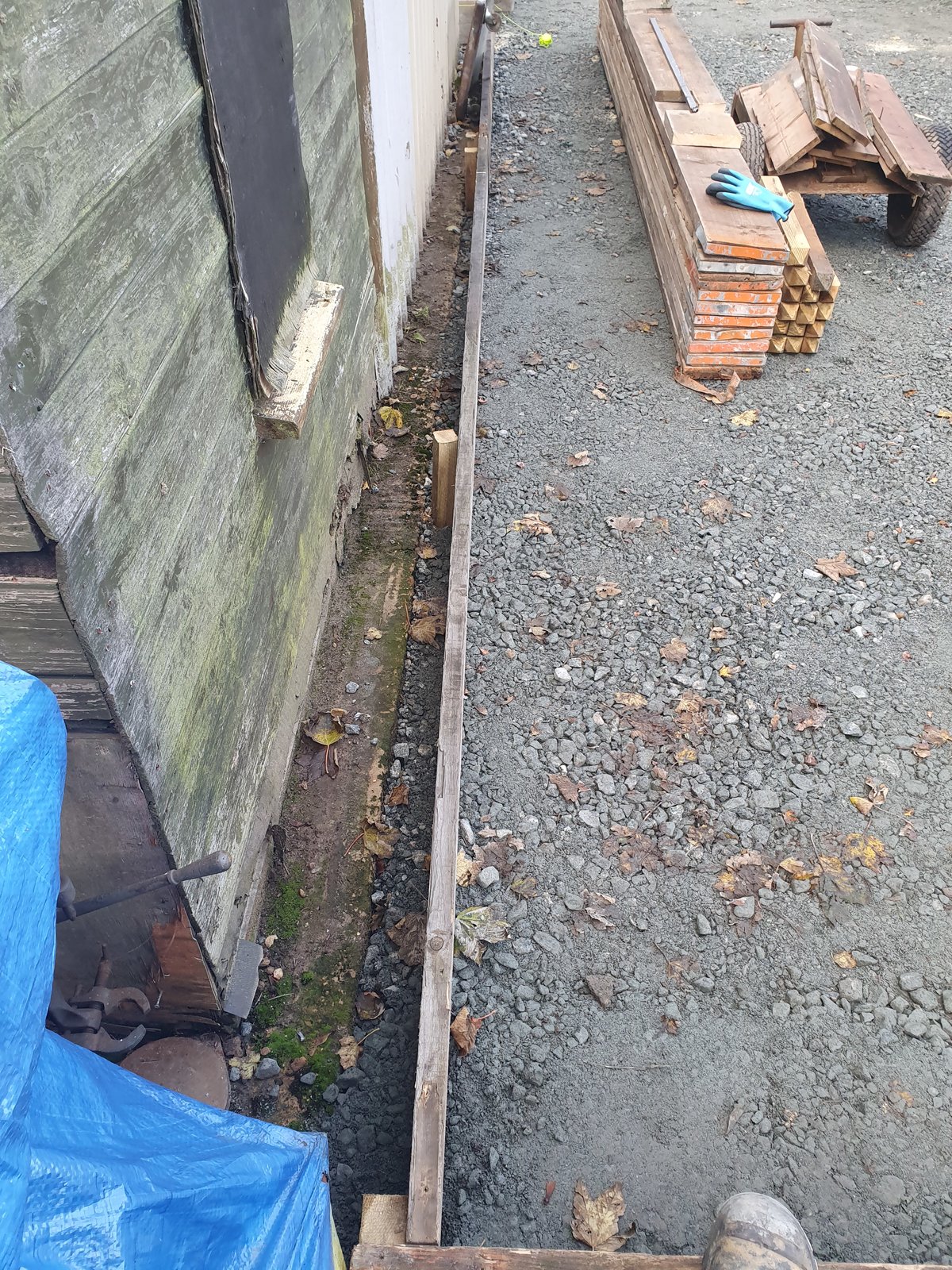

Pump. Power tamp. And power float.Thatll take a fair bit of foncrete to fill that, hope you have help to barrow, or mix

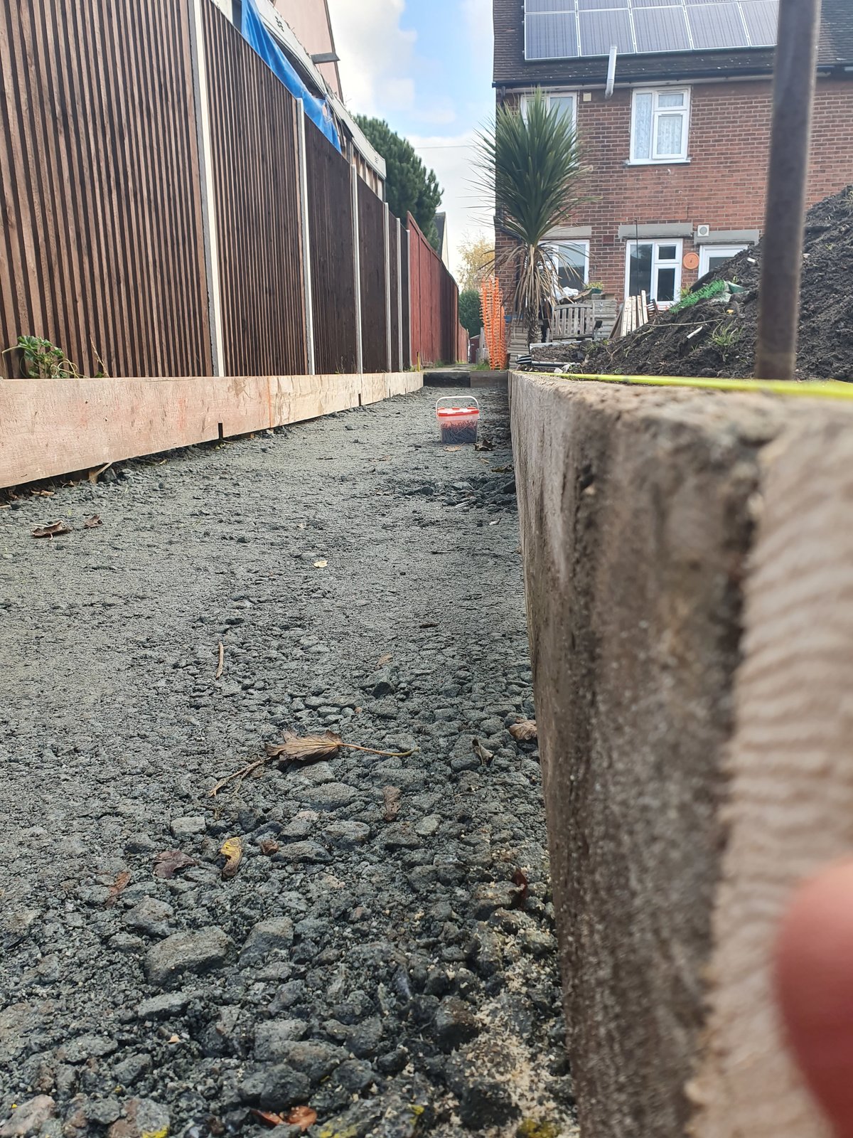

Only little issue I have is the boards. The twisting in them I can sort as I go. But some have a bow like a banner. You dont notice is but I eye everything in. Every little dip or bow will show when I pan and blade the concrete. Might have to use a chalk line to pin point to highs and lows and belt sand em.
Got my eyes on a bigger granite tableYour going to need a bigger surface plate![]()
No. The monalithic structure behind it
Road formers if you have space prevent this somewhat as Im sure you know.Only little issue I have is the boards. The twisting in them I can sort as I go. But some have a bow like a banner. You dont notice is but I eye everything in. Every little dip or bow will show when I pan and blade the concrete. Might have to use a chalk line to pin point to highs and lows and belt sand em.
Yes. When I was in the trade getting hold of them was easy. Been retired from it for 6 years and dont have the contacts now. It be ok .Road formers if you have space prevent this somewhat as Im sure you know.
