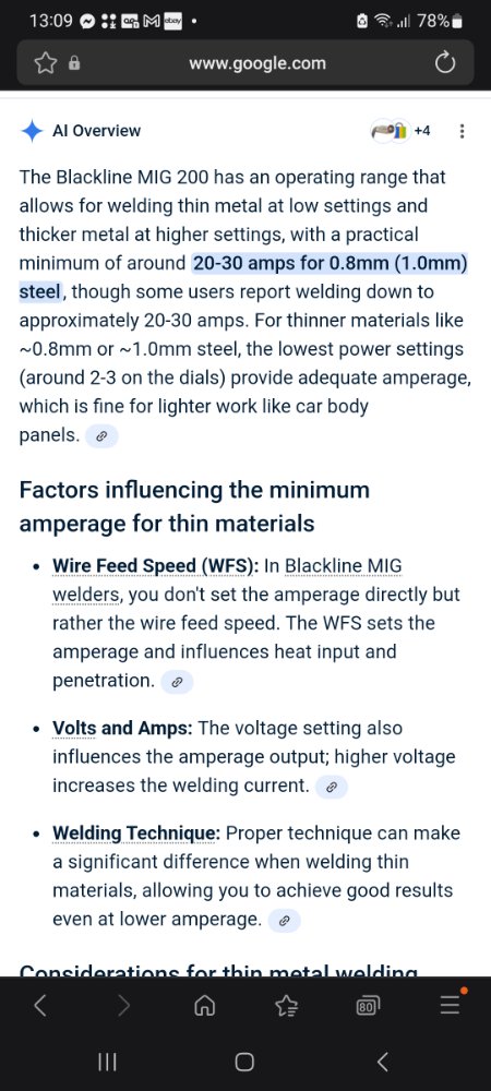

In the site it actually says not to use it on domestic 13A but yeah I get I won't be able to draw full power unless I upgrade power supply. The reality is I'll most likely be using an extension lead from one of the sockets in the house. Just to make it that bit more awkwardIt will run on a standard 13A plug. You just will only be able to use a portion of the power (about 120A?) without tripping a breaker or blowing a fuse.
