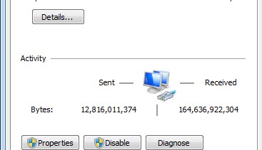

It seems to be communicating with the controller with the sent/received in the image attached above.

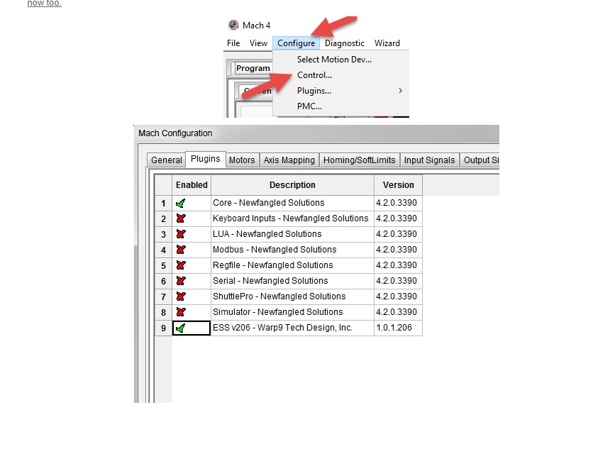

You may need to enable the plugin as I mentioned, here is how it is done with the ESS, it will be very similar for the Swifty except obviously the plugin to enable will be Swifty or something like that.
