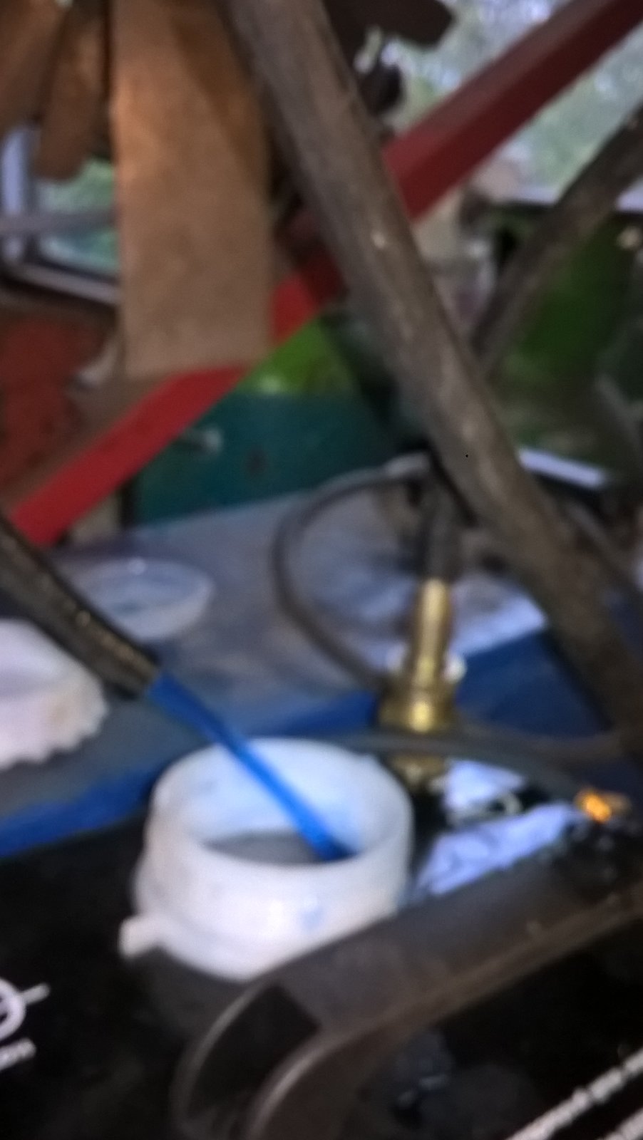

My money is on flow restriction still.
Do you want to try my torch? It's only 4mtrs but it will give you an indication of whether the cooler is working properly. My cooler has exactly the same pump as yours so in theroy you should get exactly the same flow rate I do with my torch. You cover the postage costs and return it next week and I'm happy for you to have it and give it a whirl.I did try pressure testing while steadily increasing flow restriction to rule out pressure collapse at no flow.
Can't say I'm not trying. All in the interests of forum research as if it doesn't change it's ways pretty soon it's going back regardless.
He could remove the cap heads from the front of it and see if there is anything obvious to determine if this is the case. If it is the same as the ones I've had apart what can happen is the bakerlite motor shaft can actually fracture where the key sits in the way. This could quite possibly cause exactly what you say. A poor drive on the main gear.Well I am sticking to drive issue,
