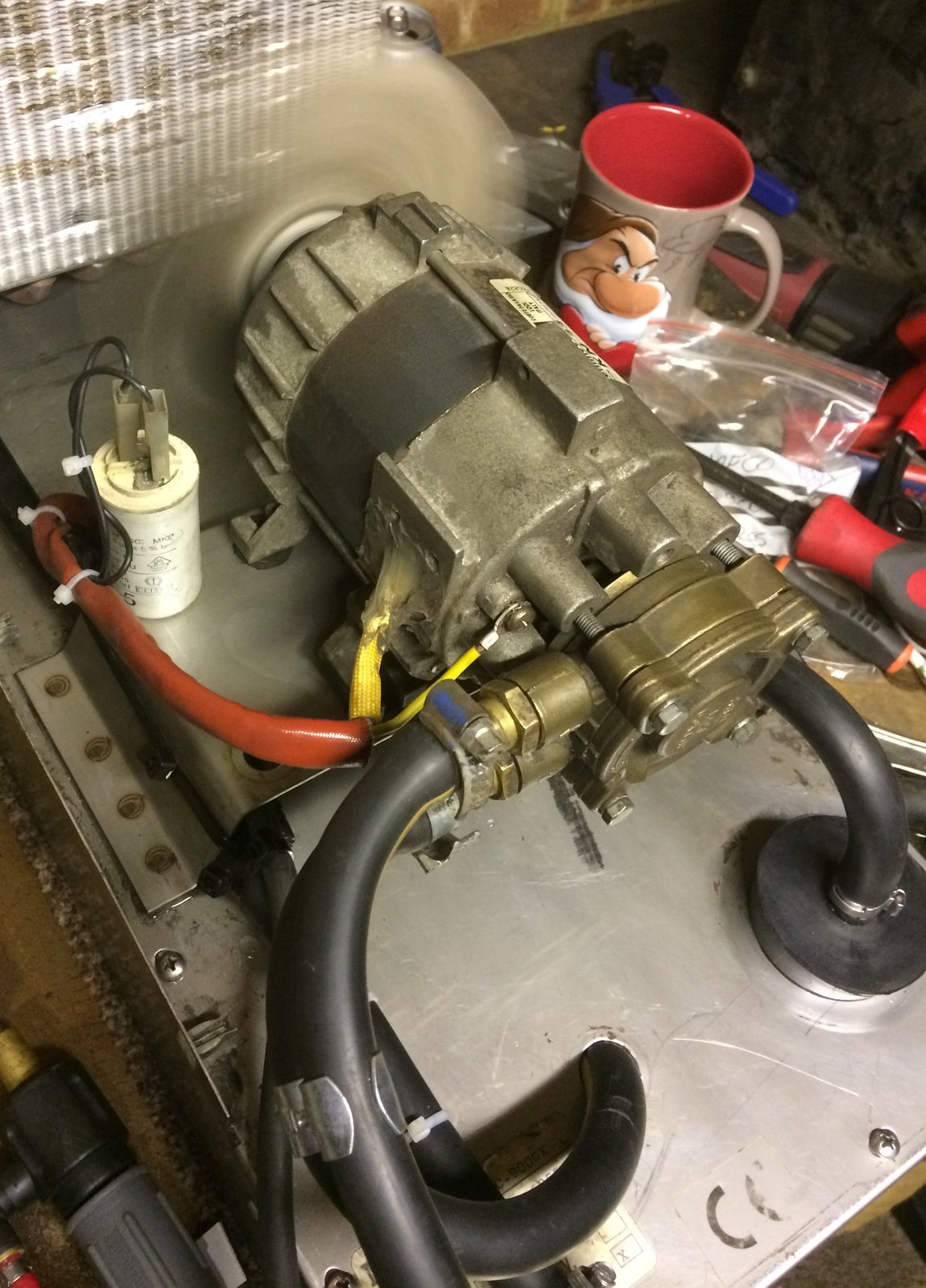

There's no direct connection between motor and impeller. Uses magnets
That was what I was thinking it must mean, so now that raises the question. As there is no pressure is the drive slipping? Is there adjustment for this?

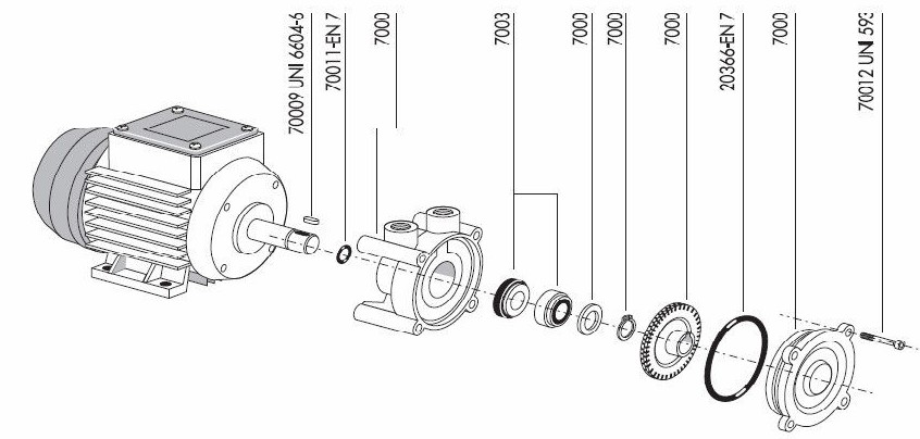

It's exactly the same as yours hood. I've had loads of em in bits and replaced parts etc. It's a single fly wheel gear on a shaft in a chamber.Found some random stuff and it seems the Ceme pump I have is a Turbine type rather than a gear pump and also looks like the Simaco one is the same.
Nope not in the Ceme pump, it is shaft driven with a seal. It is however the same type of pump, it would seem, as the Simaco. Both are turbine pumps so you can totally block the outlet and it will not do anything other than load the motor up a bit where the Procon Vane pumps or a Gear pump usually require a bypass valve.Magnets![]()

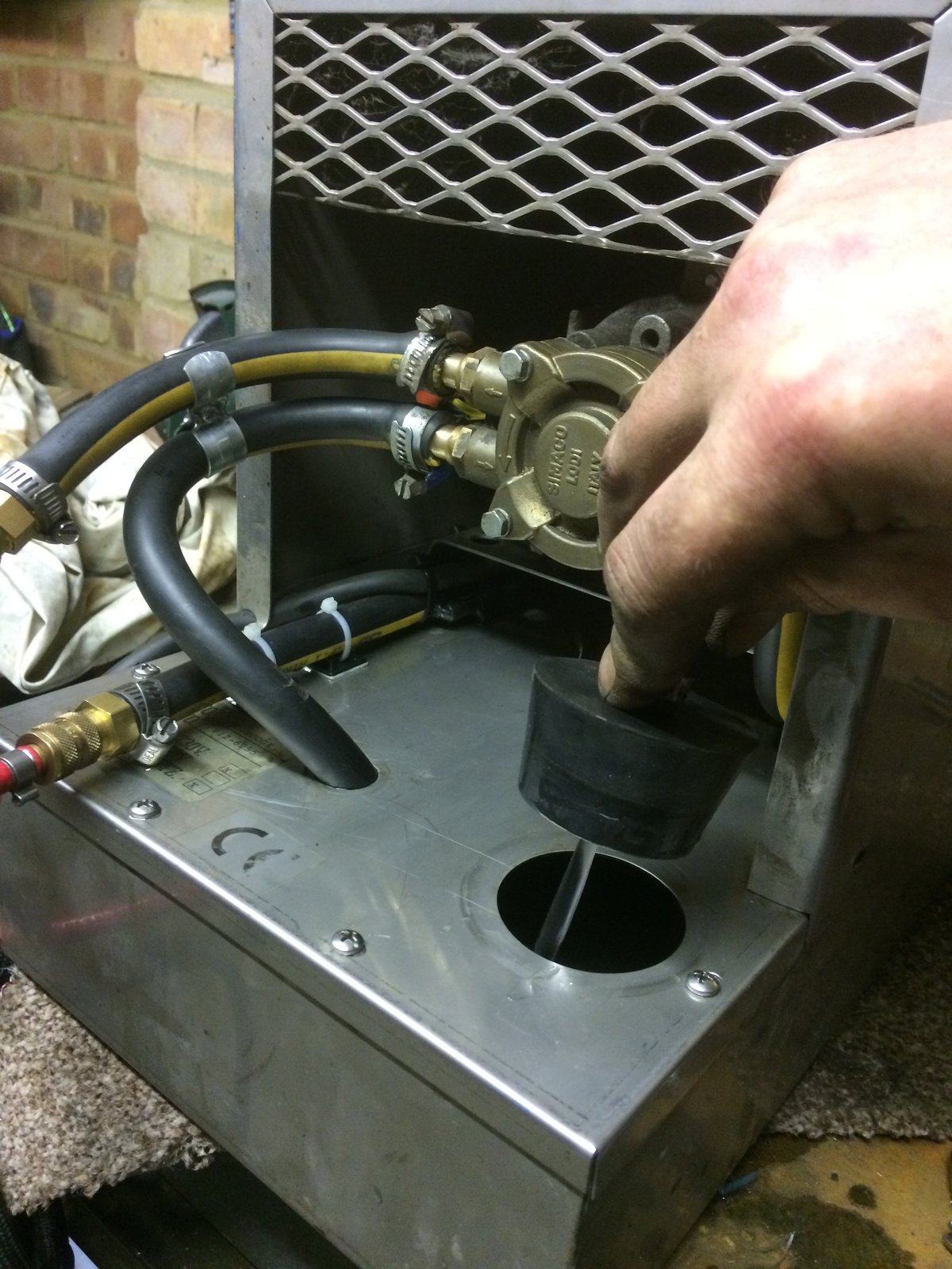

Can the motor direction be reversed?Just had a thought, I was working on it beng a vane pump, either pumps one way or another. Its not so cut and dried with centrifugal pumps, maybe rotation is the issue. I will investigate tomorrow. Dearly beloveds' retirement bash tonight so end of play

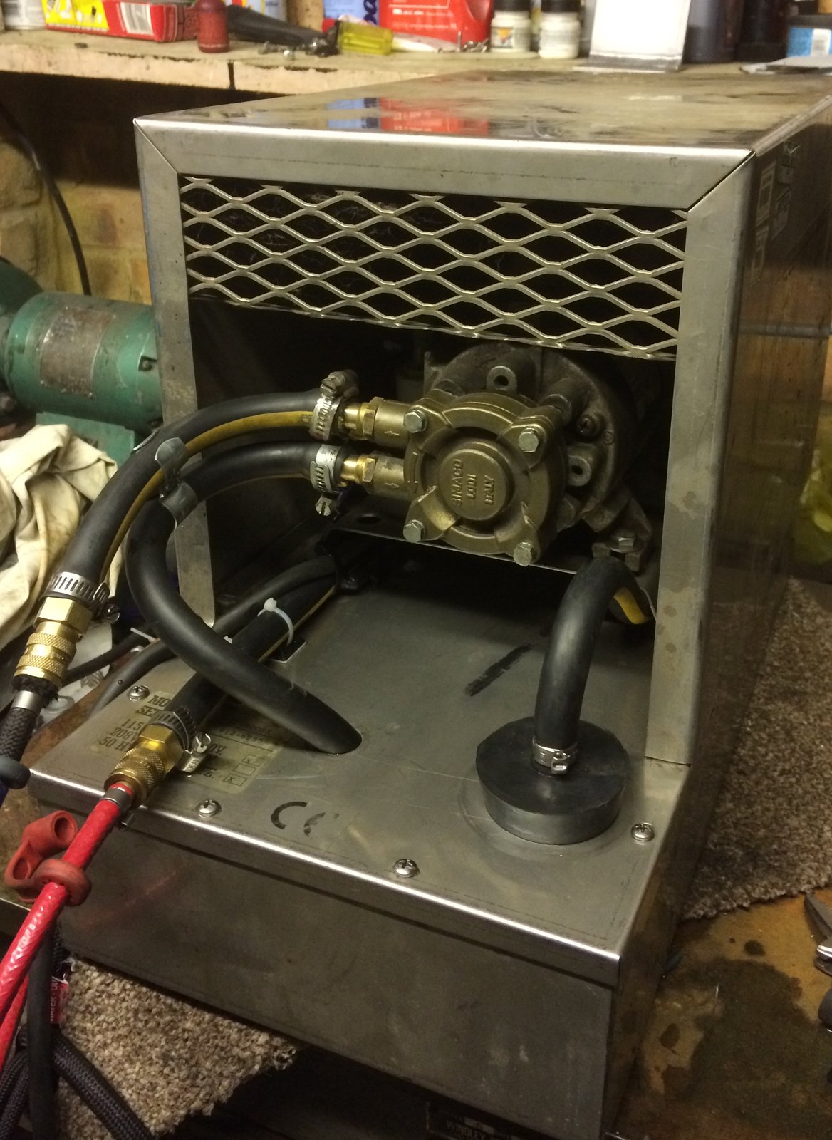

When I used yours hood there was as easy 2 lpm maybe more coming back into the tank. My torches are 4 mtrs they are also weldtec torches which have big bore lines giving better duty cycles. I like those ceme simaco gear pumps a lot. Extremely reliable and perfect for the job. Used them loads of times and not got a bad word to say about them.With my Ceme pump the flow through my 8m torch is low (but not as low as @bletchmonster one) whereas when @Richard. had it he said it there was plenty, I suspect he may have been using a 4m torch.
Having said that there was still more flow through my torch than the OP is getting with a brand new pump so there does seem to be something amiss.
