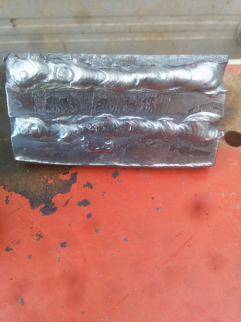

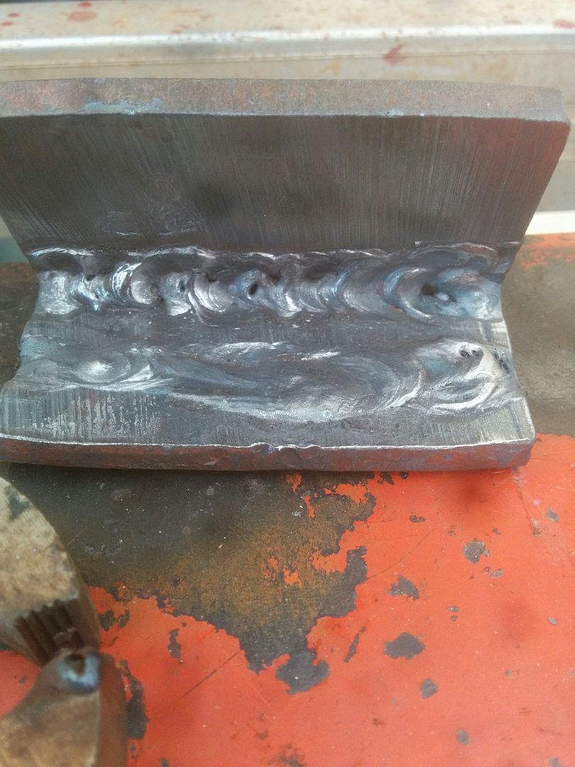

Now if I would just quit dipping my electrode. At least not dipping it as often but I'm sure I've already used an inch of it.
Sheild is clean, set on a 9 shade, sensitivity is as high as it goes, I have a 2x cheater, & I ware my glasses also.Clean covers on your mask with correctly selected shade and sensitivity. If you wear glasses or contacts for seeing at short distances a cheater maginfying insert can also help.
If vision isn't a problem but keeping a steady hand is then find a way to prop and slide so you can keep your arc length tight for a long period without becoming uncomfortable and touching down.
Looking at that chart I thought to myself I should have ordered the blue. I bought the green thinking that was what i needed for aluminum. I guess since they won't work in my machine I can make myself a scribe to use them in. I've be considering making one anyhow.
