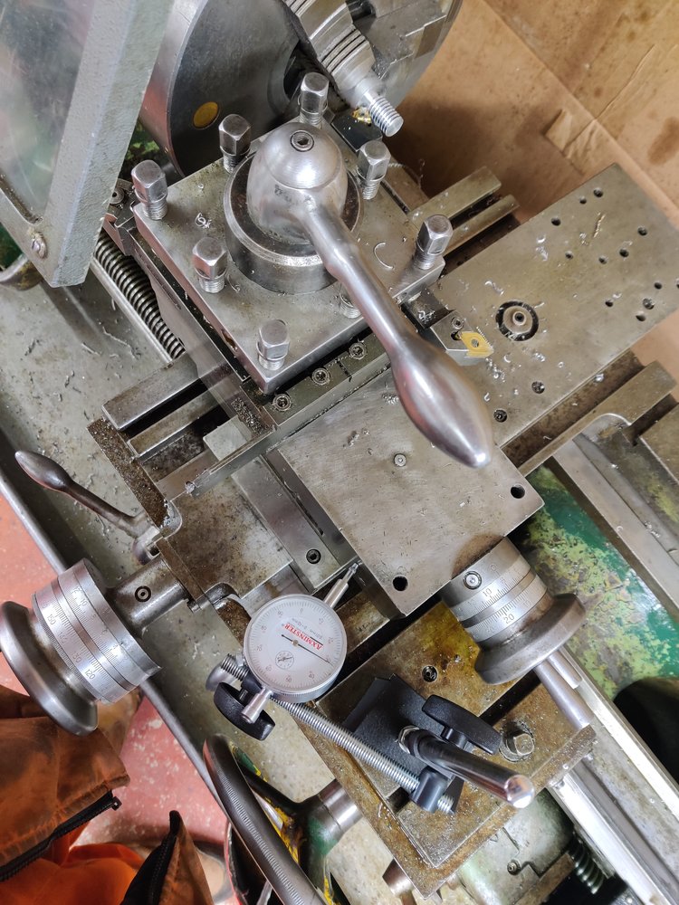

Apparently you should set it for 29.5 degrees to avoid rubbing altogether.
Just to clarify, it has to be less than half the angle. Typically 0.5°-1° less.
I found this with a nice explanation and diagrams why it has to be that as well as why feeding straight in "works" if you have a decent unworn lathe but could cause a taper or wandering thread if it is worn, not as stiff or it pushes the workpiece out of alignment. https://rick.sparber.org/spt.pdf
So 29°-29.5° for a 60° metric and UN (UNC/F) threads, 26.5°-27° for a 55° imperial (BSW/F etc) and (~22.75°-23.25° for the 47.5° BA )

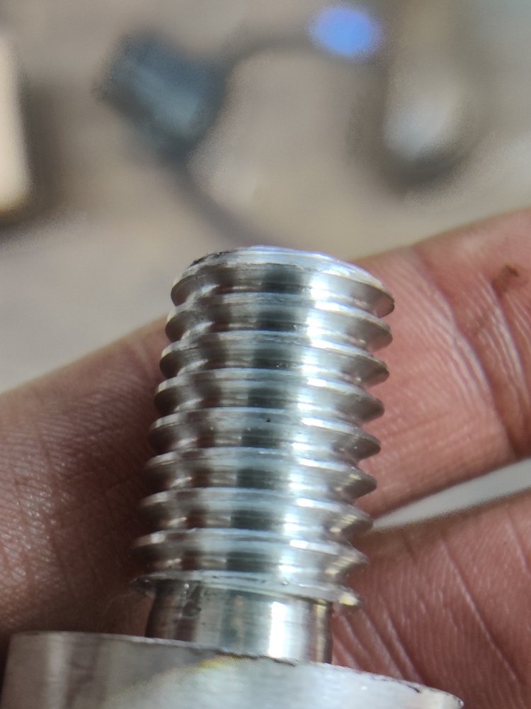

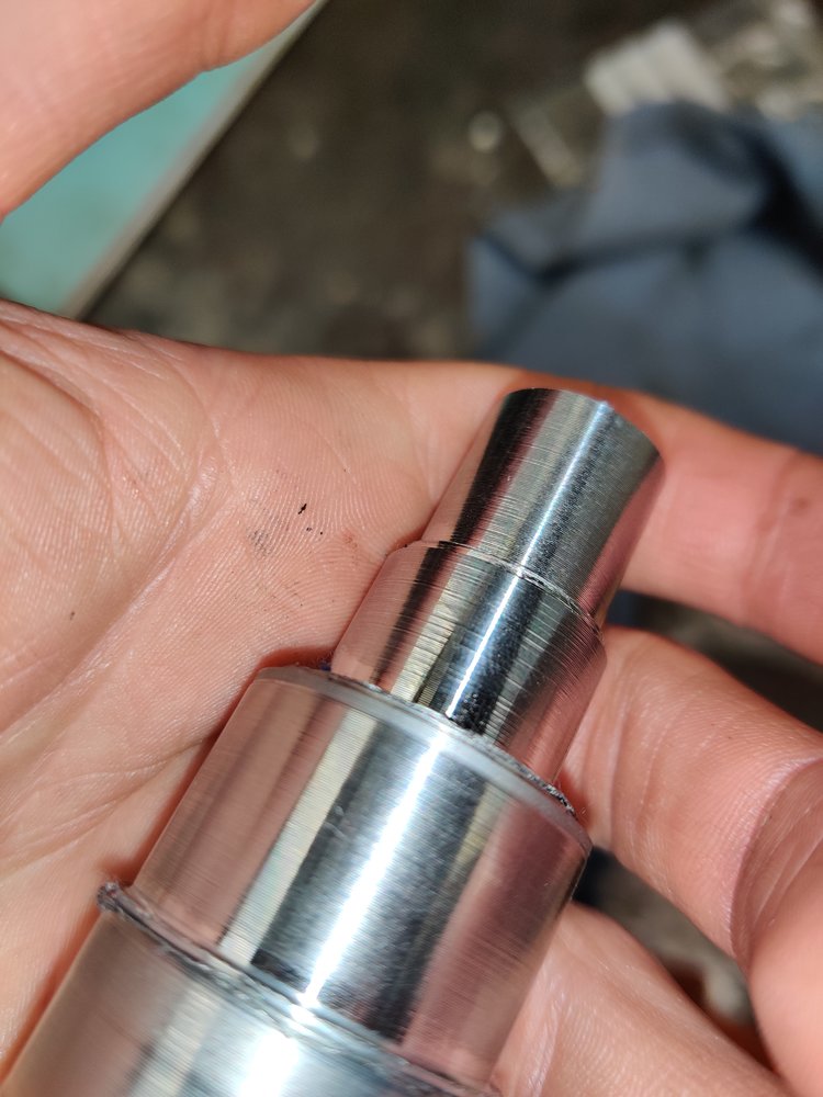

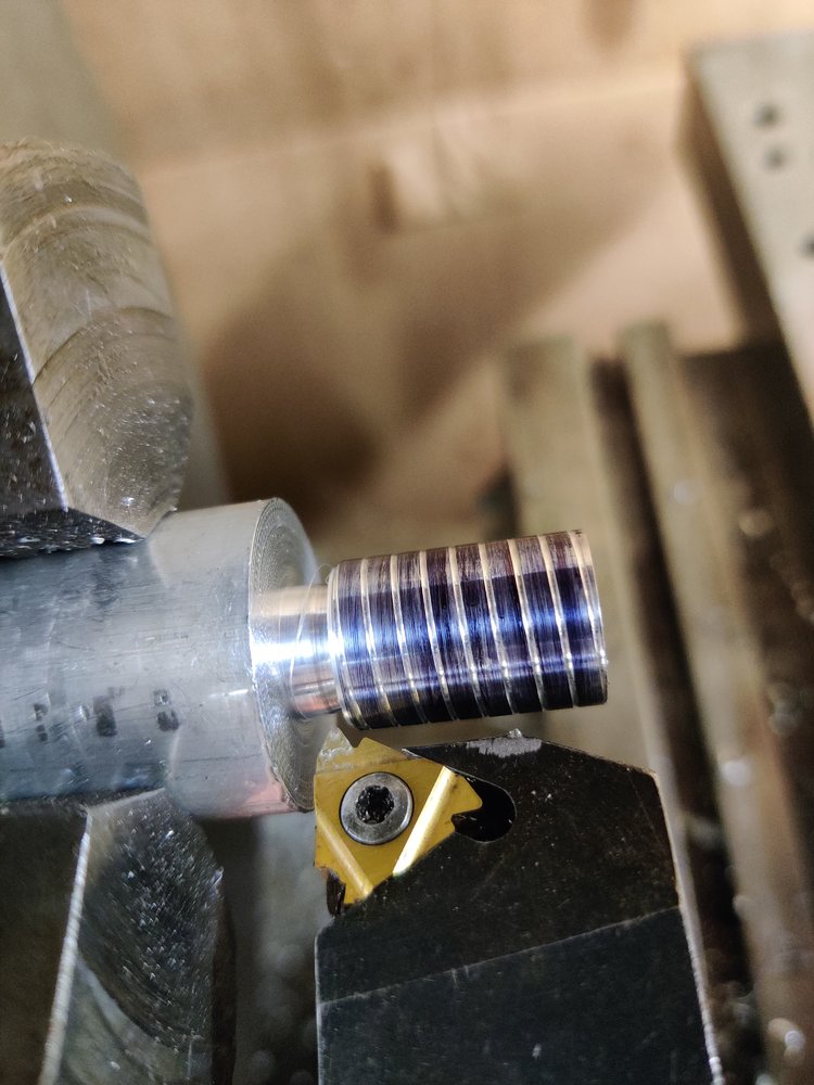

, Still working to fix the lines but getting there also need to try fizzy's recommended tools for aluminium but using what I have now this is the best.
Threads look good!
