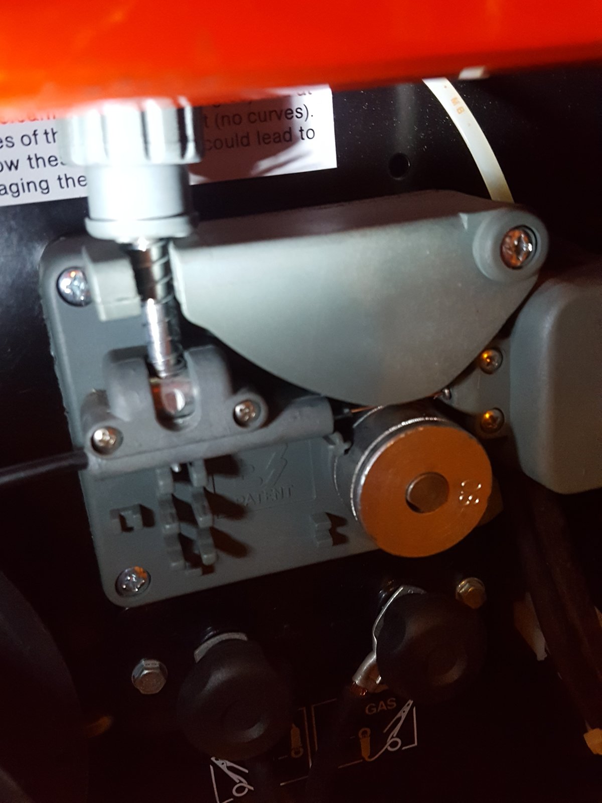

any one got a pic of there clark welder wire feed ?
I will agree on that one I had a Clark for many years but it has moved to pastures newcLooks like it’s missing the washer that holds the spring from going through the fitting, it’s the spring that puts the pressure on, not the screw, the screw is only to increase or decrease the pressure, that way it gets an even pressure even if the roller isn’t round.
the liner was clean but changed it any way not easy not hard but had to take apart a good part of the case it was a metal liner i think the unit has done more work than it looks like
