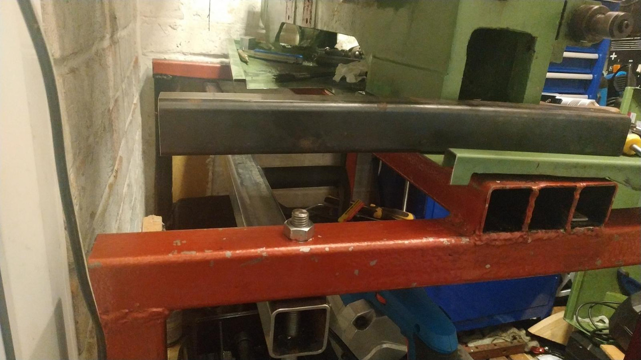

I'll have to grind key down.
About to do first test with the lathe on the 1:1 pulley - have not splined it yet so I will be carefull.

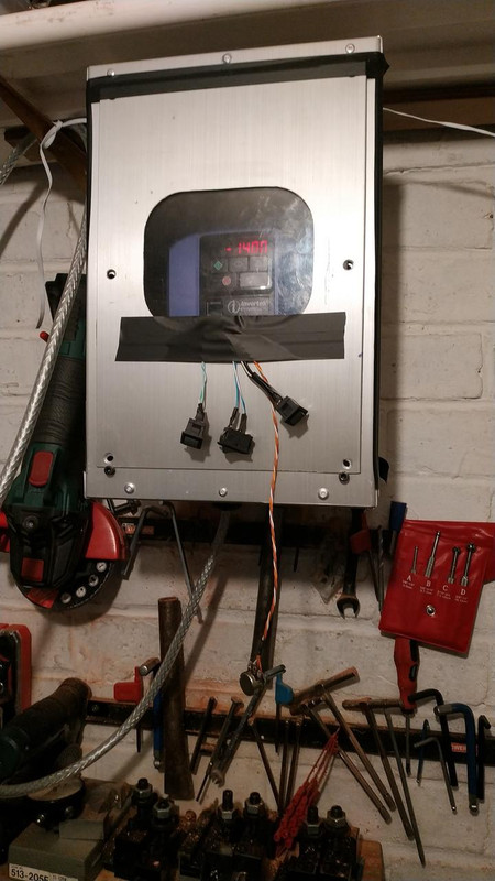

Anyone have experince setting up optidrive inputs? The options seem quite limiting and it will not read the motors theemistor, only use it as a trip, so instead I will get a cheap led display for that. Might have to use an arduino to give more options.

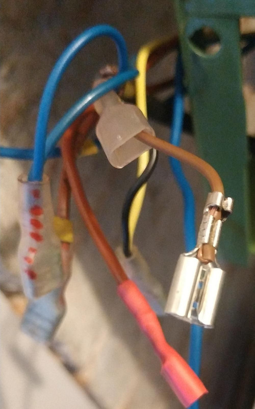

Wiring it up with inputs as:
Enable
Direction
E Trip
Speed adjust
https://inverterdrive.com/file/Invertek-Optidrive-E3-Manual
Page 32 if anyone wants a look.
Still need to make up front panel with clear for screen. Nut inserts have not arrived (I ordered wrong type for plastic, but should be ok for this.)

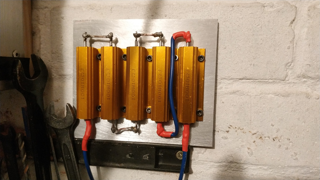

Might order a brake resistor, unsure if its useful on a lathe?
