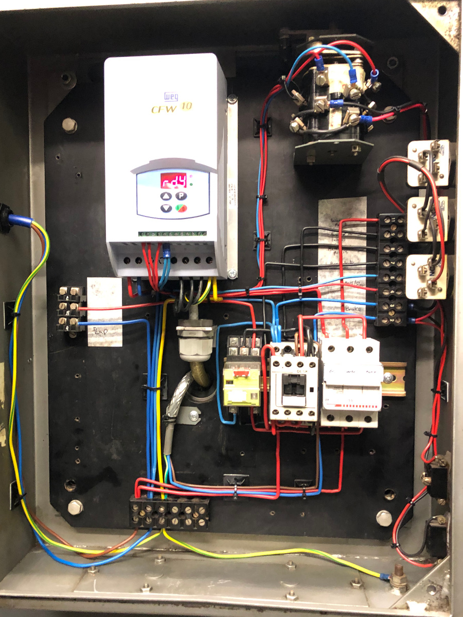

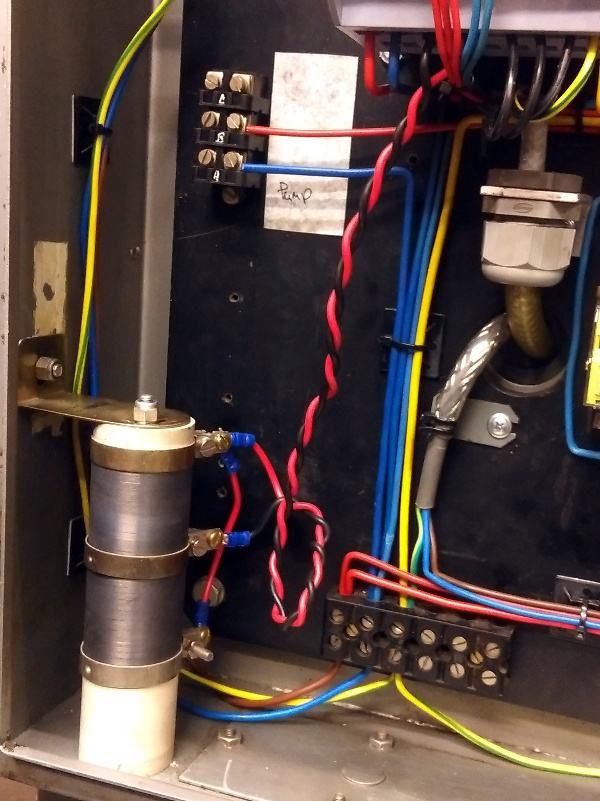

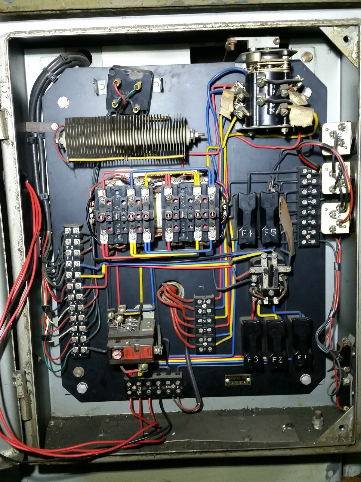

I've spent all day today removing the old electrics from the cabinet on my HLV and fitting it out with a VFD and modern relays etc.
Here's the original cabinet, with fwd/reverse contactors, overload, pump relay, a myriad of fuses and the rectifiers for the DC traverse motor on the carriage.

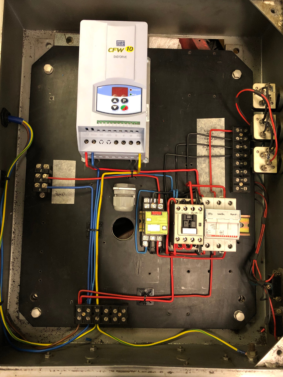

And here is where I've got to with fitting it out to run from a VFD:
So I've got power coming into the bottom left corner feeding the main contactor and the NC stop switch via the red wire though a 2a fuse (no2). Top button pulls in the main contactor which feeds the VFD via fuse no1 and the pump contactor via fuse no3. The second button pulls in the pump contactor and both contactors latch themselves on so losing the power or hitting the stop switch drops either or both of them out.
Tomorrow I have to do the control circuitry but right now can anybody see anything obvious that I should (or shouldn't) have done with the power circuitry? (I know the yellow earth wire is wrong but I don't have any heavy enough yellow/green just yet).
