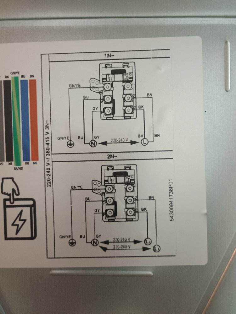

Gave up on trying to fix the old Electra Elecheib induction hob and bought a Bosch. No problem there. The old hob was fed from a length of 4mm² butyl.
The new Bosch can be fed from one or two phases.

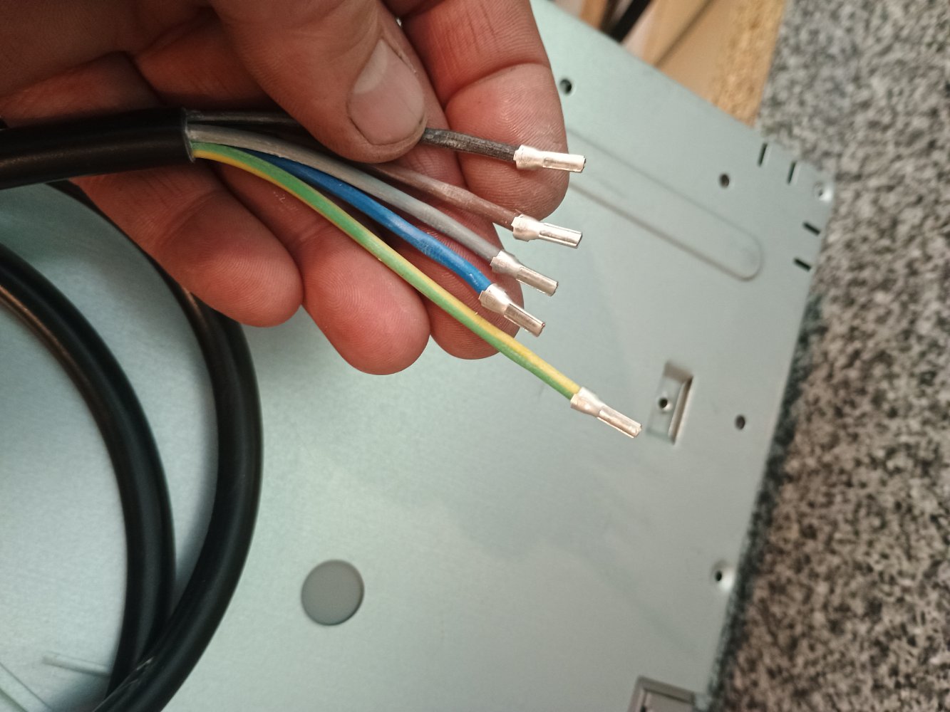

It comes with a length of this cable:
So they are suggesting to use this length of cable for single phase operation and just wire the cables in parallel.

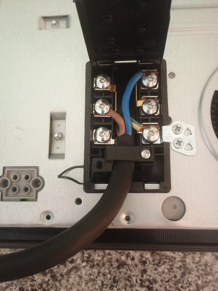

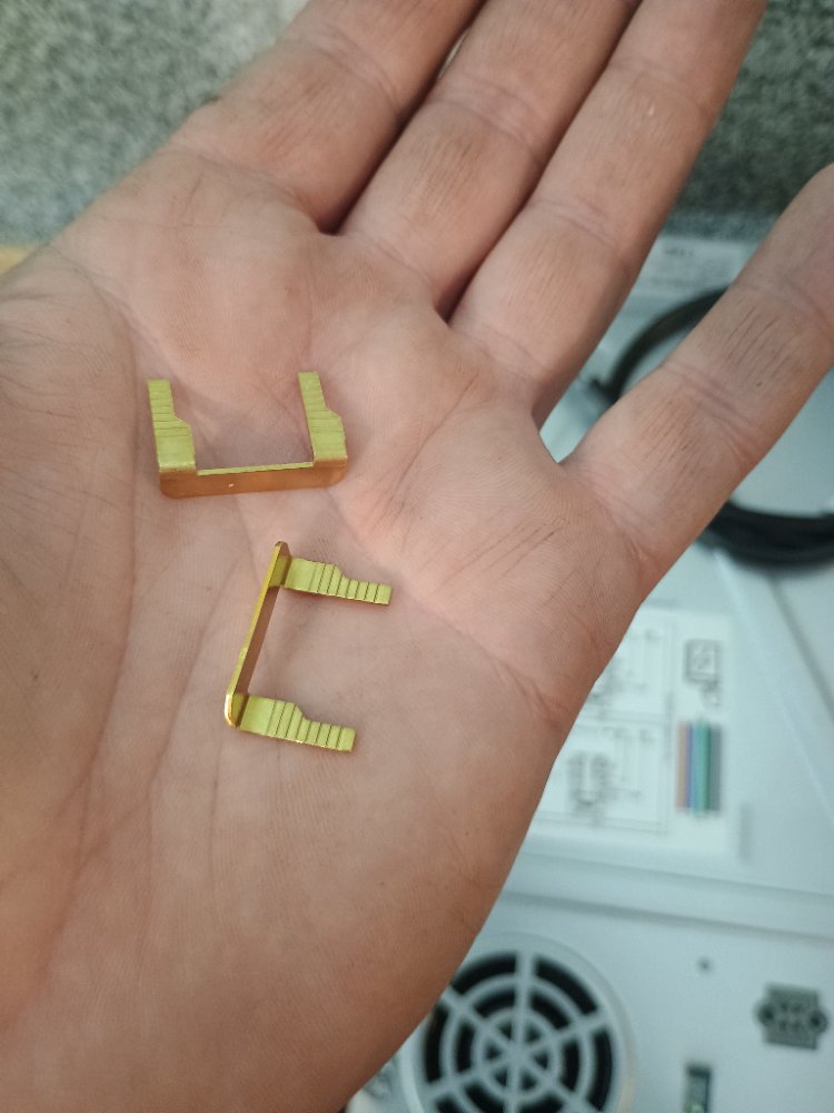

However....up top in the terminal box are two brass links. Doing nothing, just sat in a "made for it" plastic slot. They look to be about 4mm². There is however no reference to them in the manual?
I can see no reason why I can't use the original 4mm² cable and then use the links in the terminal box to link 2+3 and 4+5.
