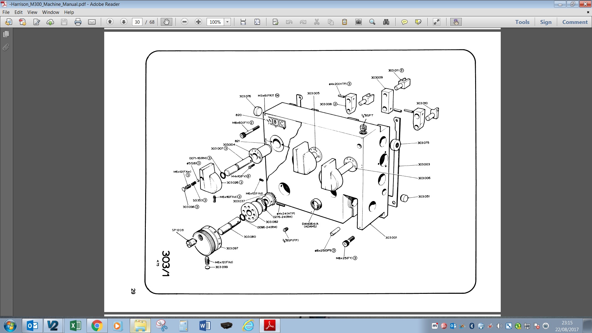

Hi MK, do you know what holds the top of the compound slide on? Taken everything off that could stop it coming free but it doesn't want to let go!
on to what? The crosslide? 2 nuts and a pin in the middle, should just pull off. If you mean the top slide loosen gib strip, and wind it off the lower base, note the protractor and base are one.
hth
You can't just wind the top of the compound off since the nut hits the top casting...
First remove leadscrew (two hex bolts and wind it out)
Then loosen grub screw (front end face of lower section of compound) holding nut in place.
Now push nut down into lower half of compound and slide top section of compound off.
That's the way I did it...you may be able to remove top section of compound after removing leadscrew by removing gib strip and 'unlocking' dovetails but I'm not sure there's adequate clearance.
