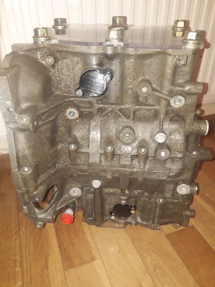

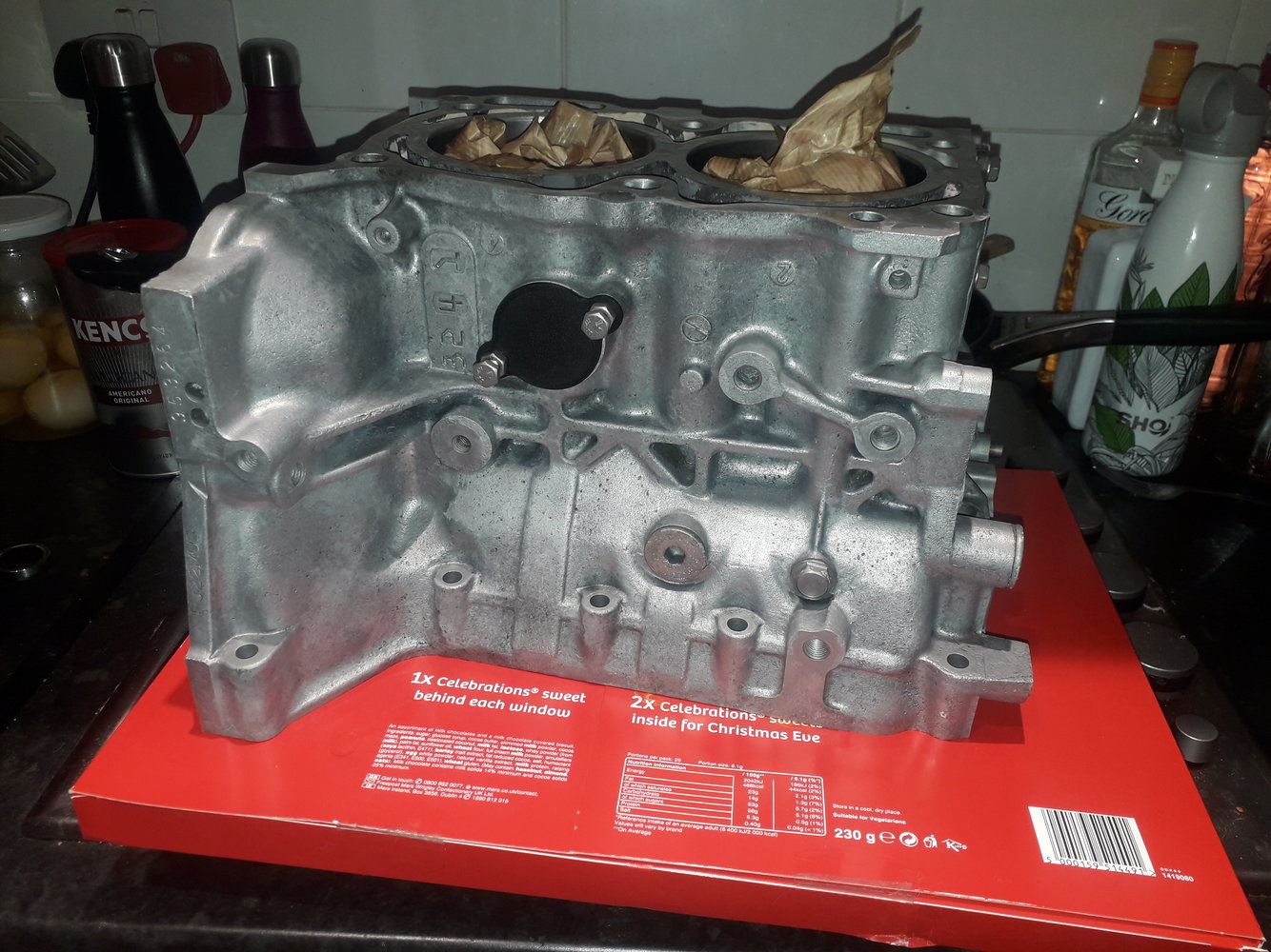

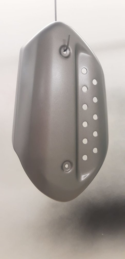

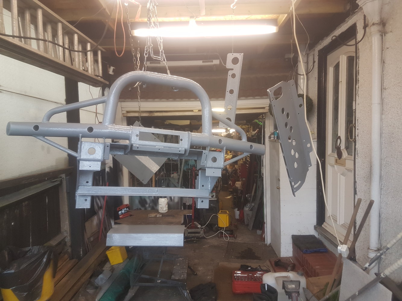

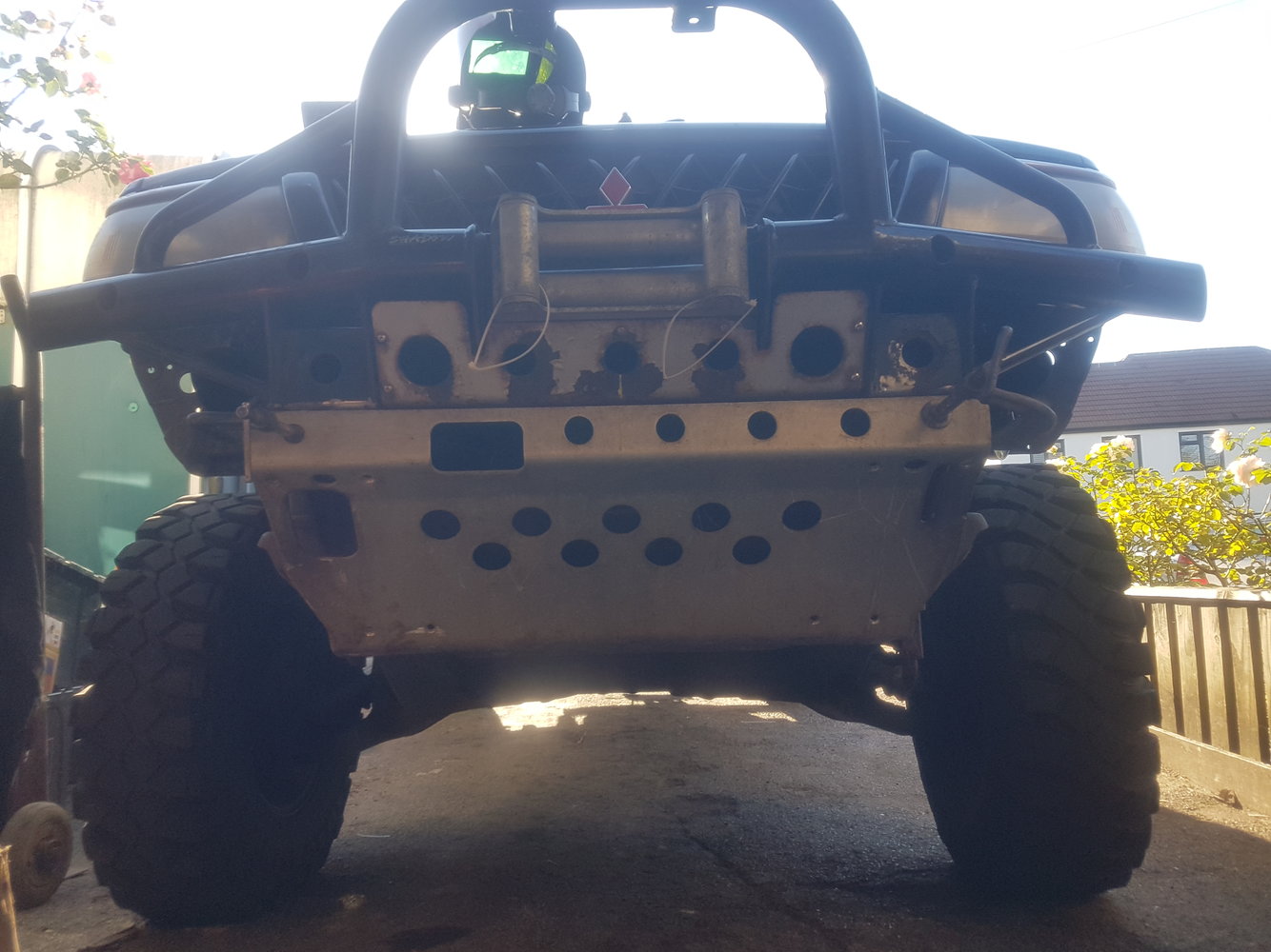

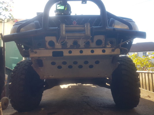

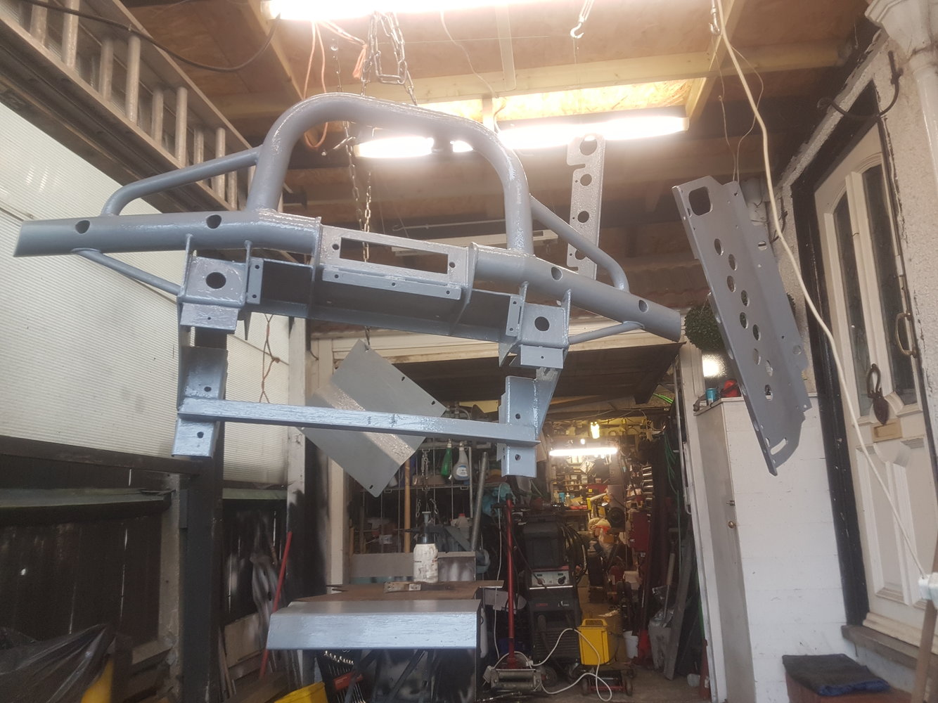

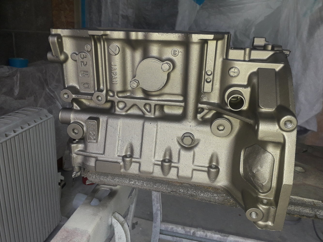

Started to use cerakote paints.
Work really well on blasted surfaces.
Did my engine block and came out a treat.
Before blasting, after blasting, and painted one coat
View attachment 309870 View attachment 309871 View attachment 309872

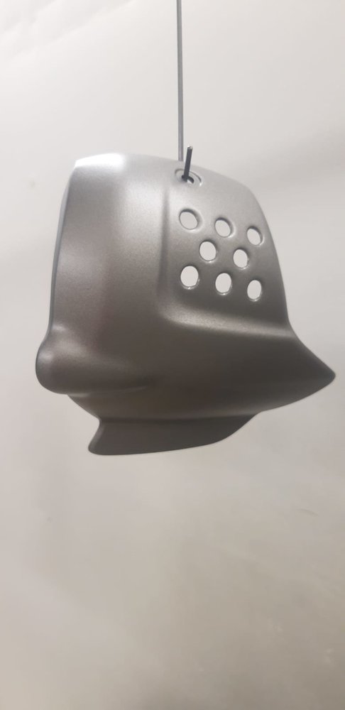

It gives a lovely finish - how hard wearing is it? How scratch resistant?Here is the c-sieres gun metal also
Which I think you might like.
View attachment 309886 View attachment 309887

Yep c-105 titanium
Single pack air dry, worked well.
Got some more colours here to do more bits
Got it from cerakoteuk,
Dont get me wrong it's not cheap stuff.
But I we only used 30ml to paint the engine block.
It's a ceramic coating so much thinner than most paints.
Have a look on youtube/instagram for pictures and reviews.
It is suitable for quite impressive temperatures also (lots of people using for firearms in the us)
