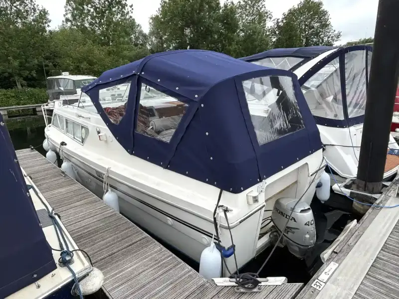

Does the steering move the whole outboard motor, or just the rudder?
If the outboard is hanging off the back, it'll probably move the whole outboard. If the outboard is in a 'well' it might be fixed and the boat steered with a separate rudder. I'd suspect the latter with that style of boat, but nothing hard or fast.

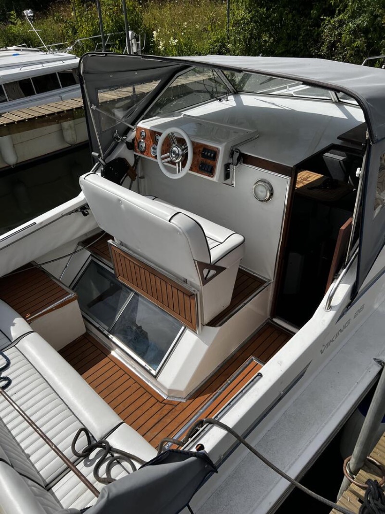

Photo of a different Viking 26 - Outboard is hanging off the back, so steering will turn the engine (on this one, at least).Thank you, a voyage of discovery then.

There speaks a voice of experience!Photo of a different Viking 26 - Outboard is hanging off the back, so steering will turn the engine (on this one, at least).

If it has an outboard then that is your steering, the steering moves the outboard, there will be no rudder, notchy steering is a partial seizure in the cables, could be an easy fix or new cables, if it’s new cables I’m sure you could deal with that.Had a little play today and it isn't bad. However the steering is notchy, stiff and has free play. I'm told it is cable operated so maybe a new cable will sort it. I know little about these but I do know that it should be smooth.
