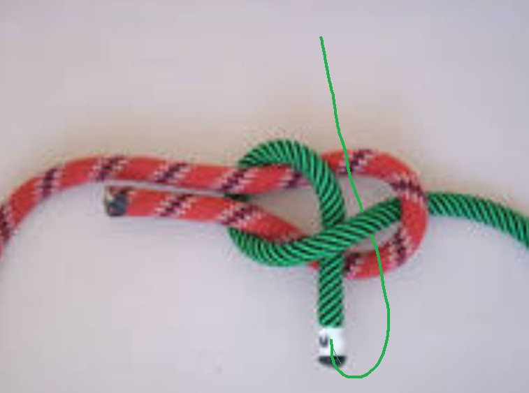

Thats exactly what I do when I open bales and dont use it all.This is what I am meaning, taking the pic of the sheet bend posted above, if you put the loop through rather than the end of the rope you will be able to slacken by pulling the tail.

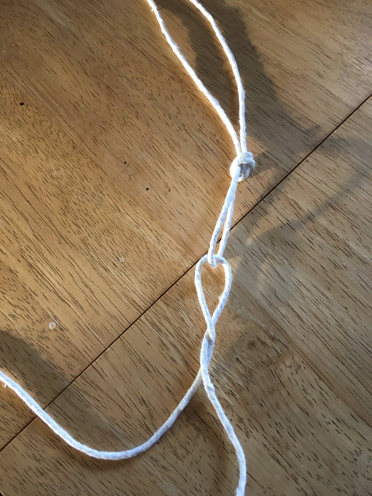

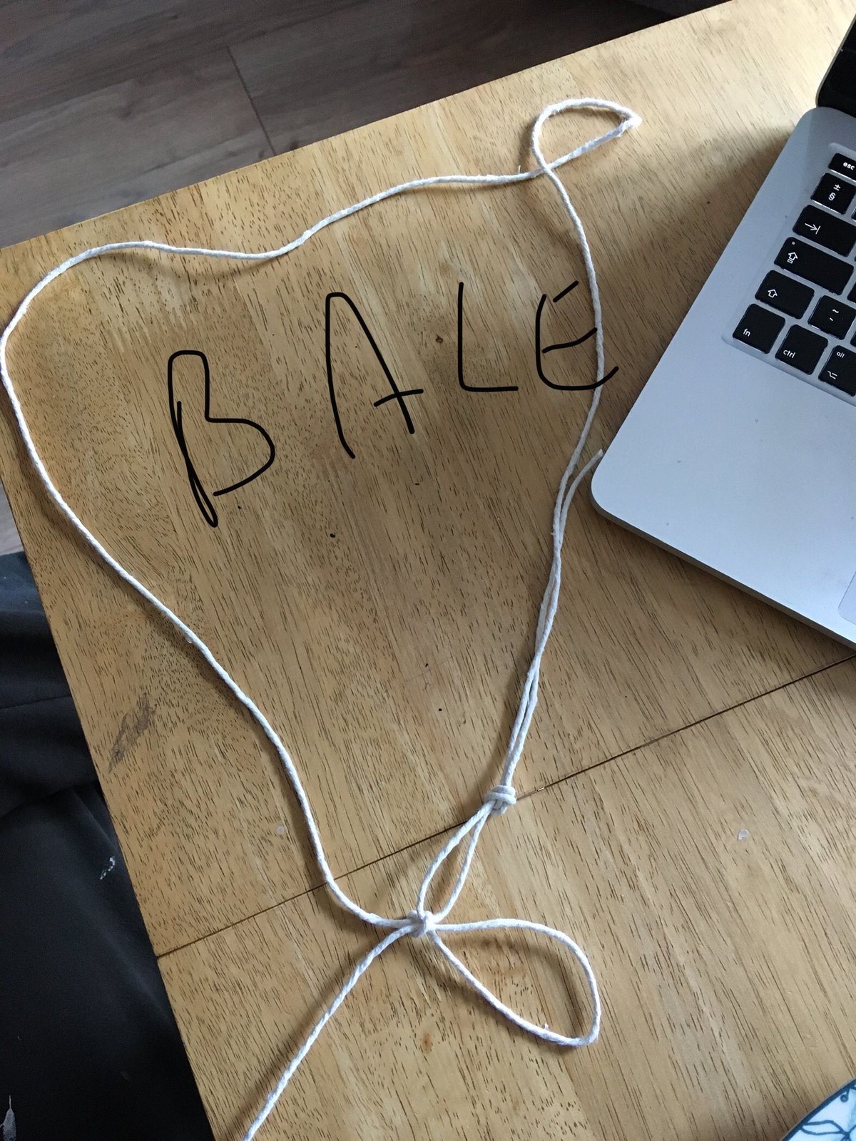

You pull the end at the bottom of the pic which releases it but leaves the rope through the overhand loop like a pulley so everything is still tied, let the end through the loop to slacken or pull to tighten, retie the not with a loop.
Very difficult to explain in words, very simple in use/skill to tie.
Untied leaves you with this which still holds everything together if you've got hold of the slack end.
