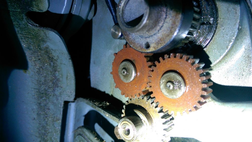

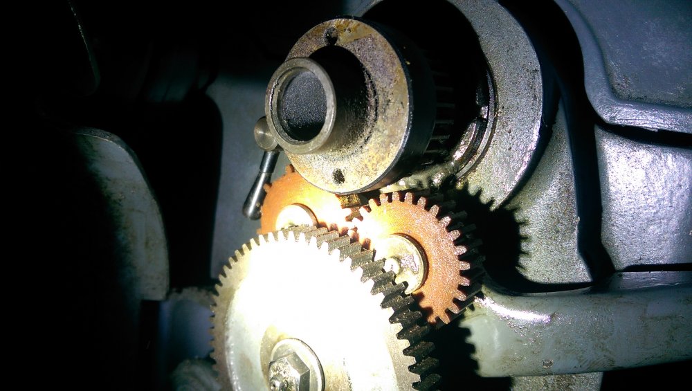

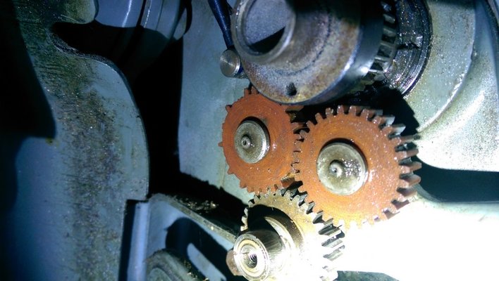

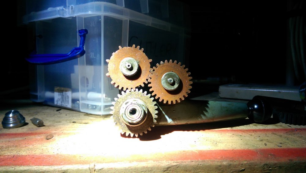

I bagged my self a super 7 the other week, the only issue with it being the tufnol 30t gear had stripped on the lead screw tumbler , I rreplacedthem both with a pair from myford, pressed the studs in with about 1/1.5 mm free play as not to nip them, however I span the lead screw on the hand wheel and its stripped the 30t again. It did seem particularily tight too, with a fair bit of gear chatter. Any ideas?
