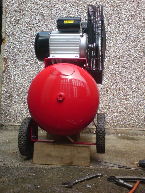

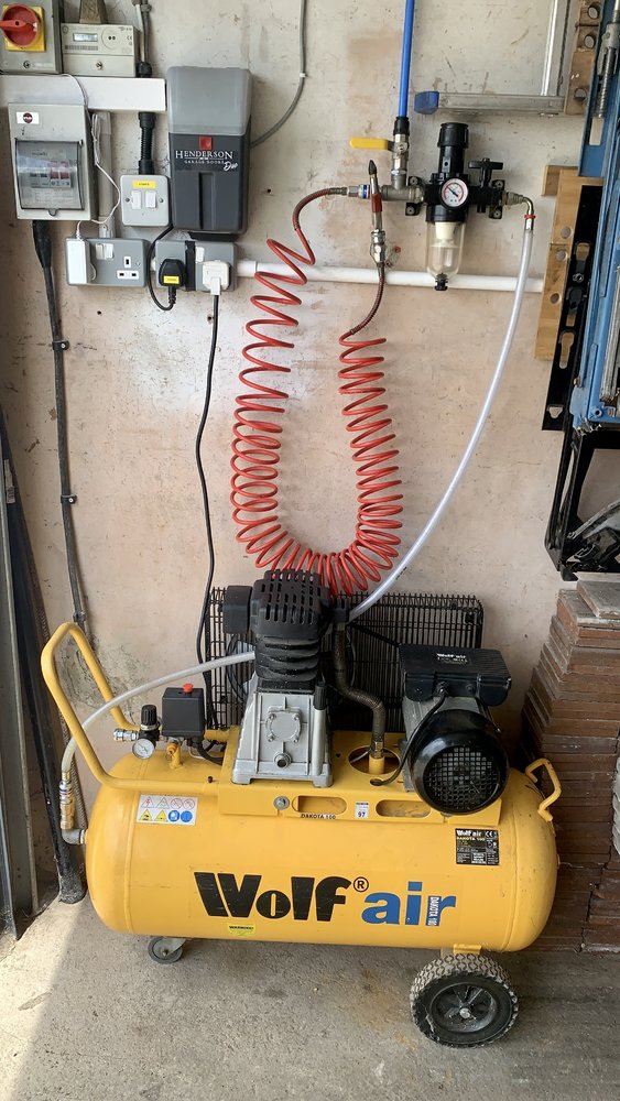

I did a similar revamp to my compressor recently but also added a precooled , basically used a generic oil cooler and AN10 hose and fittings put between pump outlet and main tank and situated so the air flow from the motor cools the rad...... huge difference in temperature between the inlet and outlet on the cooler and far less water in the tank.
