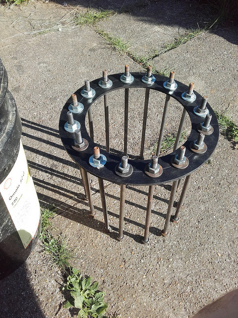

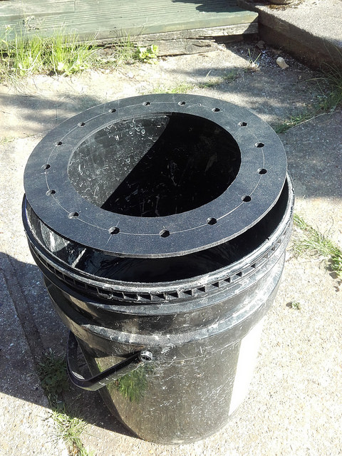

Onoff In the land of the unfinished project I am King! Messages 13,593 Location Sevenoaks, UK Jun 1, 2017 #141 Work in progress:

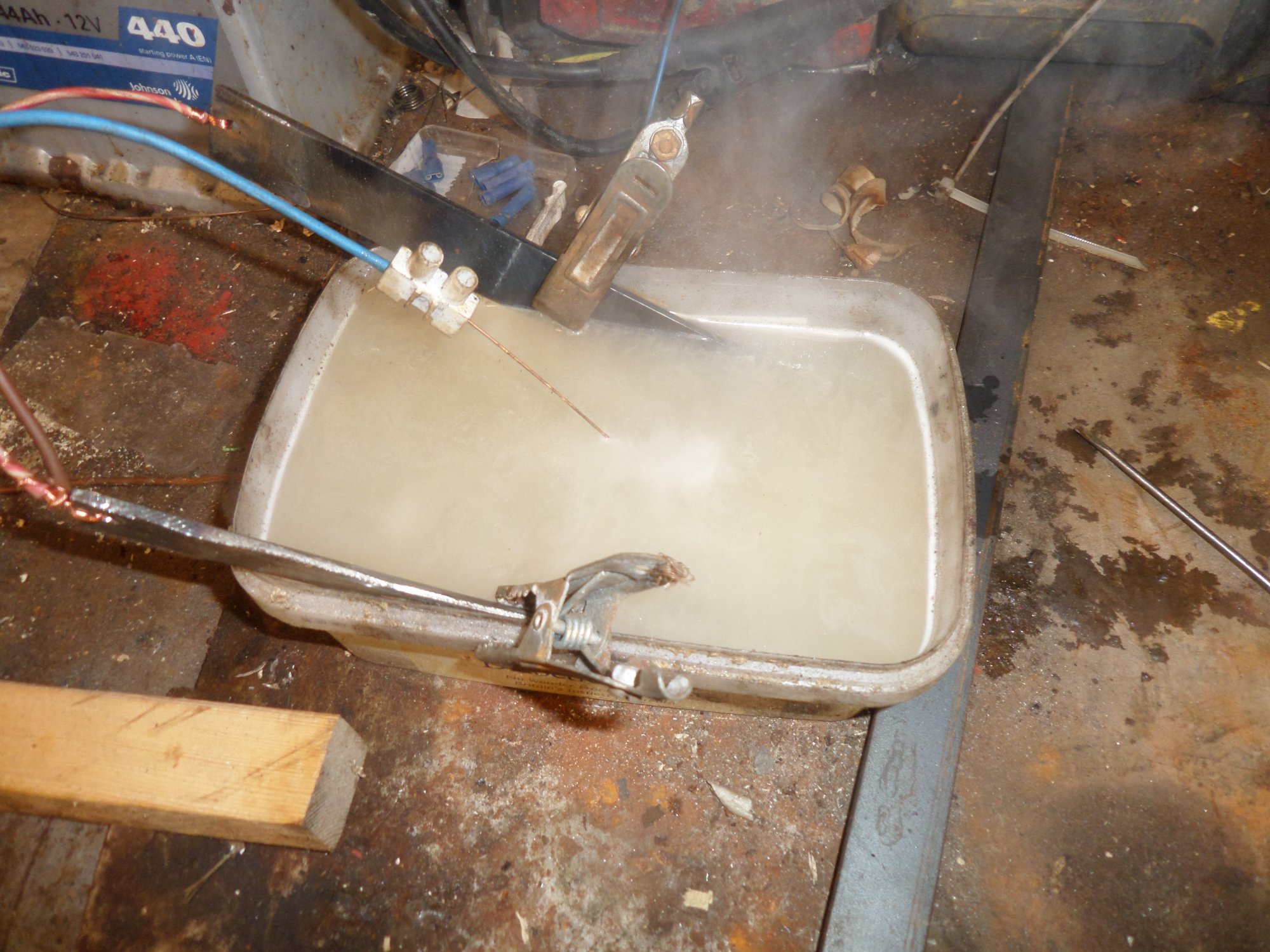

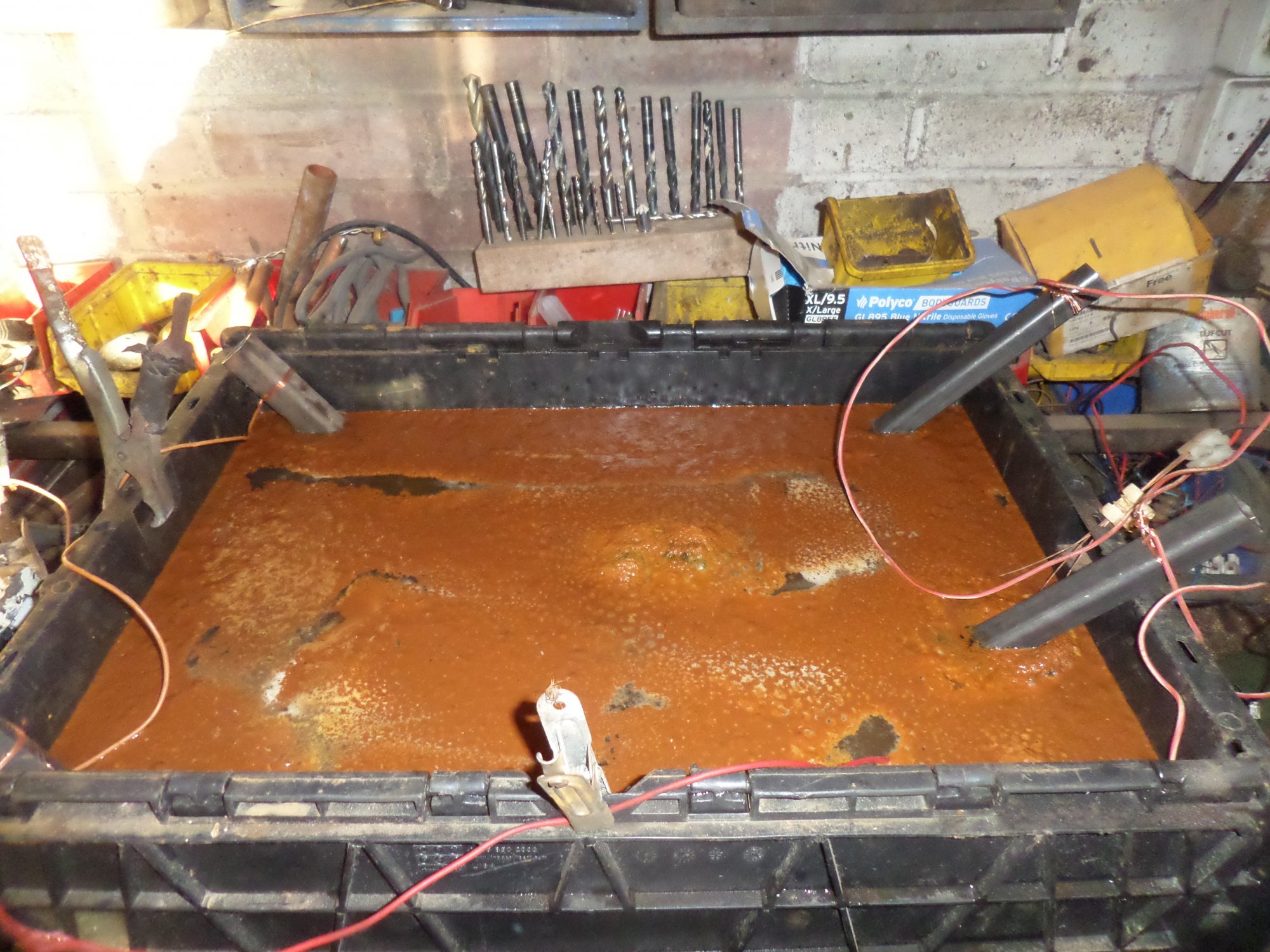

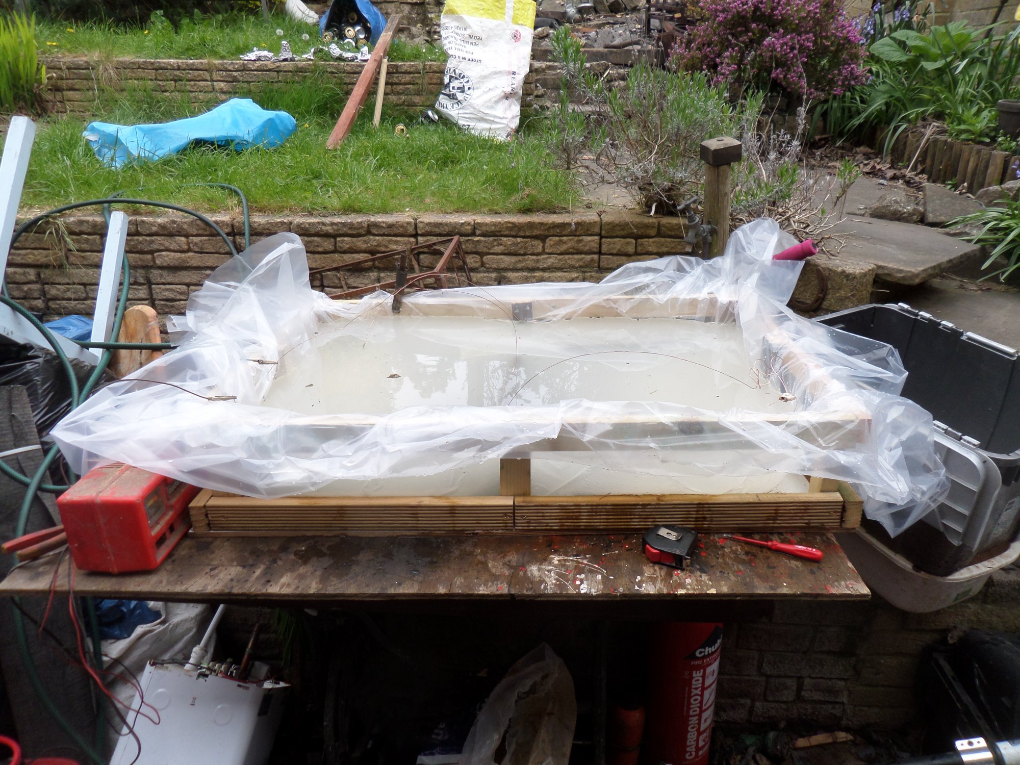

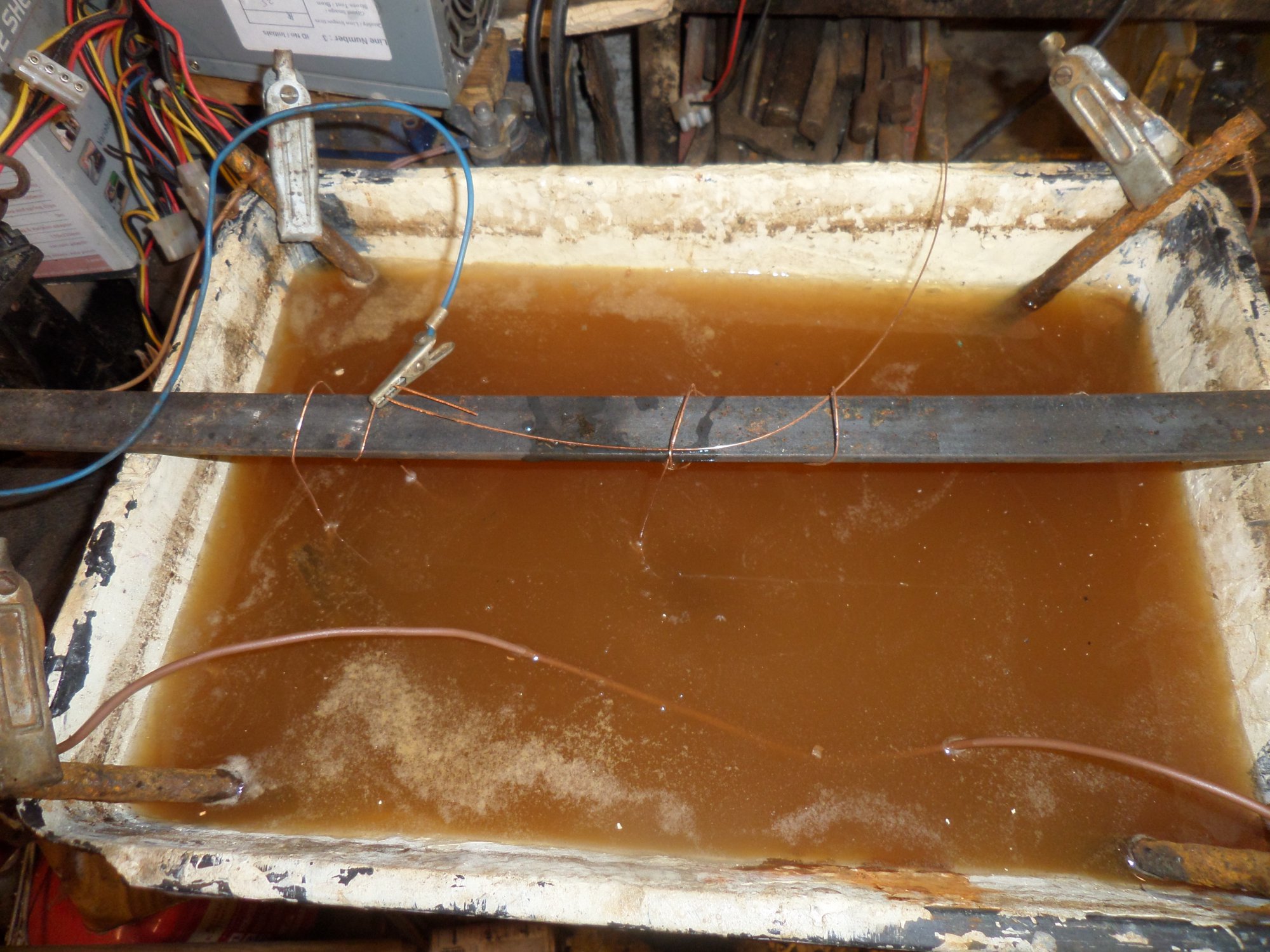

The_Yellow_Ardvark I'm a citizen of Legoland travellin' incommunicado Messages 20,340 Location Going Away. Jun 1, 2017 #142 One of my many tanks, Chinese's take away container. Or a paint bucket. A recycling box. A de-rusting tank does not have to be anything special. Or scarp wood. It can be anything what fits what needs to be de rusted. Lots of surface area for the anodes, decent power supply and time. Life is best when you keep this in mind. K.I.S.(S). Last edited: Jun 1, 2017

1 123hotchef Member Messages 14,363 Location Kent Jun 1, 2017 #143 Onoff said: Work in progress: View attachment 110556 View attachment 110557 Click to expand... it looks great!
Aerohead Member Messages 160 Location UK Kent, USA, Deutscheland Jun 6, 2017 #144 That should work well Onoff, though occasional rotation of the item being stripped can provide similar results.
