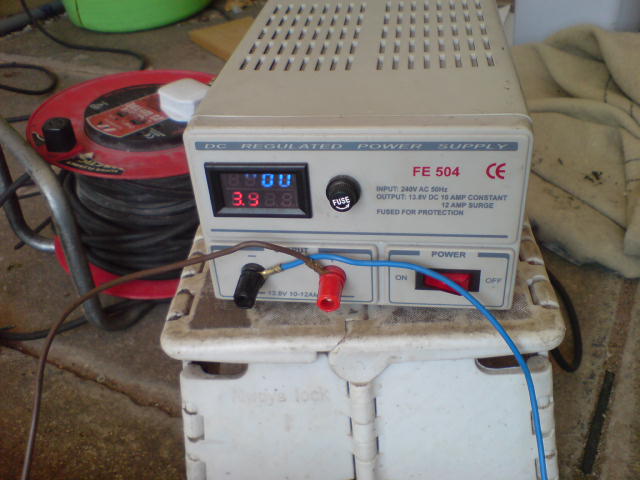

Ok why with the stronger solution and a smaller work piece and anode did it only draw 1.5 amps?
My PSU was happily delivering 3.5amps in the bigger tank after I diluted it by 30L but it did get hot as it is only ratted to 3amps constant with 5amp peak
