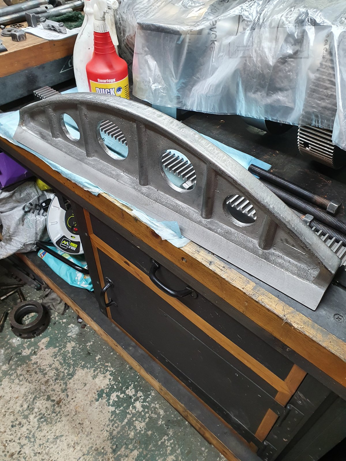

I use a stone on the little bruises. And a semi blunt file for the main de burrAre you using stones to deburr the gears?

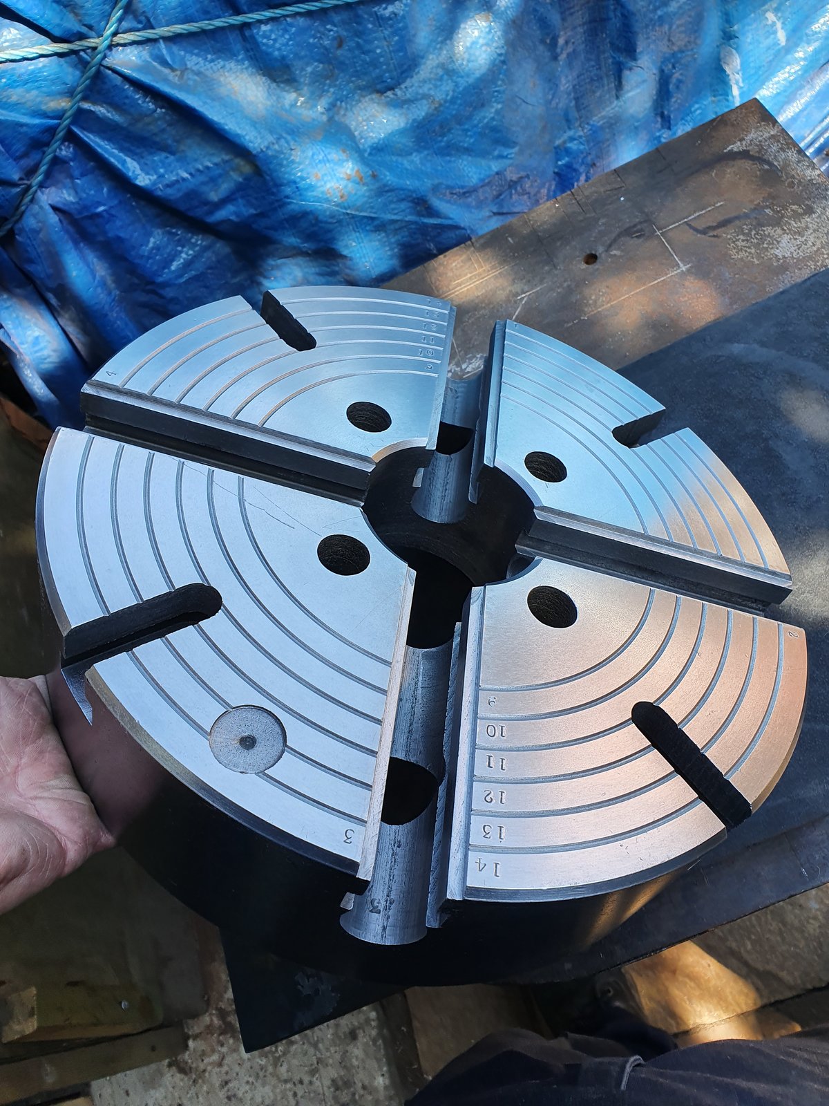

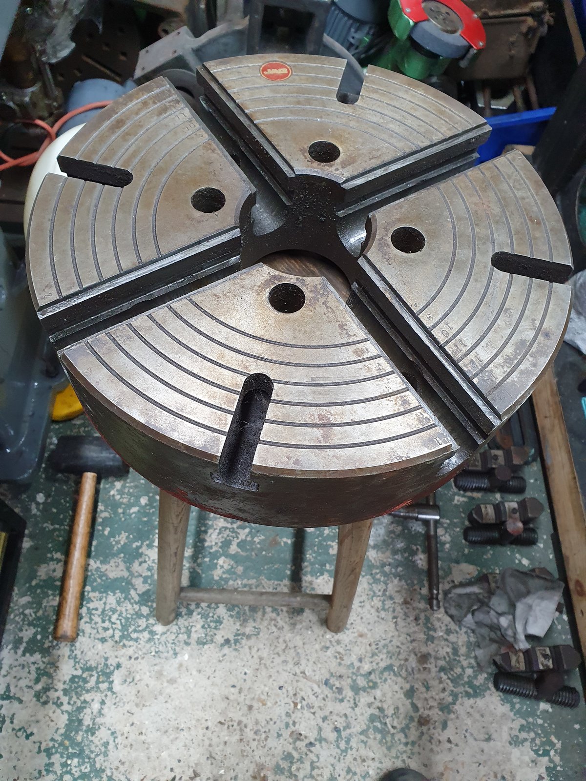

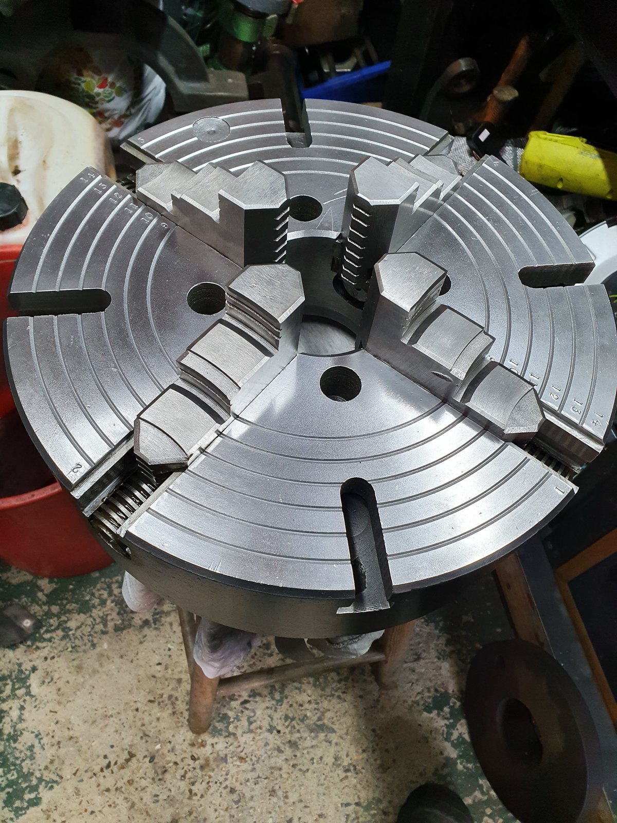

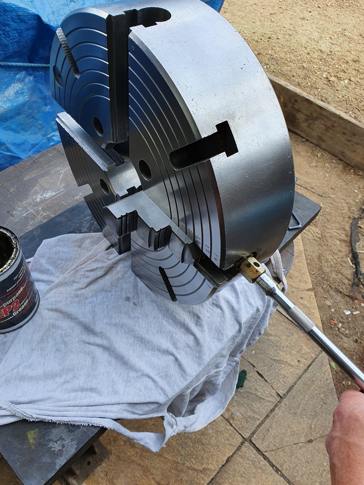

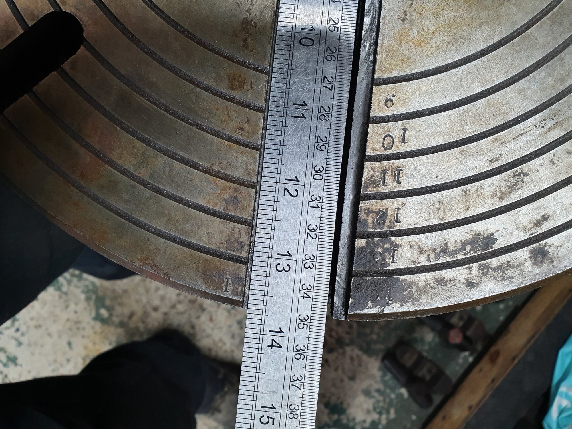

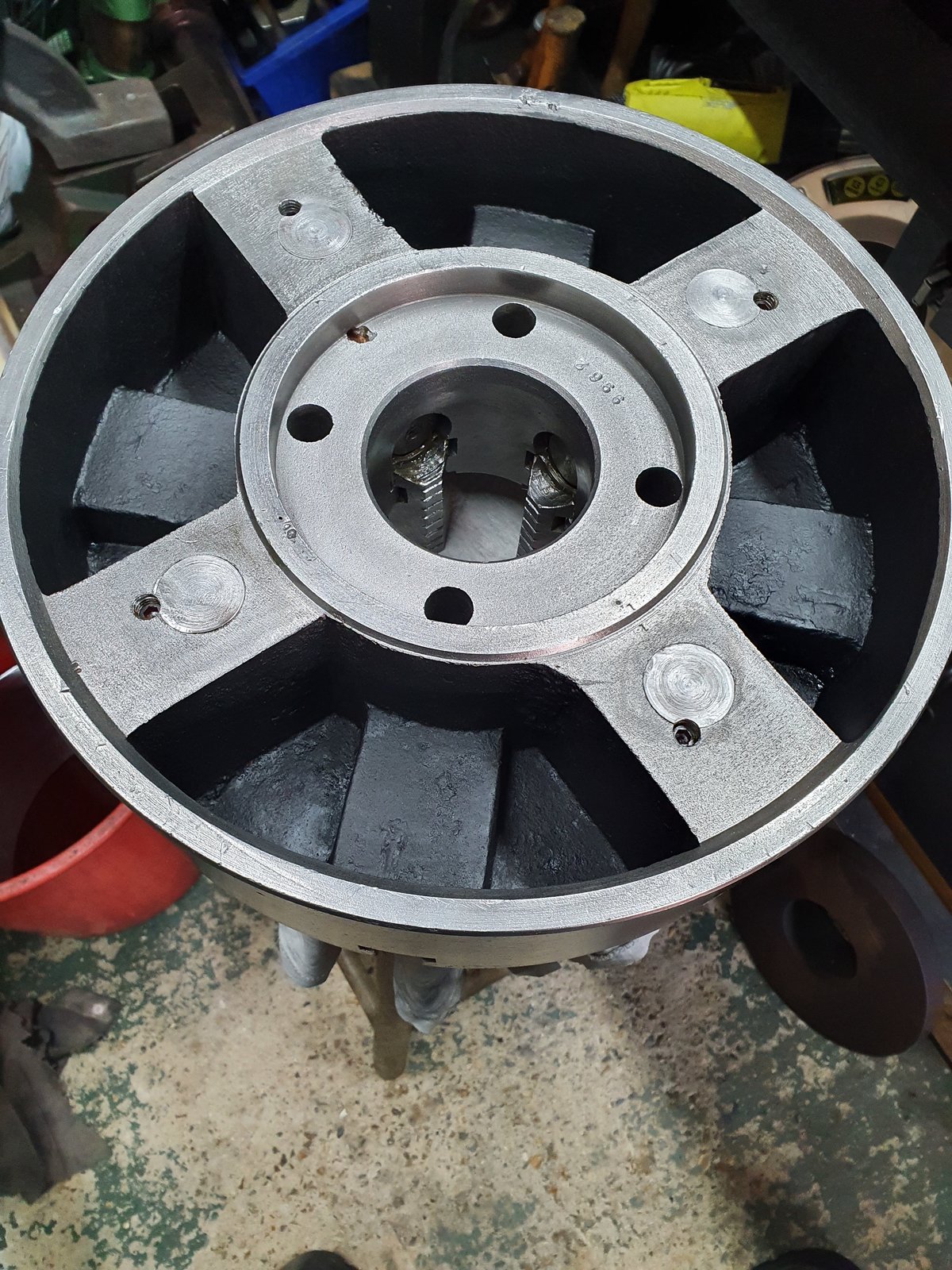

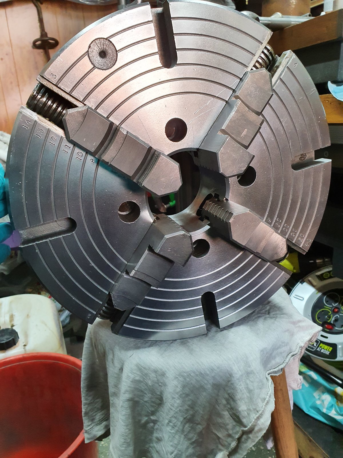

Four days of work restoring this 350mm diameter four jaw chuck.
this one will be for sale in the for sale section shortly.
YesT slots for work holders? Clamps?

Four days of work restoring this 350mm diameter four jaw chuck. Chemical cleaned. All surfaces have been lightly stoned and a full de burr .the jaws have had a de burr. The jaws have been re seated to the matching ways...this one will be for sale in the for sale section shortly. View attachment 230964 View attachment 230965 View attachment 230966 View attachment 230967 View attachment 230969 View attachment 230970 View attachment 230972

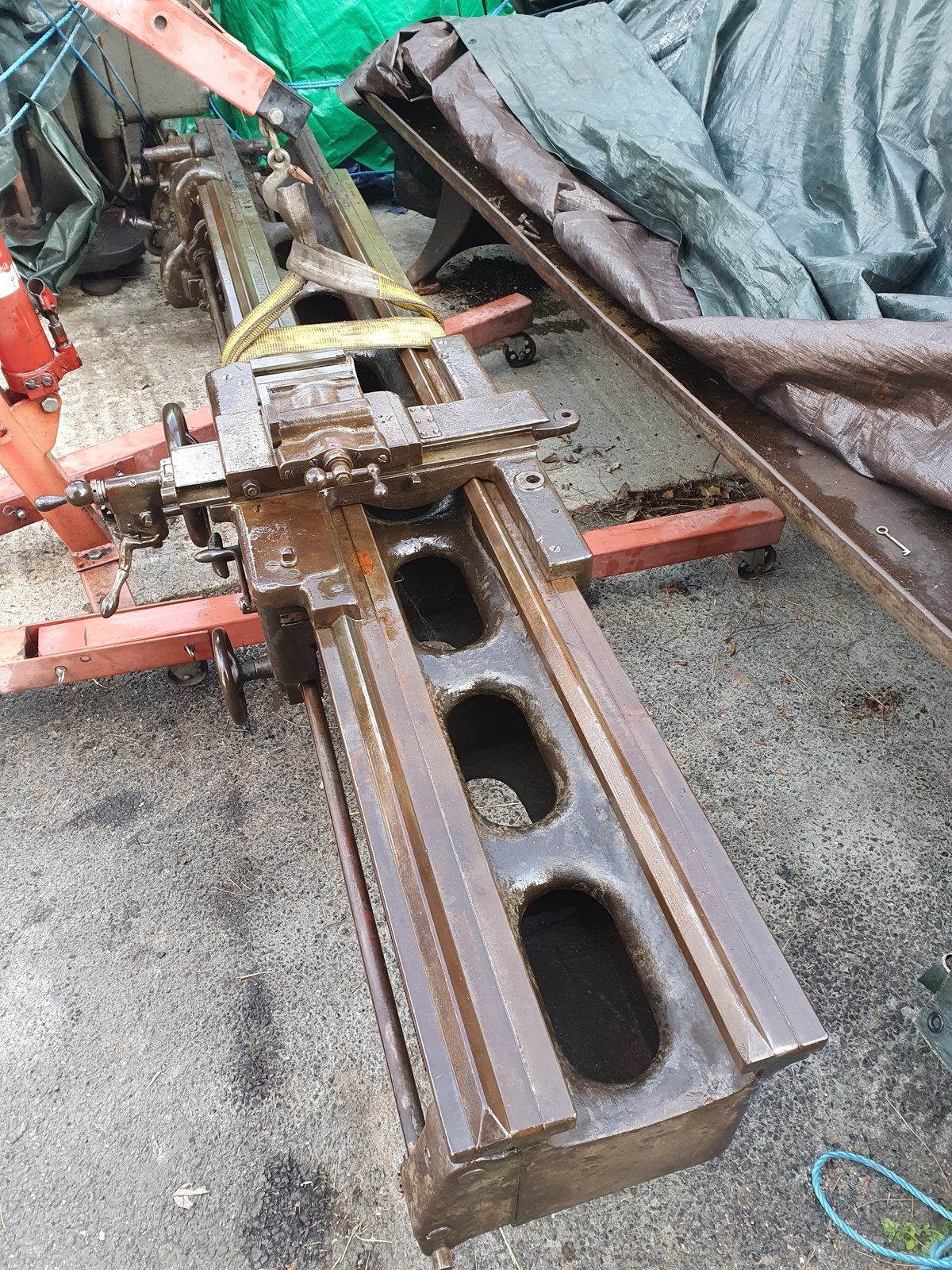

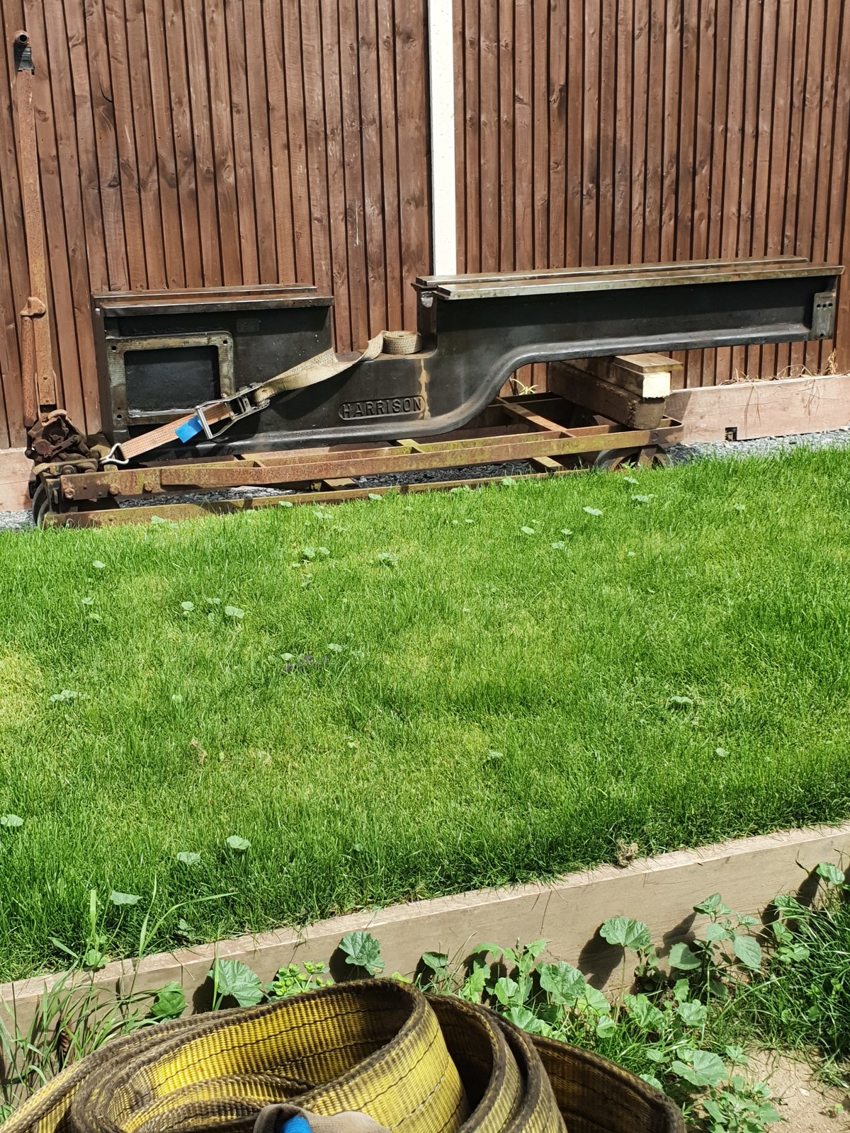

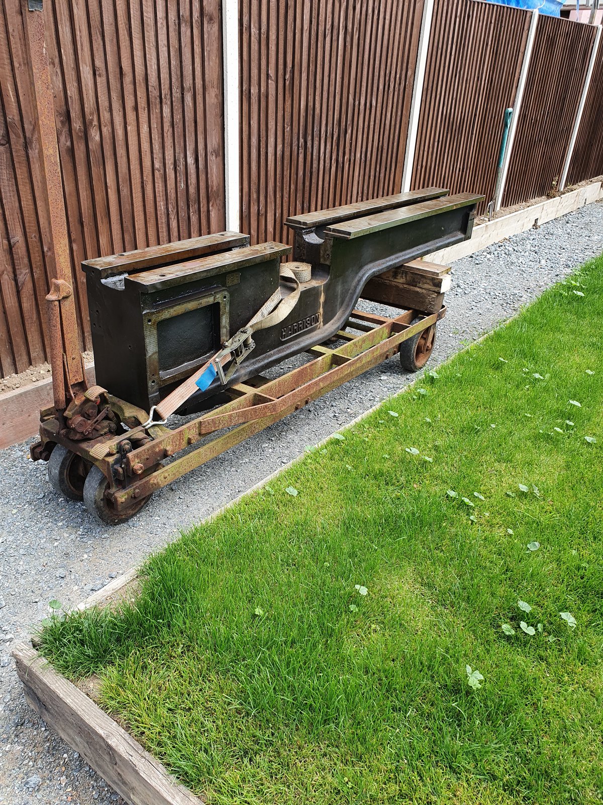

It's in good condition given its age. There is wear on the bed but have seen a lot worse. She is a big lump and look forward to restorations.I saw the Pratt & Whitney on ebay and sent the seller a message about delivery but couldn't arrange anything. I was surprised at the original equipment that was with it. The lathe didn't look as if it had much use, A real class machine, I'm pleased it went to someone who will appreciate it's quality.
Me too.It's in good condition given its age. There is wear on the bed but have seen a lot worse. She is a big lump and look forward to restorations.
