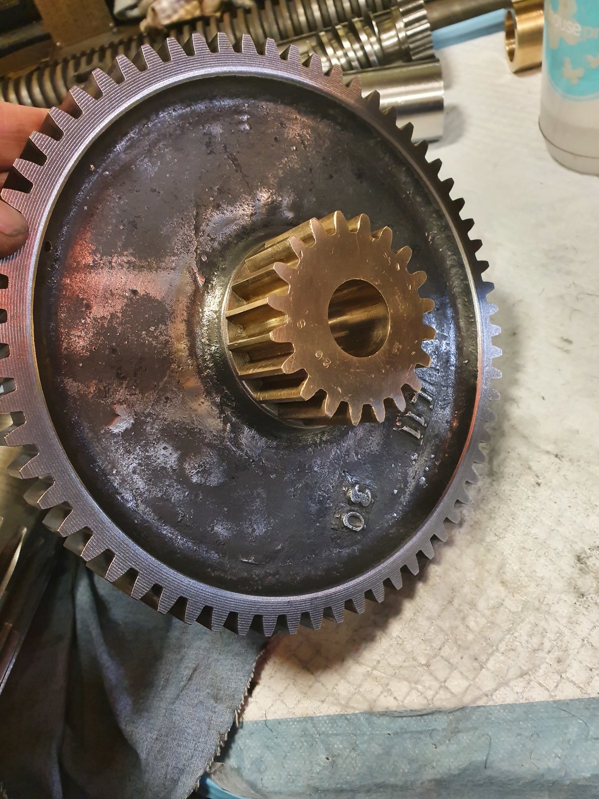

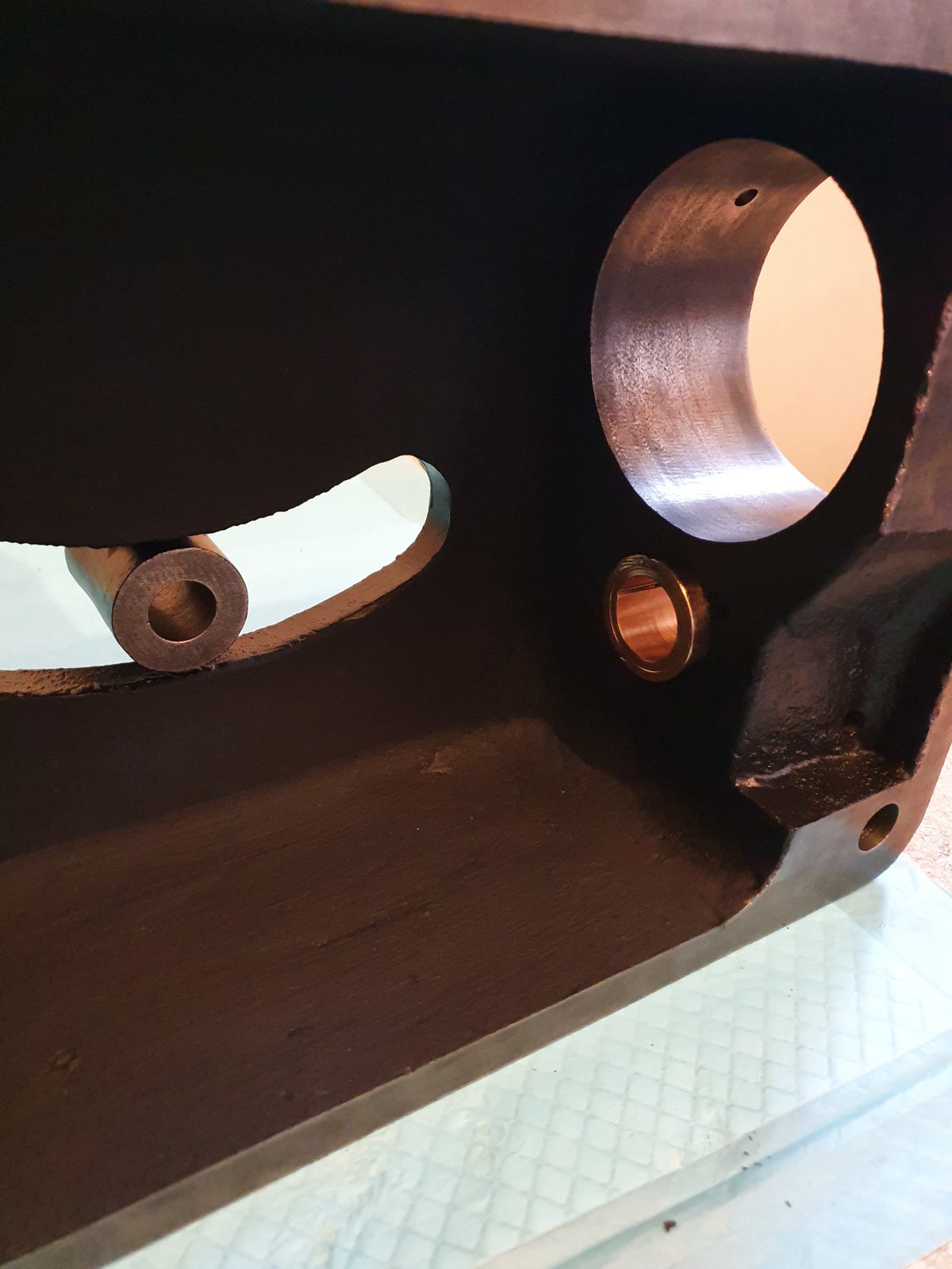

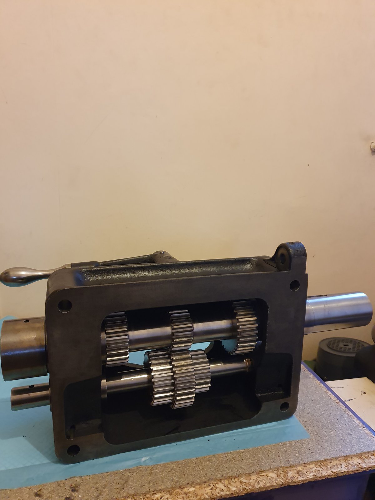

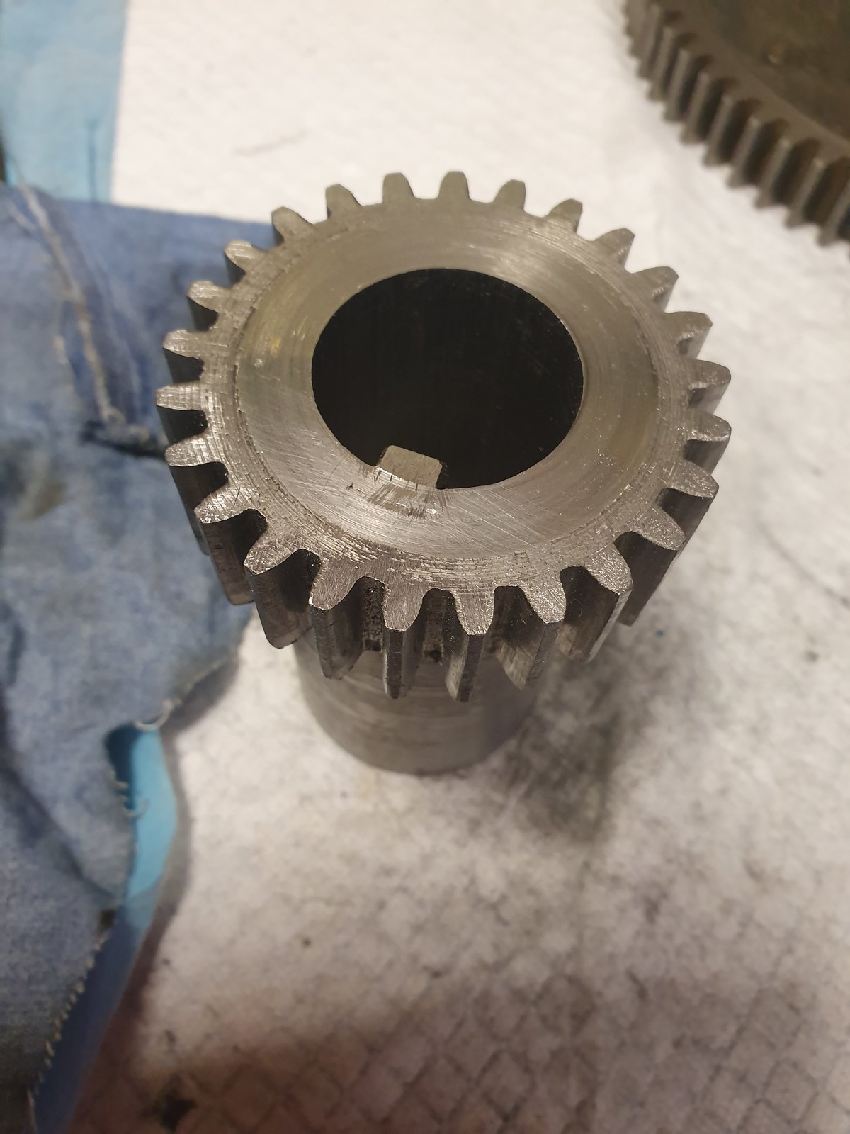

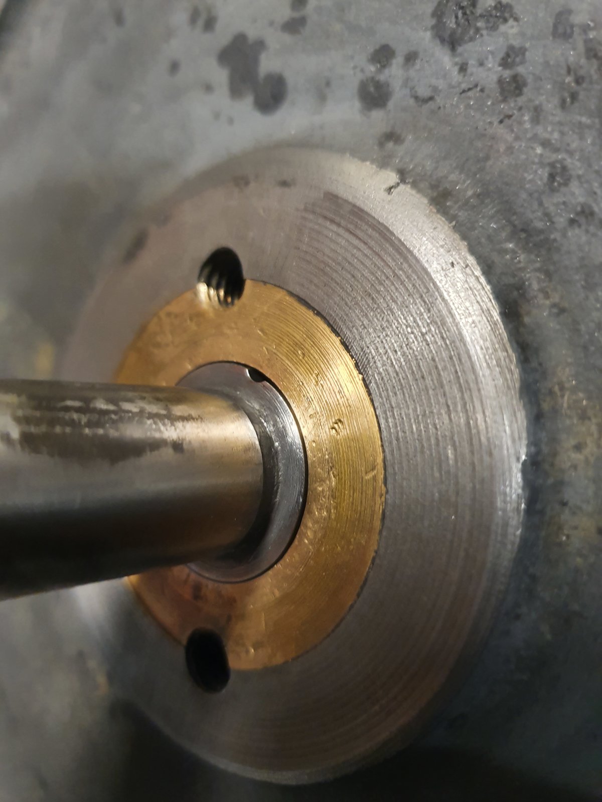

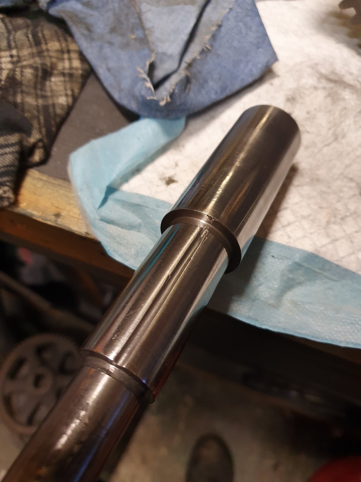

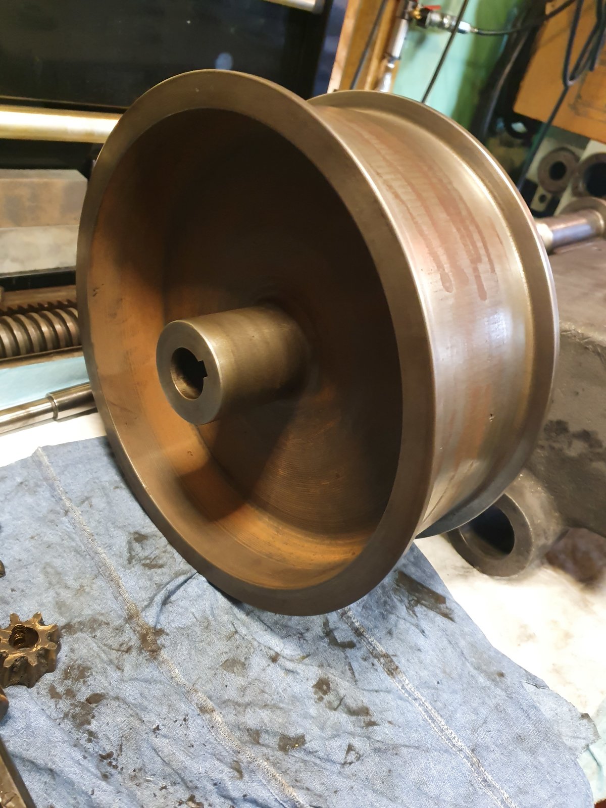

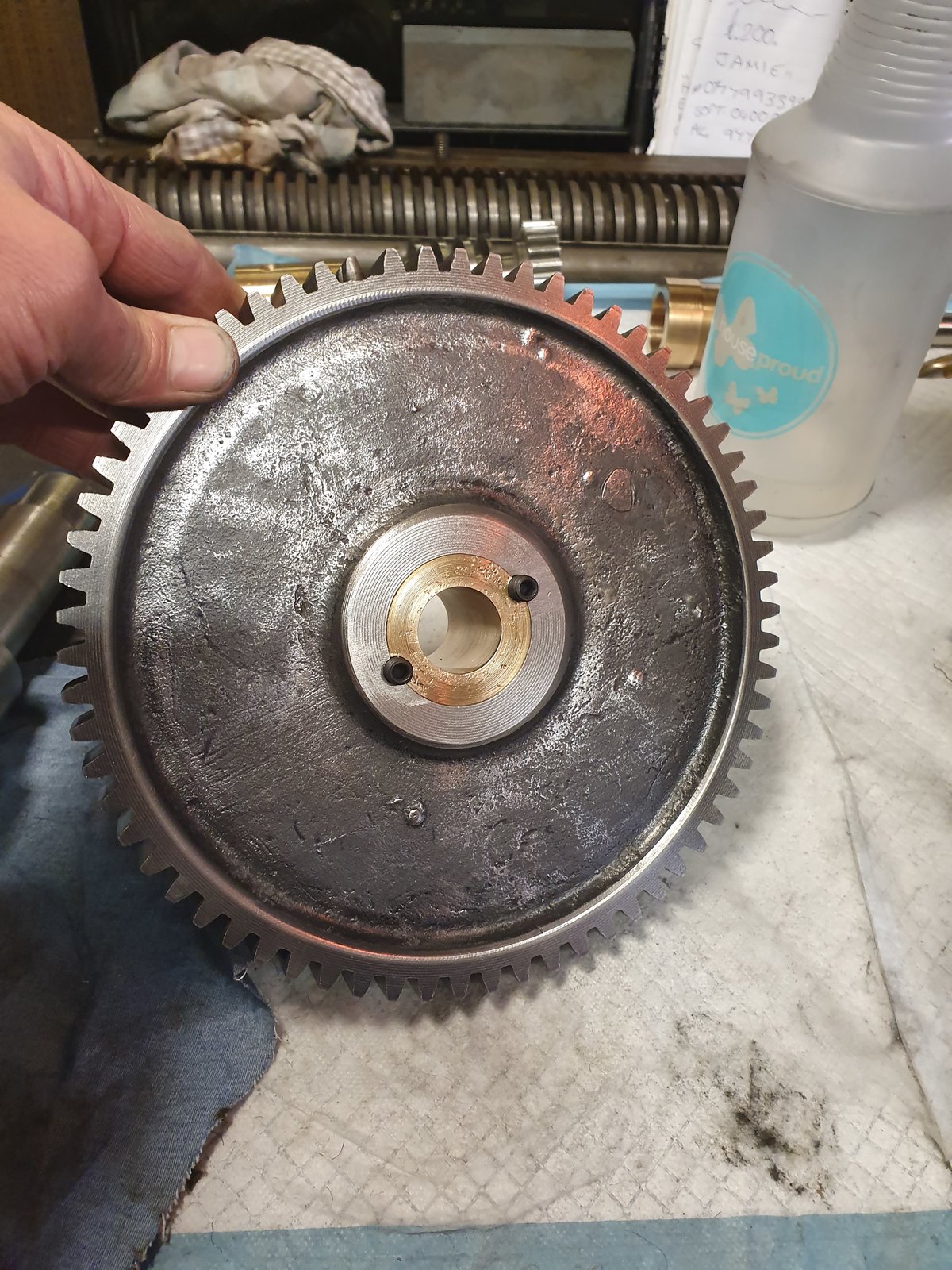

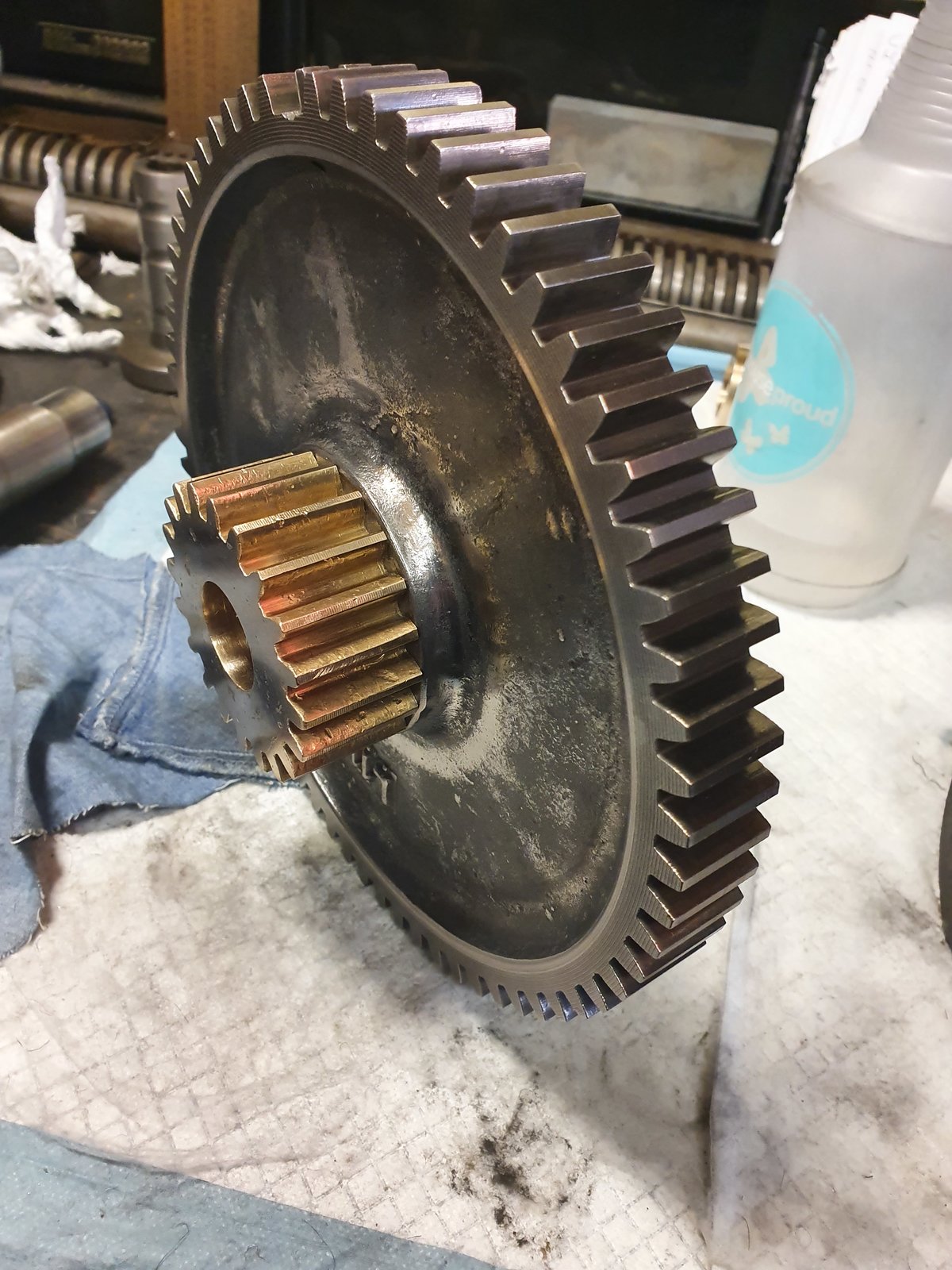

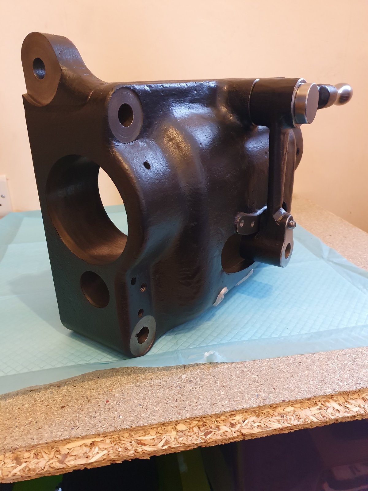

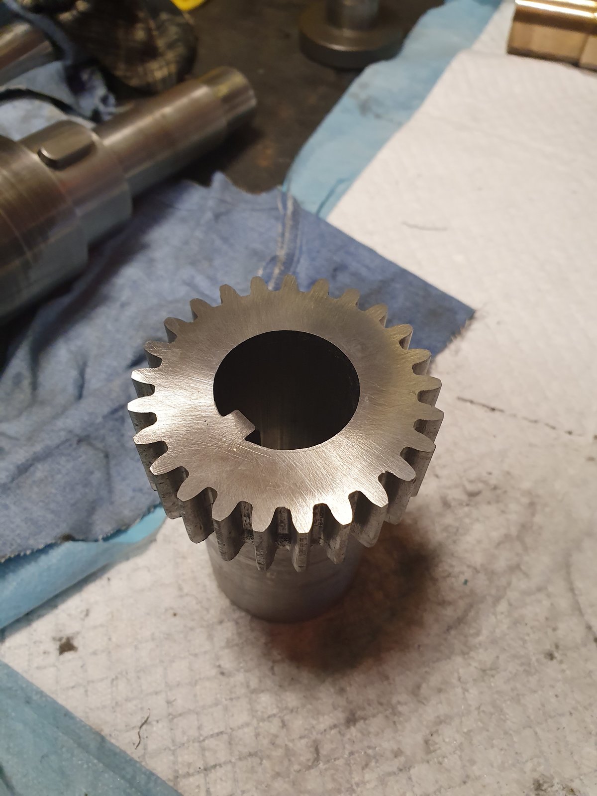

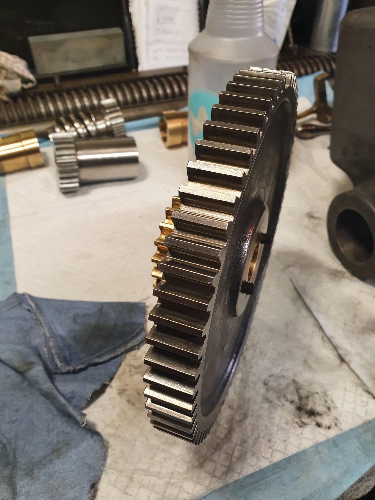

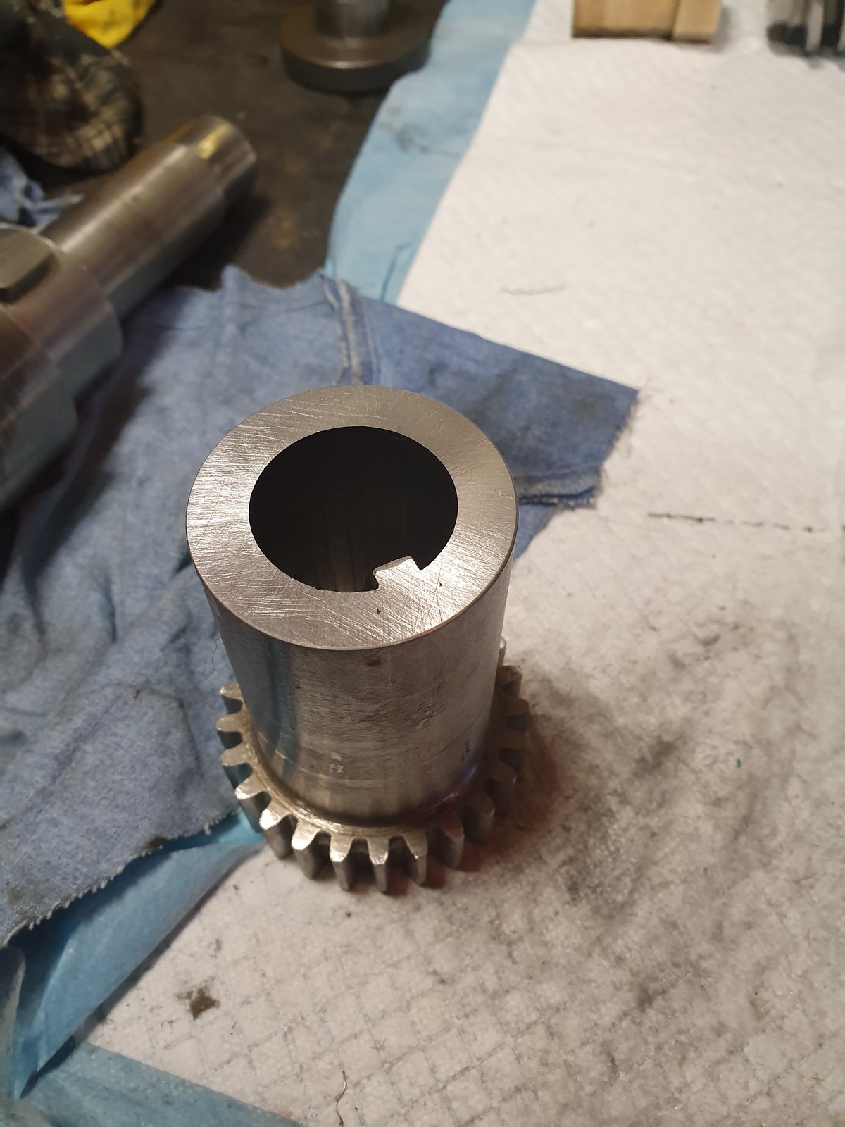

I know a lot of the posts regarding the Harrison are parts cleaning tasks. But there is a lot of small detail work that I dont show.
Micro polishing the insides of the bushes and deburr the oil ways. I polish those to. All the gears get dressed with a fine file. All those time consuming tasks really make a difference on the finished piece.

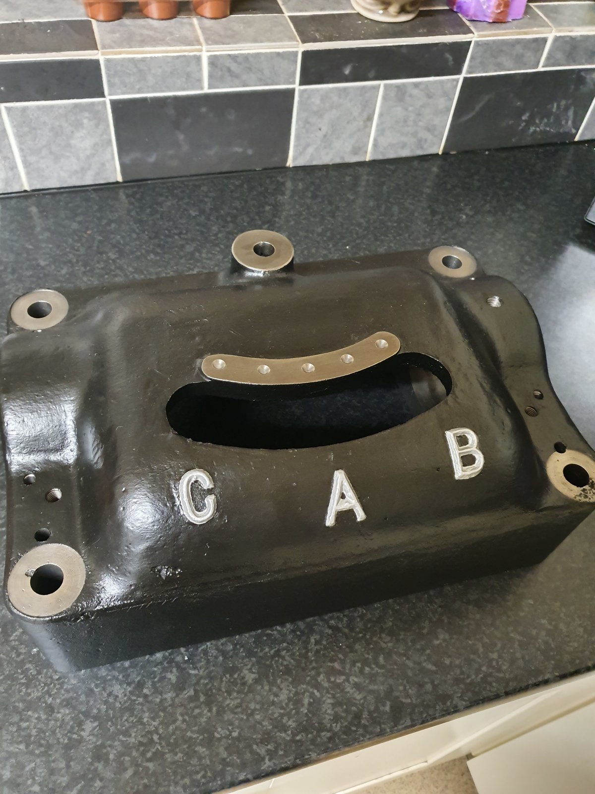

Paint is finished on the gear case.
Rebuild tomorrow View attachment 210162

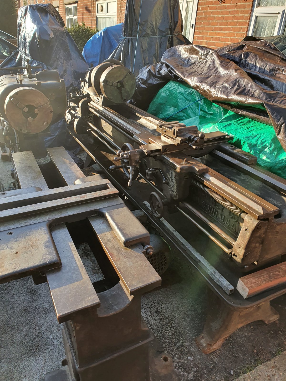

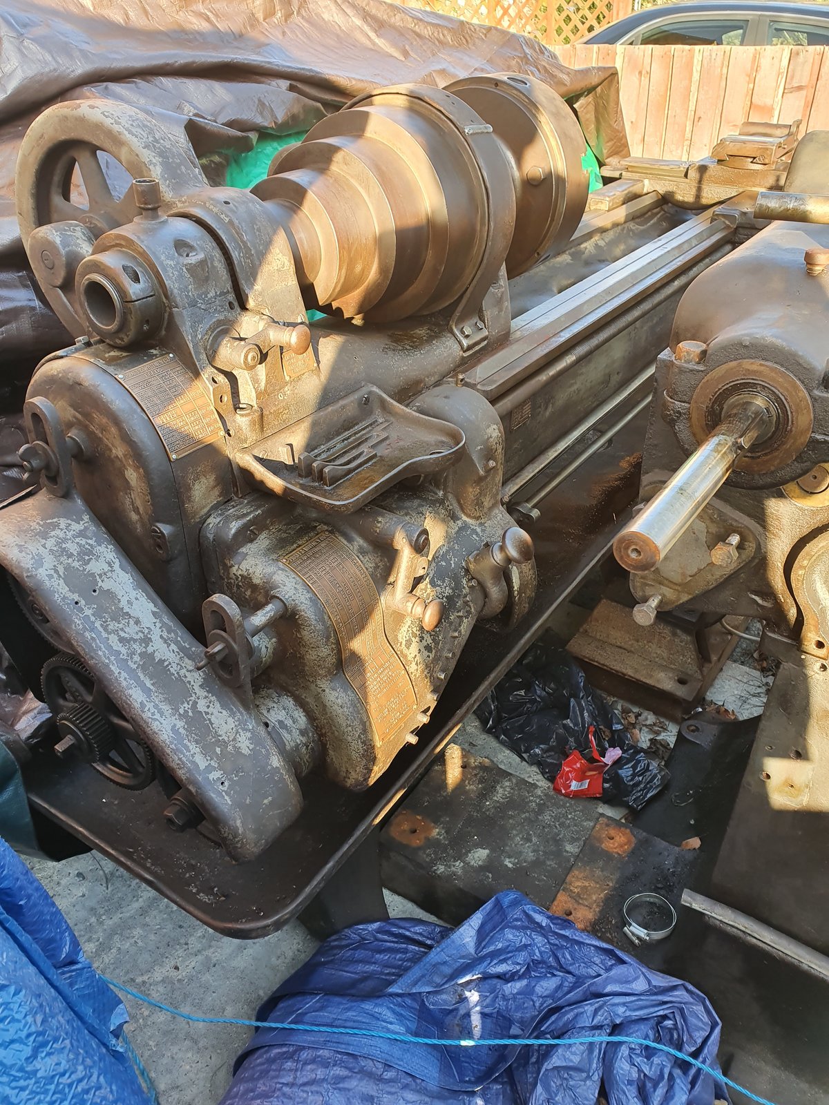

Indeed.By eck, my old Colchester is in for a shock![]()
All these plus some of my other stuff will go in my new workshop. Grounds I have done.View attachment 211444 Where are you going to put all those machines?
