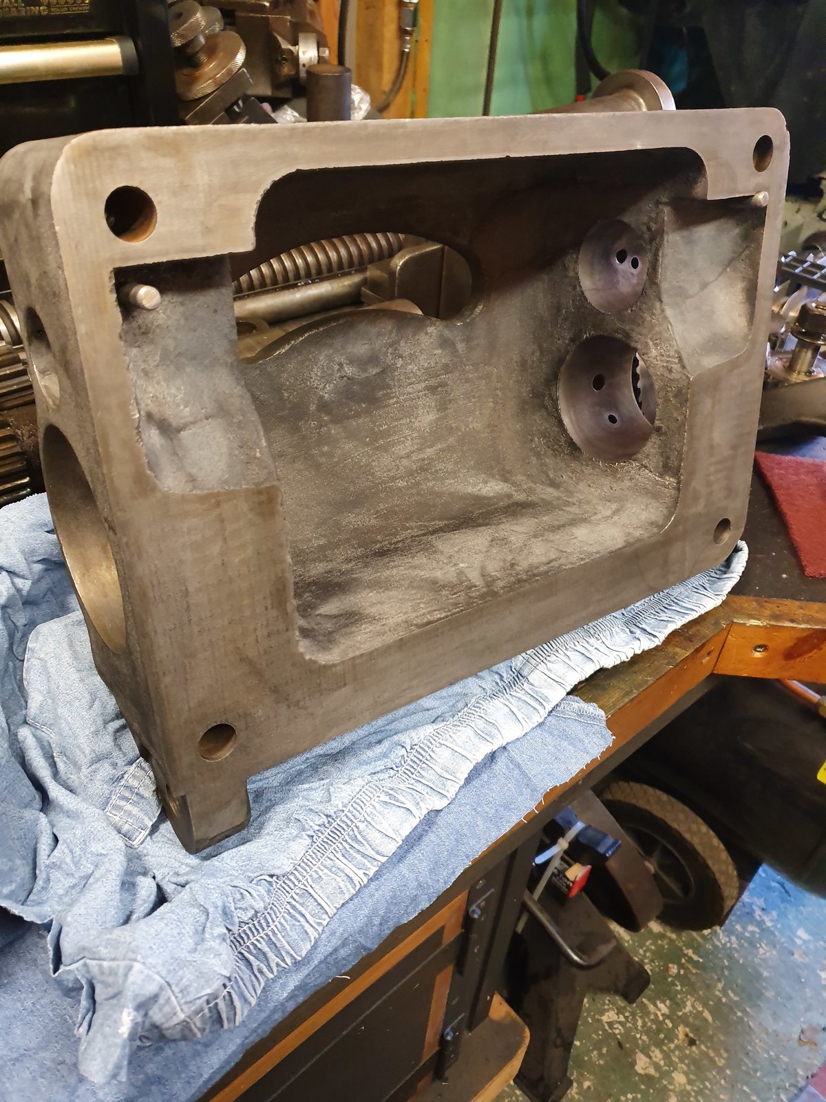

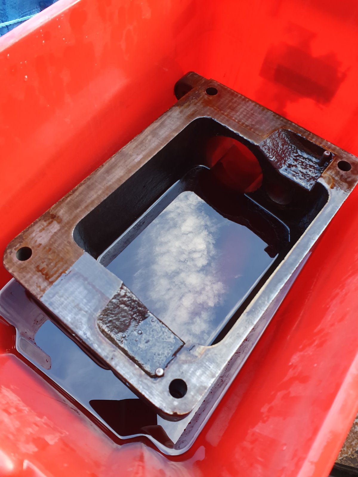

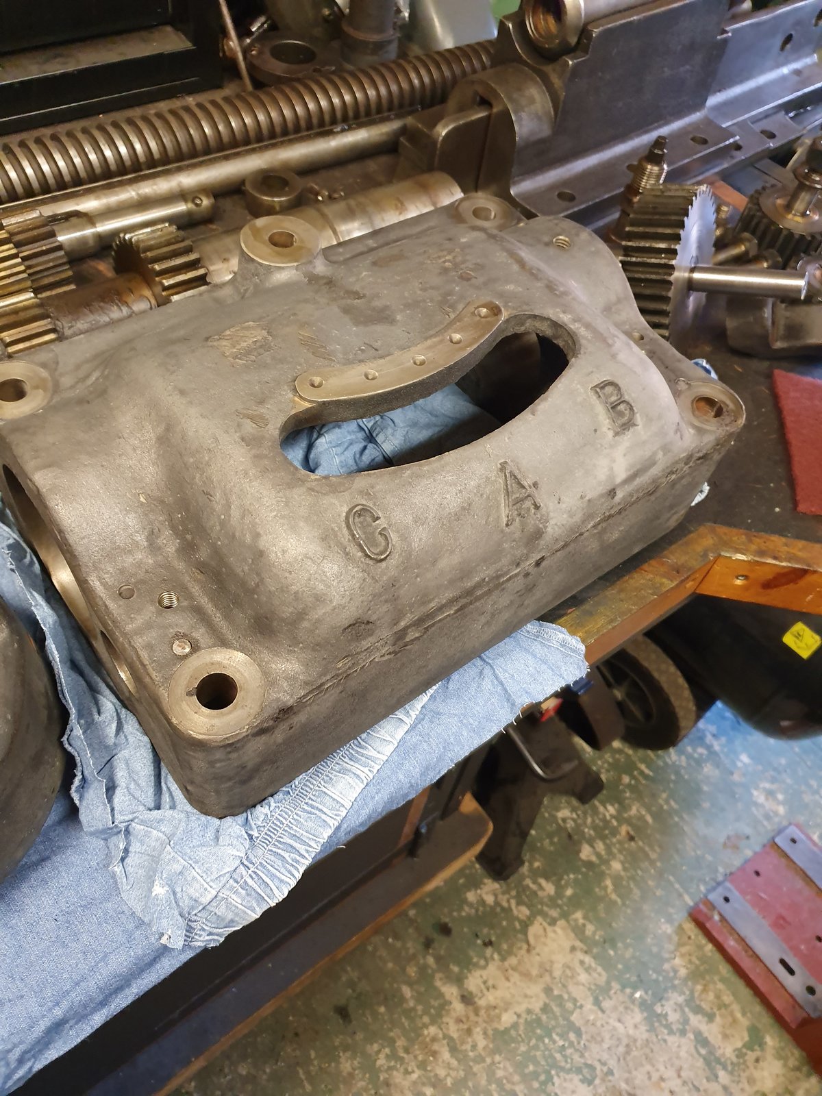

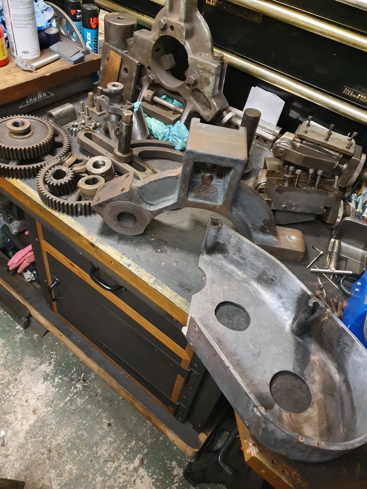

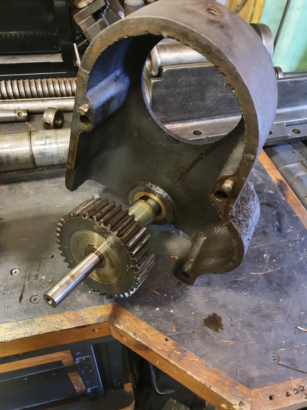

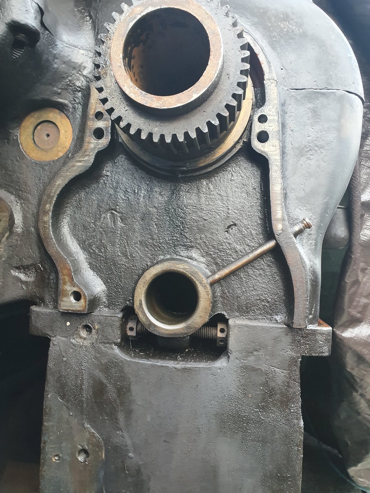

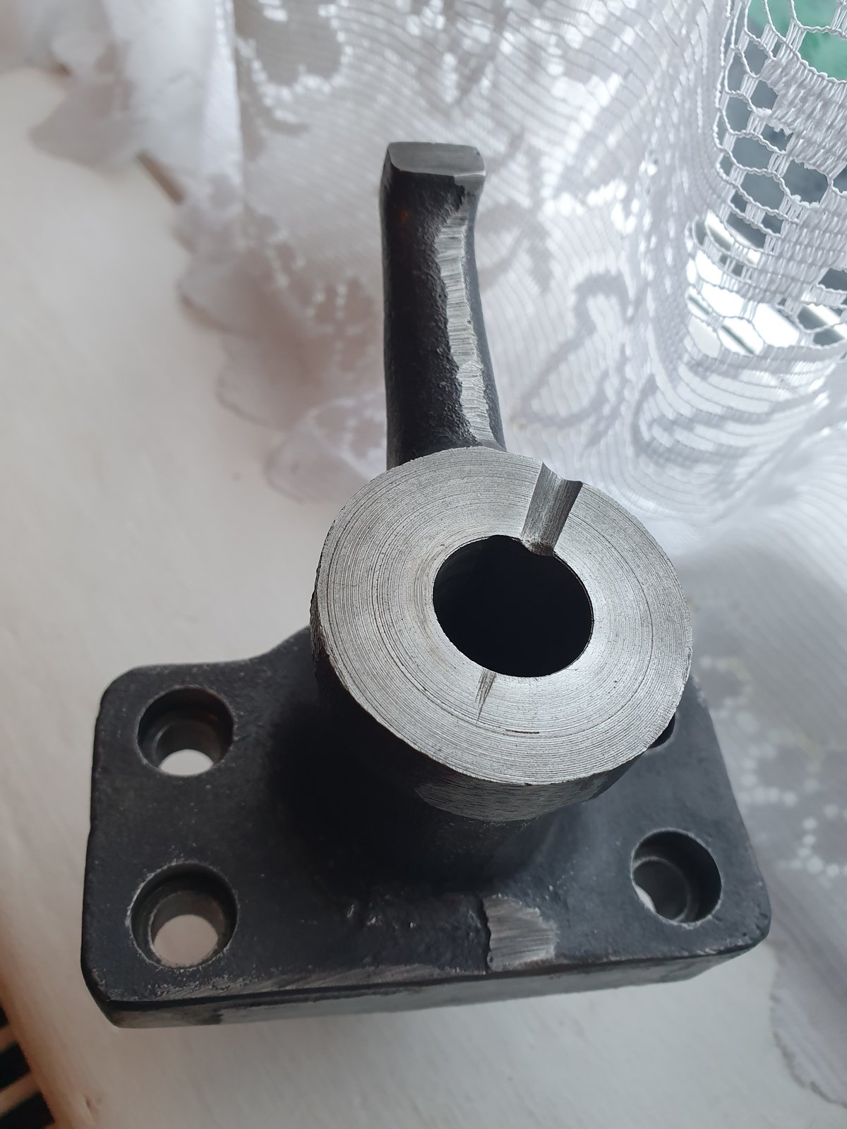

Thought I would make use of the earlier caustic mix and bung the top half of the steady in. Sorted . A bench full of stuff to sort.
Its better than I first thought. My plan is to tidy up inside. A bit of filler will be used as much as I hate the stuff. I can make it look nice .Looking at the photo's the repair doesn't look too bad at all, considering how many pieces it's been broken into!
It looks strong enough, from what I can see. Do you think it's up to the job? If it's just cosmetics and 'being right' that's bothering you would filler and paint be an option? I don't think it'd be hard to make it look as good as new?

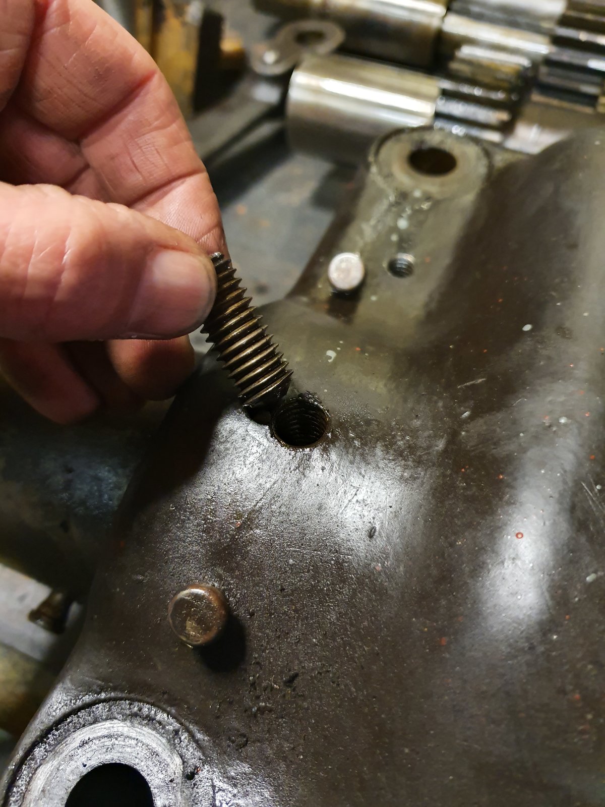

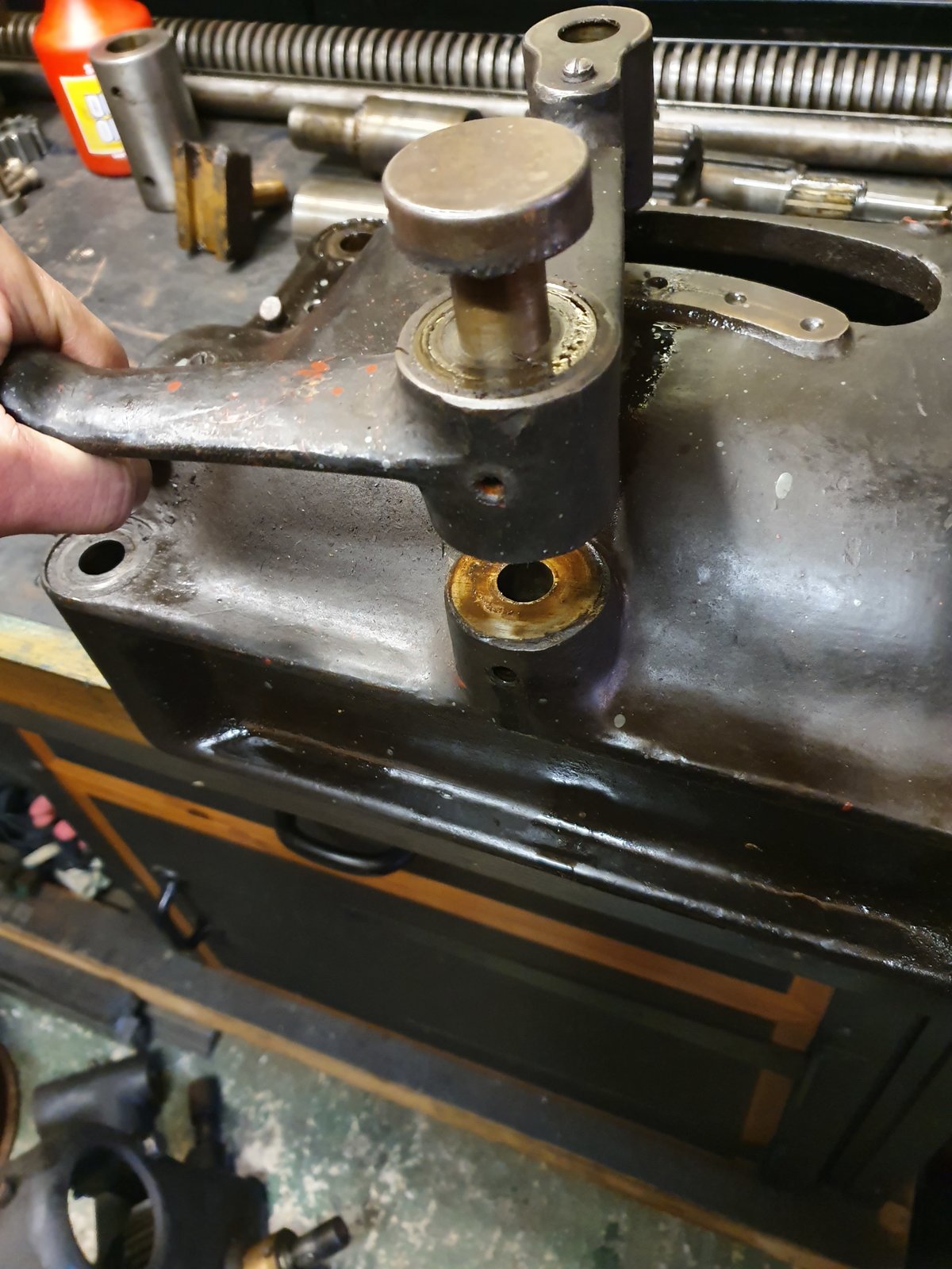

Yes. There is another one the other end.Nice shot of the headstock alignment jacking screws![]()
It will be again as the headstock will be coming off soon.Look at how coarse the threads are, must of been a mere to aline

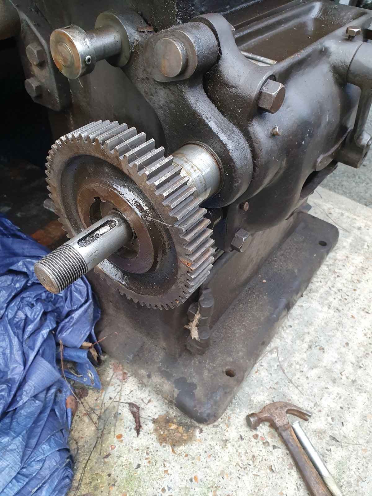

It will be fine. Old design. Big. Heavy. Basic l9lHeathen.
The 11th commandment: thou shalt not disturb the relationship between a Harrison lathe bed and headstock.
